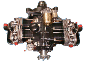

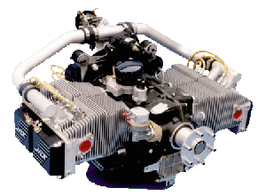

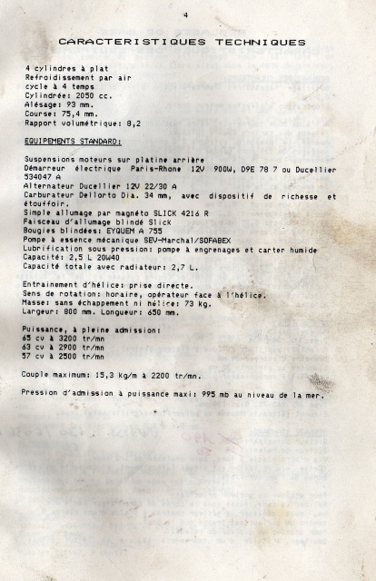

OP's link http://www.ultraligero.net/Descargas/Manuales/JPX/4t60.htm
(IMG:http://www.914world.com/bbs2/uploads_offsite/www.ultraligero.net-26-1530222808.1.gif)
(IMG:http://www.914world.com/bbs2/uploads_offsite/www.ultraligero.net-26-1530222854.1.gif)
