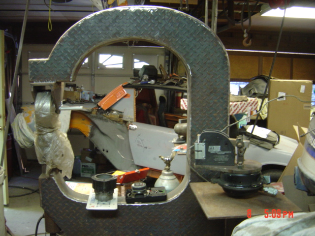

I was thinking about Johns e-wheel setup on the way to work, I think it would be pretty easy to make a really portable unit with some minor tweeks to Johns unique design. The most obvious would be to bolt it together so it could be broke down and transported or stored away easily.

The "worm drive" you refer to is typically nothing more than a length of Acme thread. I used a piece from a house jack for my wheel. House jack is approx. $15.00 at Lowes

Ok, just did a little research... Heres what I found.. (based on the websites that John presented us with!)
http://metalcrafttools.com/Benchengwheel.html
I think will give us the best deal on all the junk together...
"Industrial Strength" Bench-Model
English Wheel "Kit" consists of:
Upper Yoke $35.00
Lower Yoke $60.00
Upper wheel & axle $95.00
Tube Shaft Assy/w kick wheel $60.00
4 Lower anvils w/bearings & axles $300.00
TOTAL $550.00*
S&H additional
This includes plans to construct the frame,
but does not include any frame material. "
This would give us a huge start and basically will get rid of all the hard parts. 550 seems to be a very good price for all those items, but maybe someone contacting the buisness asking for a group buy? I dont know if we could get more than 5 people interested though.
Metal stock would be another $100.... at least.
What do you guys think?

Just a couple of thoughts..the link above for the benchtop wheel goes to a great company that has been around for a long time. Another is: www.imperialwheelingmachines.com check out the parts he sells for do-it-yourselfers including parts to adjust the pressure between the wheels.
I like a 3" wide upper and lower wheels unless you are making small parts, then 2" wide is fine. The rectangular frame I brought to the workshop is the easiest english wheel frame to make. If I made another that was meant to be non-portable, I would make it it taller for more clearance inside the frame, and make the cradles turn 90 degrees for smoothing unusual panels without clearance problems. To save money, I would suggest getting fewer of the best quality lower anvil wheels you can get. One or two of the lowest crown wheels can do a lot of great smoothing, or you could skip over the number two...get a #1 and a #3 for a little more flexibilty. The best lower anvils have a flat spot in the middle with the sides sloping away for clearance and support of the panel...wider flats for the lower crown wheels and thinner as they get a higher crown in them.

so I was thinking...if one wanted to make a homebuilt unit and not worry too much about the life of the upper wheel, a /4 front brake hub could be used if one removed the rotor section, just polish it up nice....at least one bottom anvil could be made from a used rear wheel bearing (IMG:http://www.914world.com/bbs2/html/emoticons/welder.gif) (IMG:http://www.914world.com/bbs2/html/emoticons/smash.gif) (IMG:http://www.914world.com/bbs2/html/emoticons/screwy.gif)
