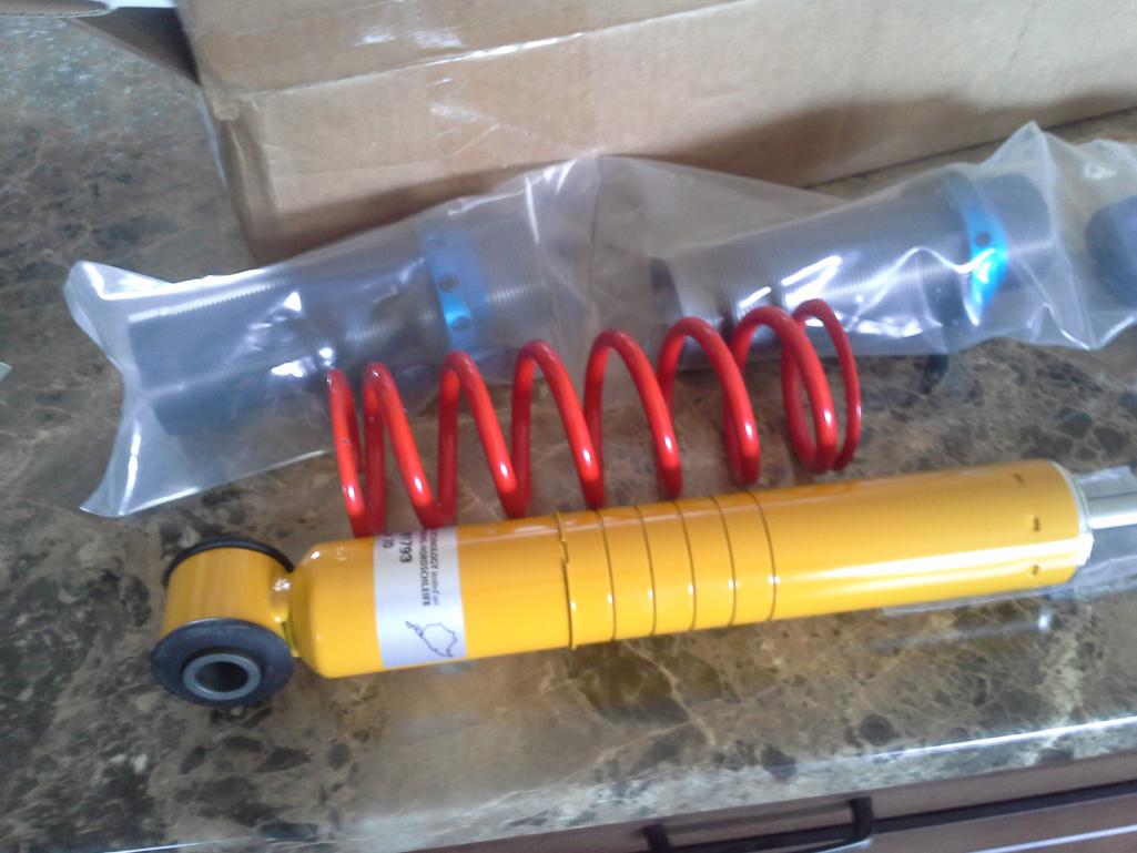

Bit the bullet and ordered a set of coilovers and new bilstiens (auto Atlanta) I hope 140 lb springs isn't overkill!

Parts are in, fast shipping!
Anyone have a recommendation on which groove to use to put it together? Rigs are in the bottom groove out of the box. I don't think the back of the car is much heavier than stock. Kit came with 150 lb springs...

Can't answer the question, I run these with coil over sleeves. I noticed the track outline for the ring. Is this like a rubicon Jeep, and now your car will be Nordschleife certified.

Trial and error... Springs are stiff. I'll start with the bottom groove and
see what happens.

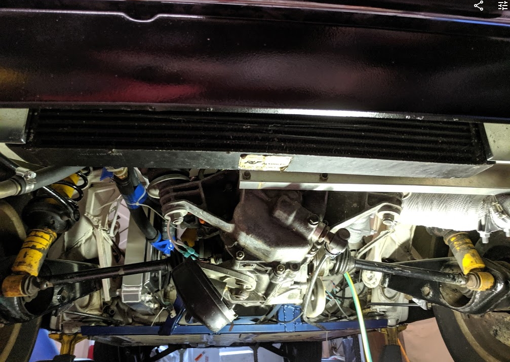

No issues with the mount. Cooling is borderline... still prototyping ducting around the rad. Because the engine compartment is now open at the bottom I'm pretty sure the airflow is now bottom up. Had to run with the engine lid open to get to Mosport and back. Now running with the lid closed after fencing off the rad to make sure air coming out of the hot side of the rad can't circulate back to the cold side and that air from under the car can't blow past the front of the rad and has to go through. Going t build it better this winter and open up the lid like a GT hood.
There is vibration at idle... I think mostly because the trans mounts are pretty much solid smooths right out past a out 1800 rpm.

I am using 911 mounts across the bar and have little room for the trans mount to move. Don't know if it would help but I added a second radiator across the back where the muffler used to be. It is plumbed to the heater core outlets on the engine.
Been considering doing exactly that. And/or a heater core where it belongs too. Be nice to have some defogging ability on cold mornings! Don't know how good the airflow would be at the back of mine with the ford probe bumper

I have those Bilisteins too, but not the coil overs, but have thought about getting them. on the question about where to set your retaining ring, at least with a stock spring and set up I have found that the top #1 slot is too bouncy, and that in my case #2 or #3 will be best, I am at the #3 from top now and am going to move it up to #2. At #3 I am a bit lower in rear than front than I want to be, and this is easier than having to crank the front down and re do alignment up there. will see how that feels in the seat .

I would do the clip on the bottom ring, that is what I did with my Koni's and the threaded perches.

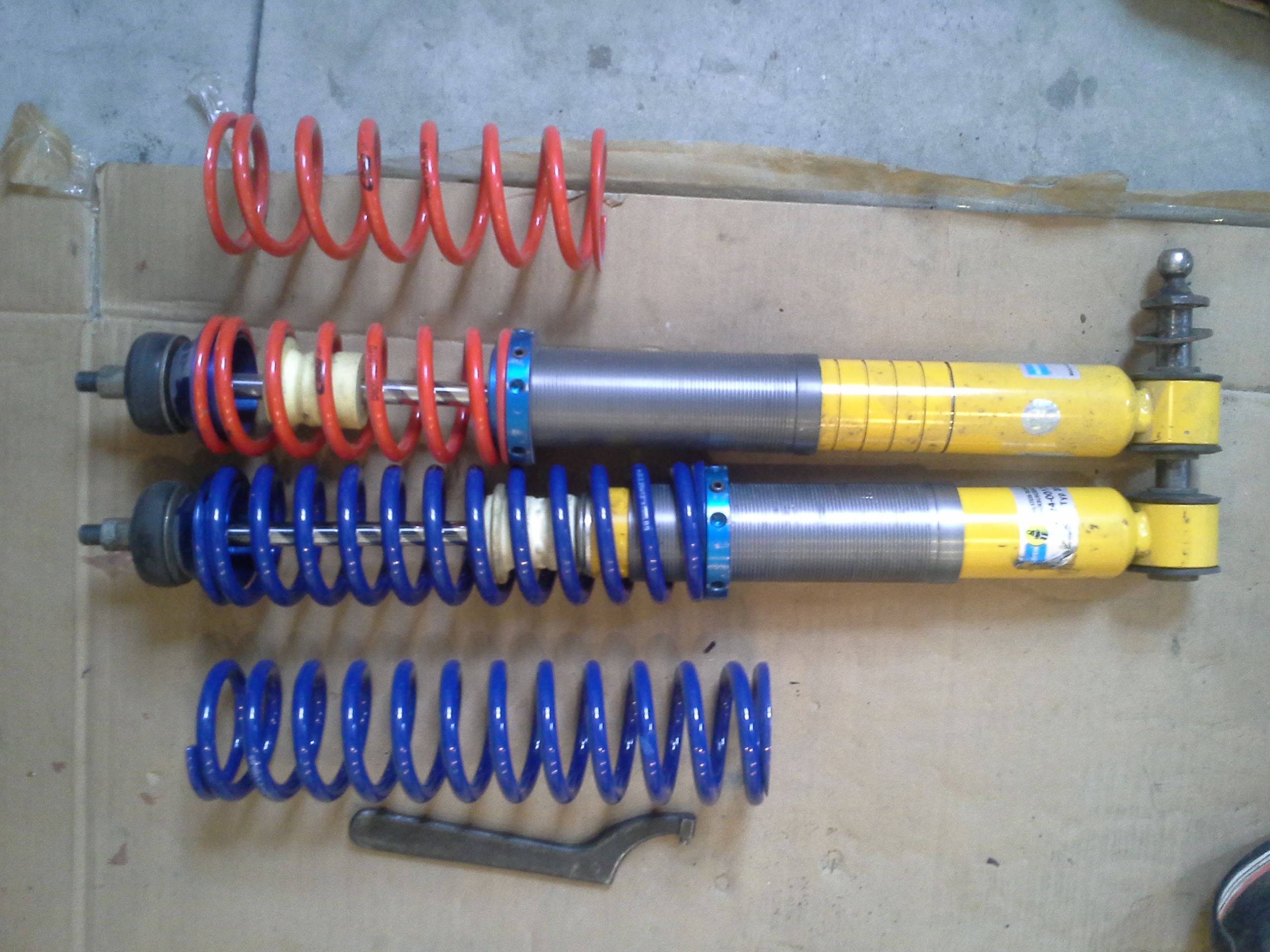

Wound up with everything set as high as I could get it to get ride height. Ordering a set of 12" springs to put things where they should be. Not available from Eibach in that diameter. Only place I could find them in 2.25 id over 8 " long were some companies in England. Gambled on one called "Rallynuts". We'll see what happens, just placed the order today. Seems there may or may not be deflection issues with springs in that diameter over 8 " long according to Eibach. We'll see how I make out. I'll post some pictures when I ge tth enew springs on the shocks. Don't expect delivery to be fast when I'm dealing with transatlantic distance!

Click on the "How-to" thread on coil overs in my signature. Parts are cheap and you have almost unlimited flexibility in spring selection.

thanks, but what I have ordered eliminates the need for the helper spring, I'll post pictures when I get the parts in and put together.

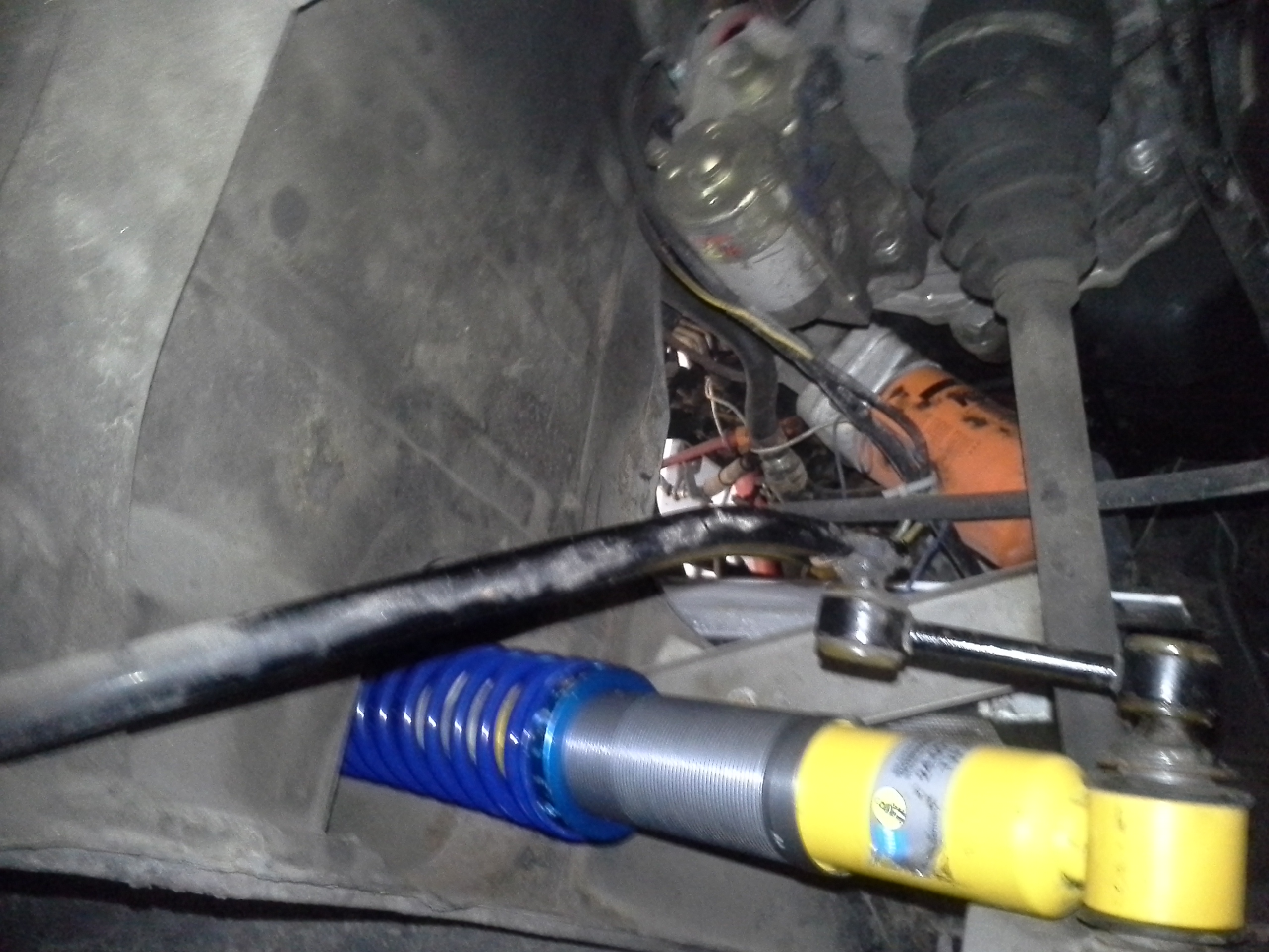

New springs in. (Rainy day here)
Before w/150 lb 8" EibachAttached Image

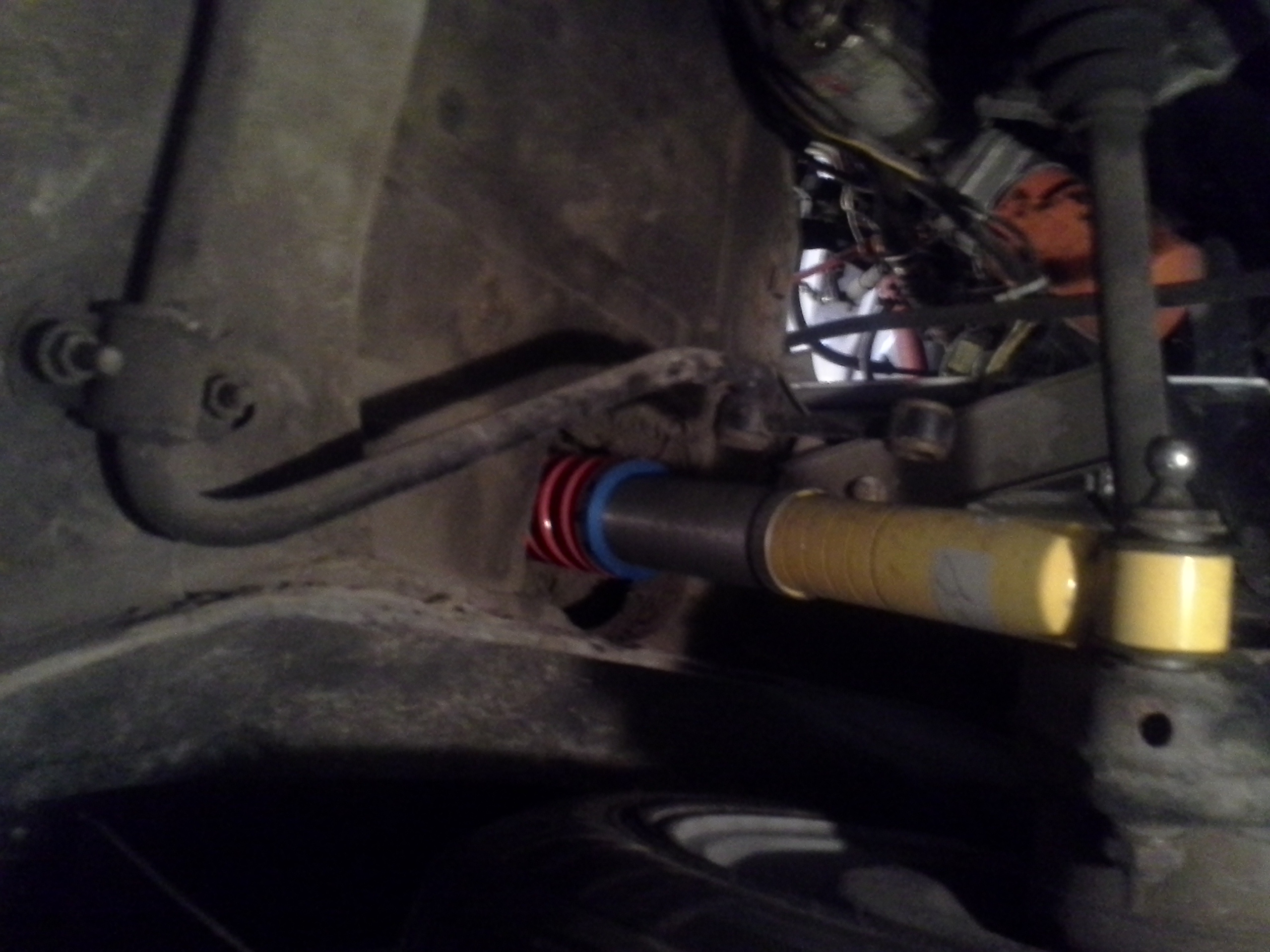

Notice that the sleeve extends above the top of the shock with the 8" spring. Not good practice as far as I'm concerned. On my car at least I wound say a 10" spring is the minimum. Not available anywhere I could find on this continent in that ID. Bought them online from England form Rallyuts.com. 160 lb 12" available just about any length and 10 lb increments.Attached Image
After Attached Image
