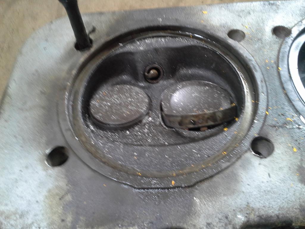

Been planning this for a while, but it was supposed to be a winter project. Wasn't quite ready yet. KEP adaptor parts have been sitting here. Timeline moved up because of a failure.
Had a chirp that turned into a BAD miss, valve seat issue on one cylinder.Attached Image

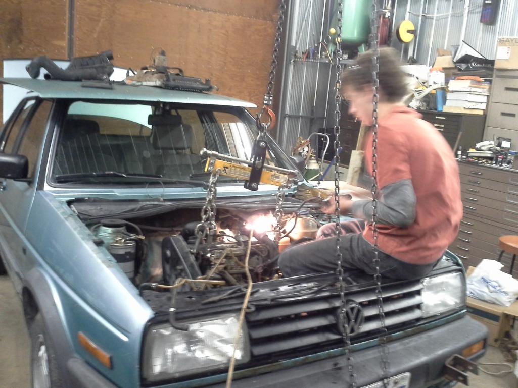

Had a fresh 1.9 AAZ diesel sitting in my storage trailer that had never been fired. (honed, rings, bearings, injection pump reseal). "new" engine was destined for my daily beater . Same engine in the beater is getting a little tired, I've put at least 350,000 km on it and the compression is getting down. Still runs okay though. Swapped the "new" engine into the beater. 16 year old son is learning...Attached Image

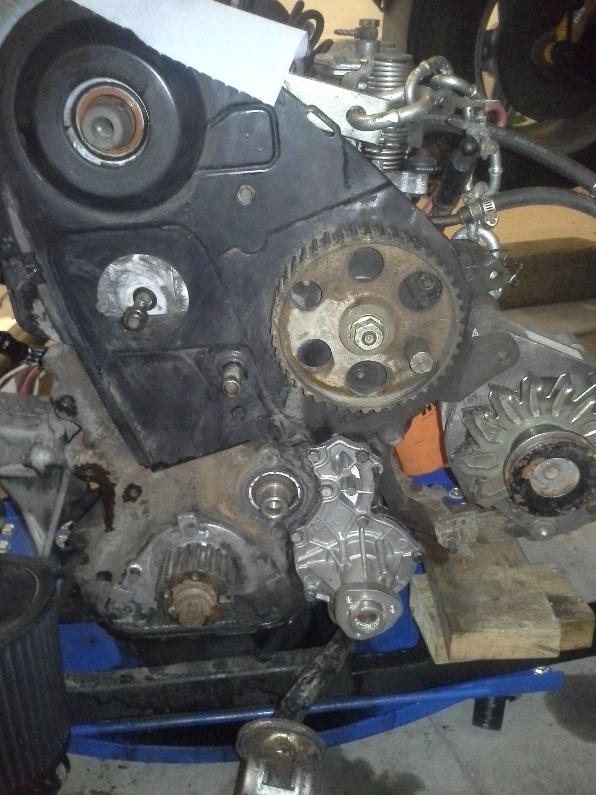

PatrickB   How critical is it to have the crankshaft of the e...   Jul 17 2018, 03:58 AM
914forme   To answer your question if it was just the engine,...   Jul 17 2018, 06:34 AM
PatrickB   To answer your question if it was just the engine...   Jul 17 2018, 03:35 PM

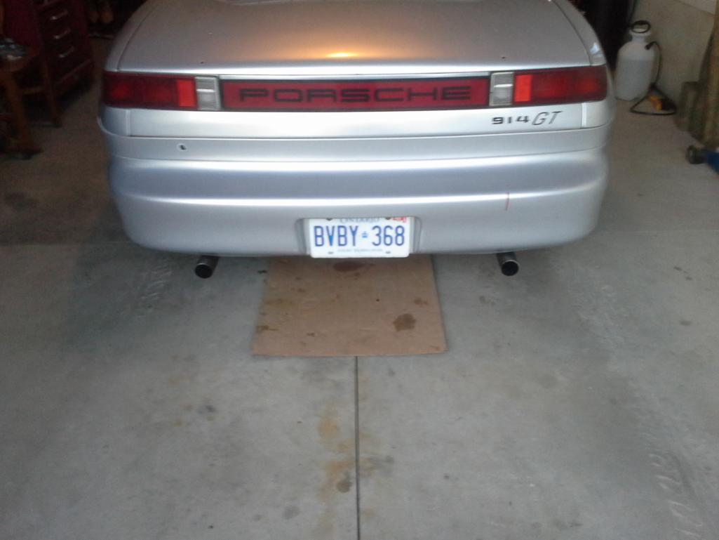

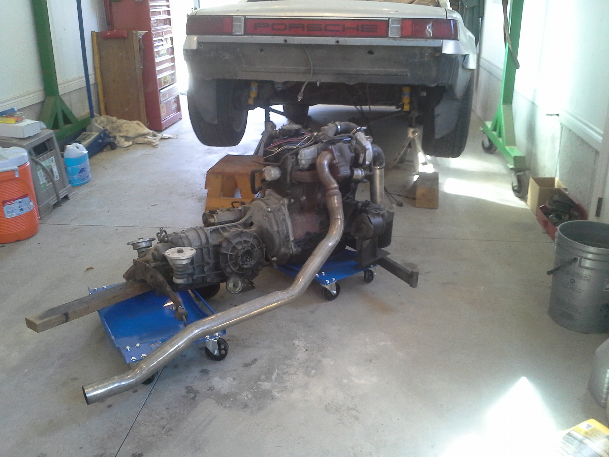

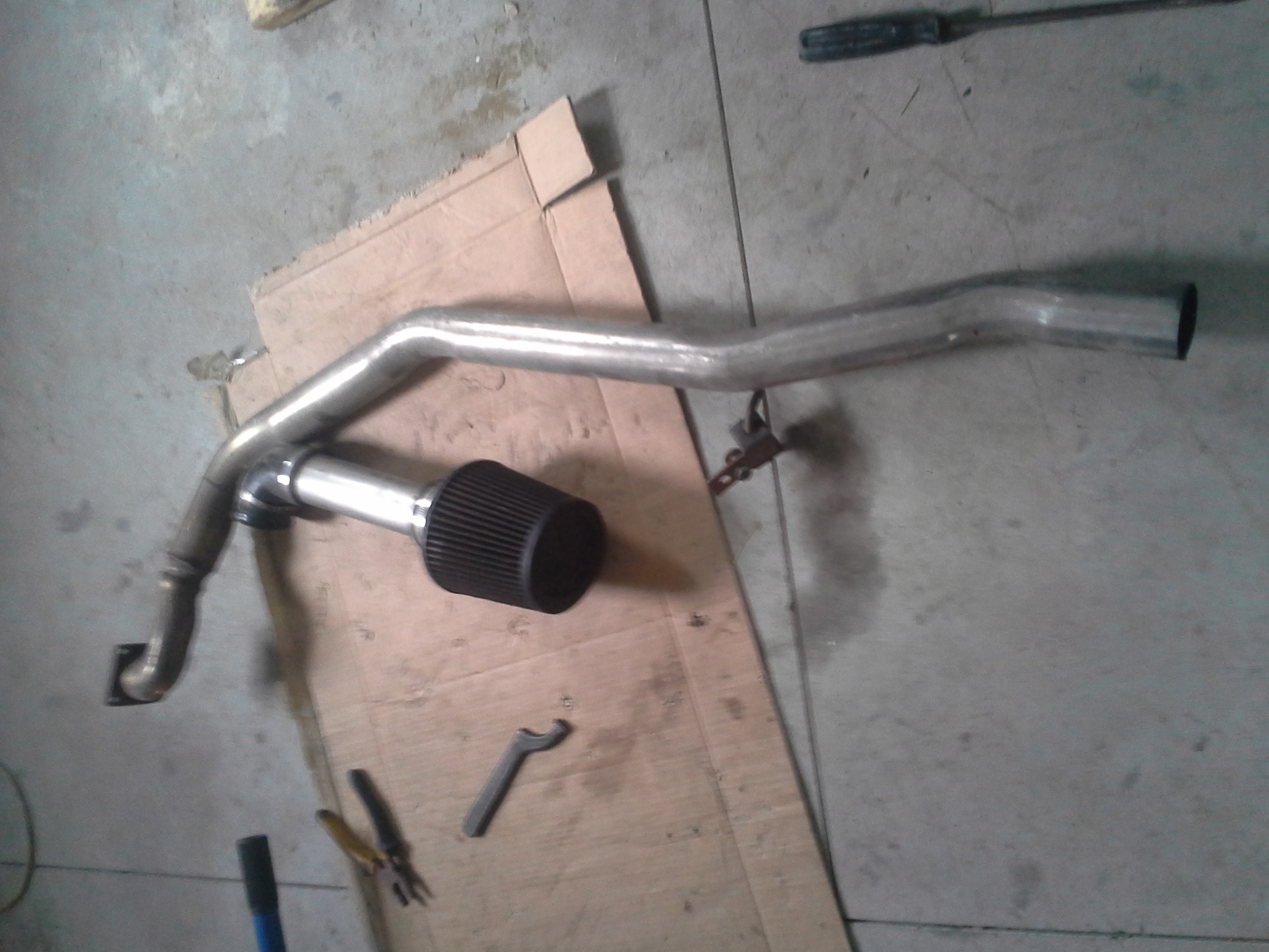

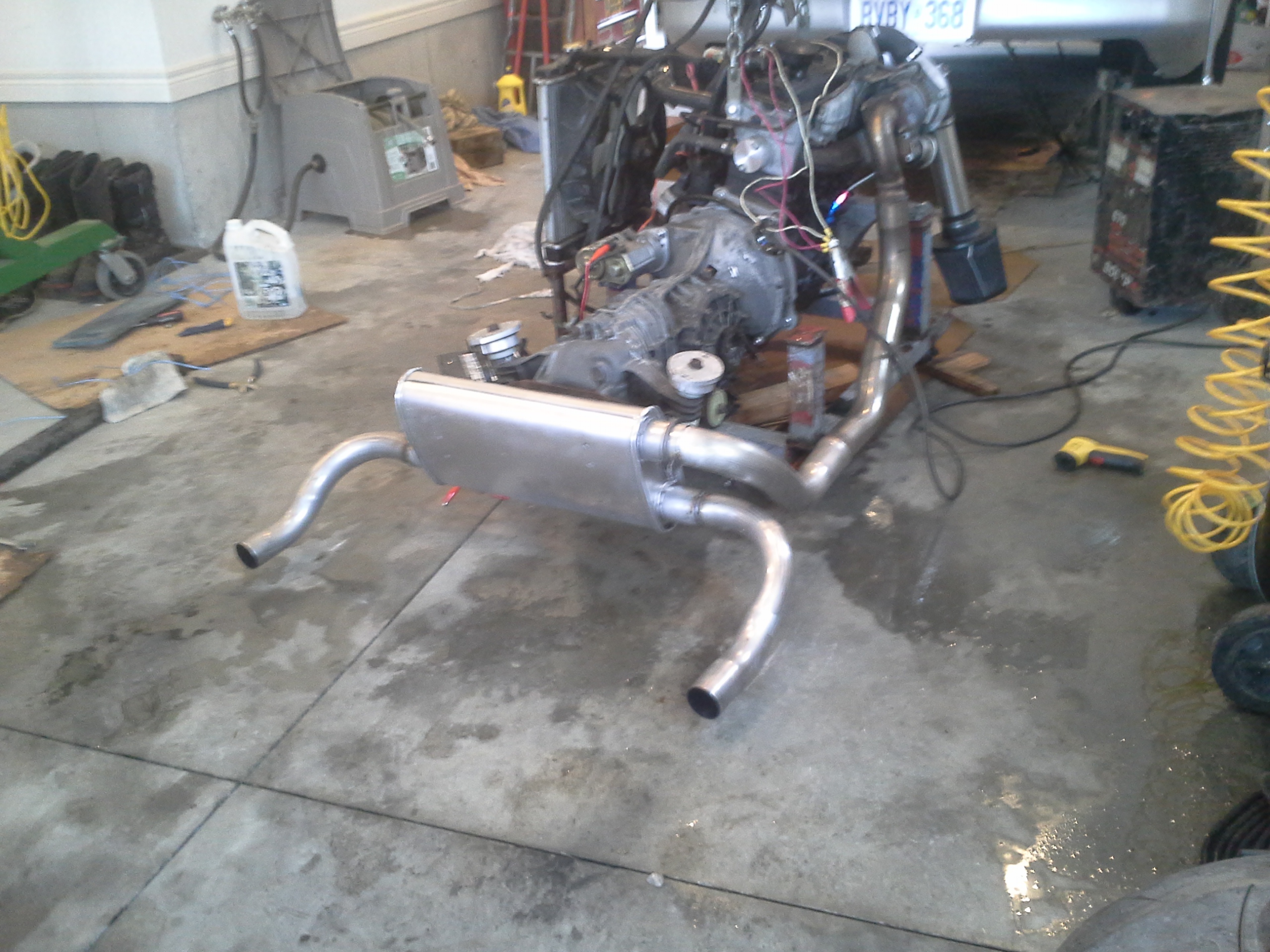

PatrickB   Rad in, custom water outlet from back of head fo...   Sep 2 2018, 08:11 AM
tomeric914   The exhaust is straight up just until I get to t...   Sep 2 2018, 01:38 PM
914forme   The exhaust is straight up just until I get to ...   Sep 2 2018, 03:41 PM
PatrickB   [quote name='tomeric914' post='2644848' date='Sep...   Sep 2 2018, 06:54 PM
