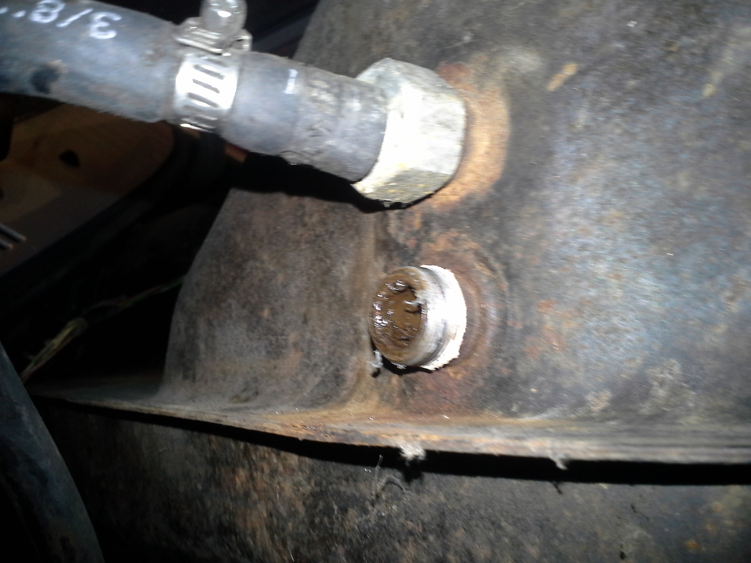

Hooking fuel lines. No return line with previous carbureted 2 litre.
removed electric pump under the tank, direct connect from tank to the line to the back of the car.

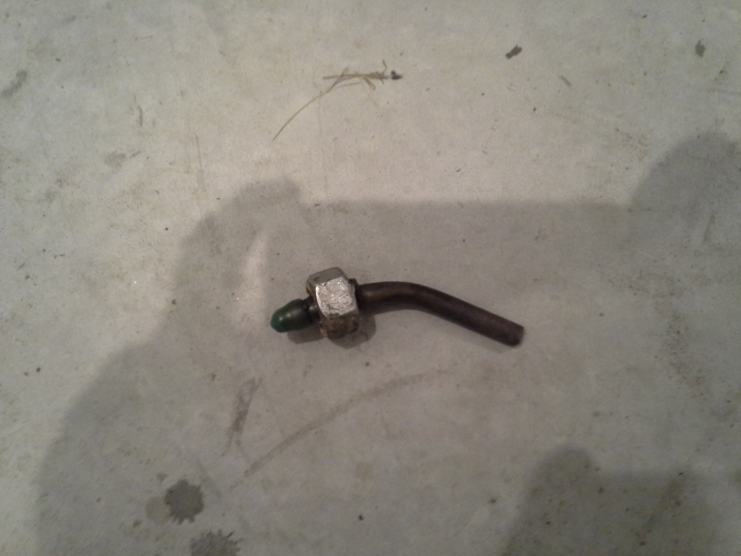

Went to hook the return line to the other nipple on the bottom of the tank... plugged off.
Screwed it out of the tank. I don't think the return on the diesel should go into the bottom, it should probably dump in the top of the tank. I think I'll need to make a new return with a pipe all the way to the top of the tank. Anyone know what size rubbers I need to put this back together? Or is this even stock on these tanks? First time I've had the tank out.Attached Image Attached Image

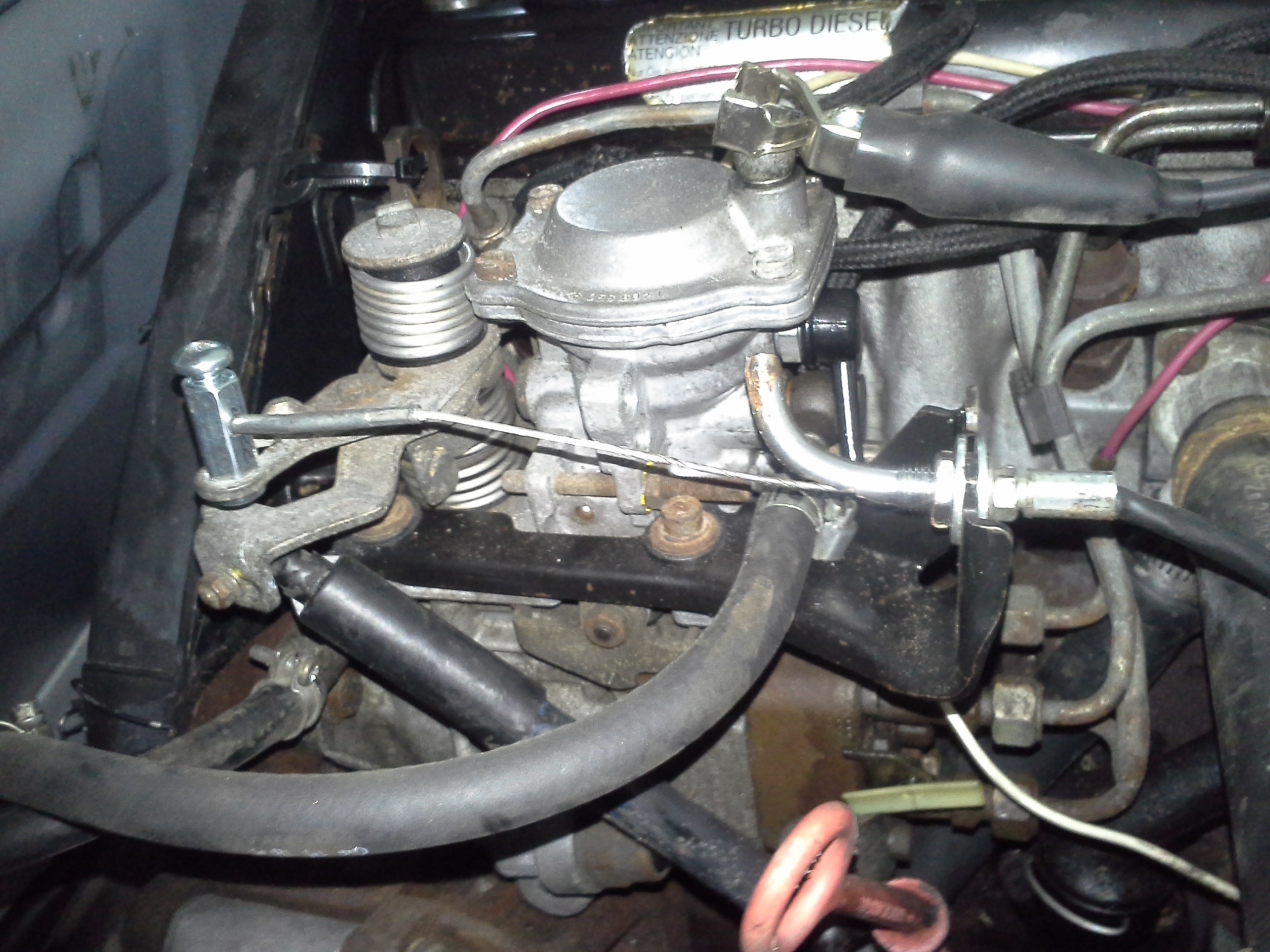

Had it fired up today but the injection pump ran out of fuel before the system filled. Done for today. Need to get the wheels back on, set it on the ground, fill the tank to the top with diesel and bleed the system.
I have a throttle cable issue... I'd like to have a cable about a foot longer with about an inch more sticking out of the housing. It's hooked but only just. And it's starting to fray... Anyone this side of the border know a good source for cables? And is there a stock cable for something else that fits my wants?? Or am I looking at a custom cable?
The other option is to blacksmith my cable mounting point and/or use the end of the Jetta cable hooked to the Porsche cable.... messy.Attached Image

Terrycable will make you one. I had one made a foot longer than stock. Just give them a call and tell them what you want. I think it's (800) 854-4691.

For the throttle, perhaps you could take inspiration from the 911 and 914-6, and fabricate a bellcrank linkage? You ought to be able to find a good place for the bellcrank, then a few rods and rod ends, and you can use the stock cable to run that...

1)HAVE to do the throttle cable, it's turned so tight it's binding up. Added a return spring so it is drivable but not a permanent solution. Found a local supplier but I'm assuming I need exact measurements for him.... I can easily figure out how much to add but might need to pull the old cable for measurements... unless someone can tell me stock length of the housing and stock length of the cable? Thread size on the pedal end?

Thanks! I'm happy with the progress so far. More work to do yet though. Dropped the throttle cable off tonight at a custom place not far away... hoping they can make me a new one about a foot longer with a different end at the engine end of the cable. Picked up an adaptor to hook the diesel's alternator up to run the factory tach, should help with autocrossing. I know the engine pretty well from putting a lot of miles on it in another car, but it sounds different in this car and with a different turbo. Guessing too much at rpms.

Should update this thread. Got the throttle cable, works like acharm. Did a few more autocross events last fall. Parked this year so far. trying to get ready for the big event at Mosport... we'll see.
