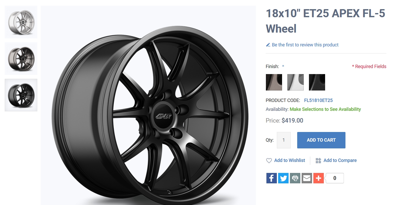

https://www.apexraceparts.com/wheels/fl-5-w...fl-5-wheel.html
https://www.augmentwheels.com/

I love those wheels! They are the right look. deep dish, choice of finish, and best of all not 1000+ each...
But.....
They are for BMW.
Why can't they make the exact wheel in 5x130....
Still, I'm going to call them...
Thanks for the find

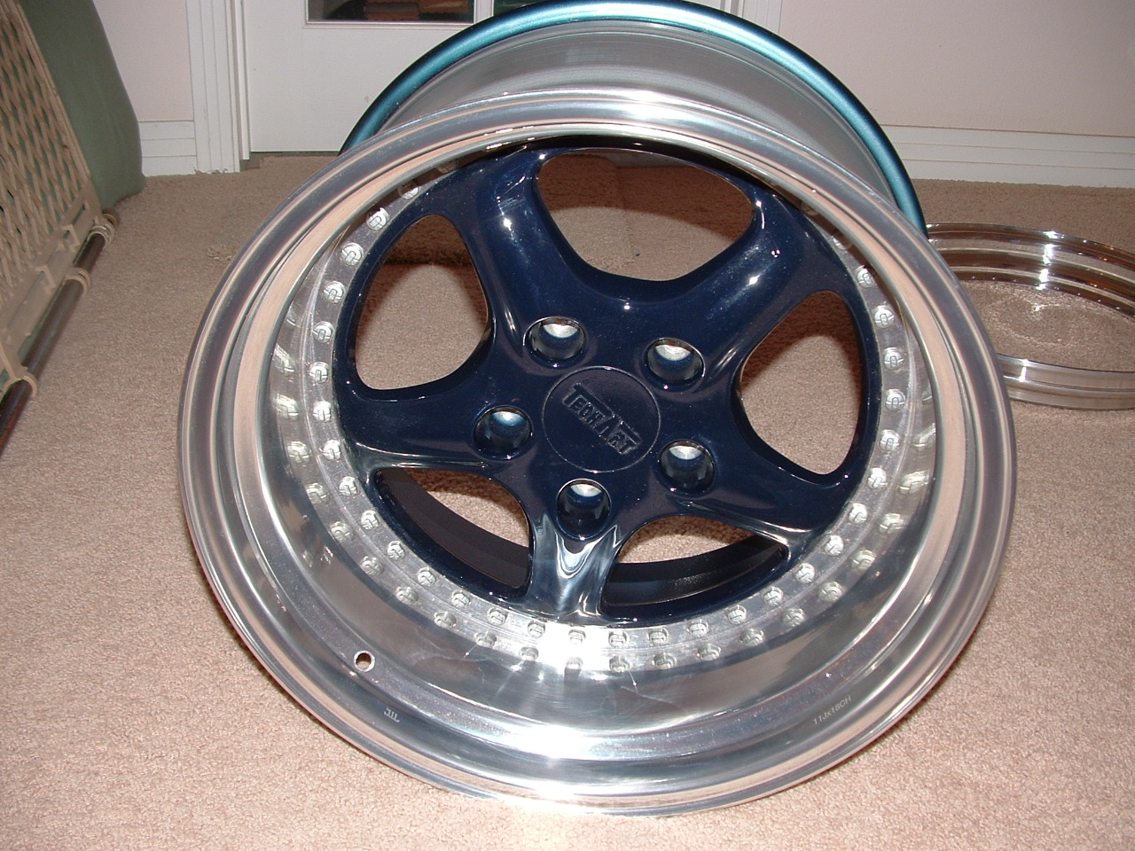

The wheels you are looking for need to be custom built to fit your car. The only way to get what you need is a 3 piece wheel. Now for the bad news there are no used wheels available in your needed size and ET. Viable options would be BBS, or CMW used of course but do not be surprised you will still need to buy some new inner and outer rims as the sizes/ET is special for your car. I build Speedline wheels and make custom sizes for the 930/911 wide body, 965/964RSR, 993/TT/GT2 cars. I have a Techart Daytona centers available for a custom build. My sets are however around $4,000 using the Daytona centers. I am attaching a picture of a set I built.Attached Image

Those are nice!

Yes indeed. Just out of my price range.
