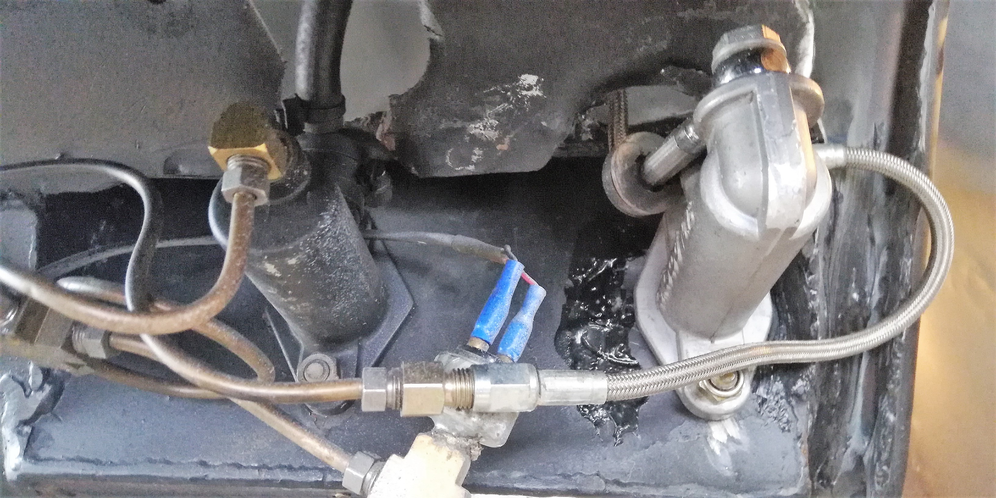

I want to point out one more time that Bill, that built you car offered me the pre-drilled, bent metal plate for the duel brake masters and the clutch. You can see it in my photo.
I got the shorter Willwood masters and it clears the Carrera rack. It tight but it clears the rubber bellows and all. You have a drive by wire throttle that makes it very nice. Maybe Bill bent the metal just in case he wanted to go with 3 masters.
Bob B
I already moved the clutch master over about 1.5" or so. I think there's room for 2 masters, it looks similar to your photo in size. I also have the shorter Wilwood Masters and should clear, just the clutch master points up and encroaches on the steering rack area if it's not upside down.

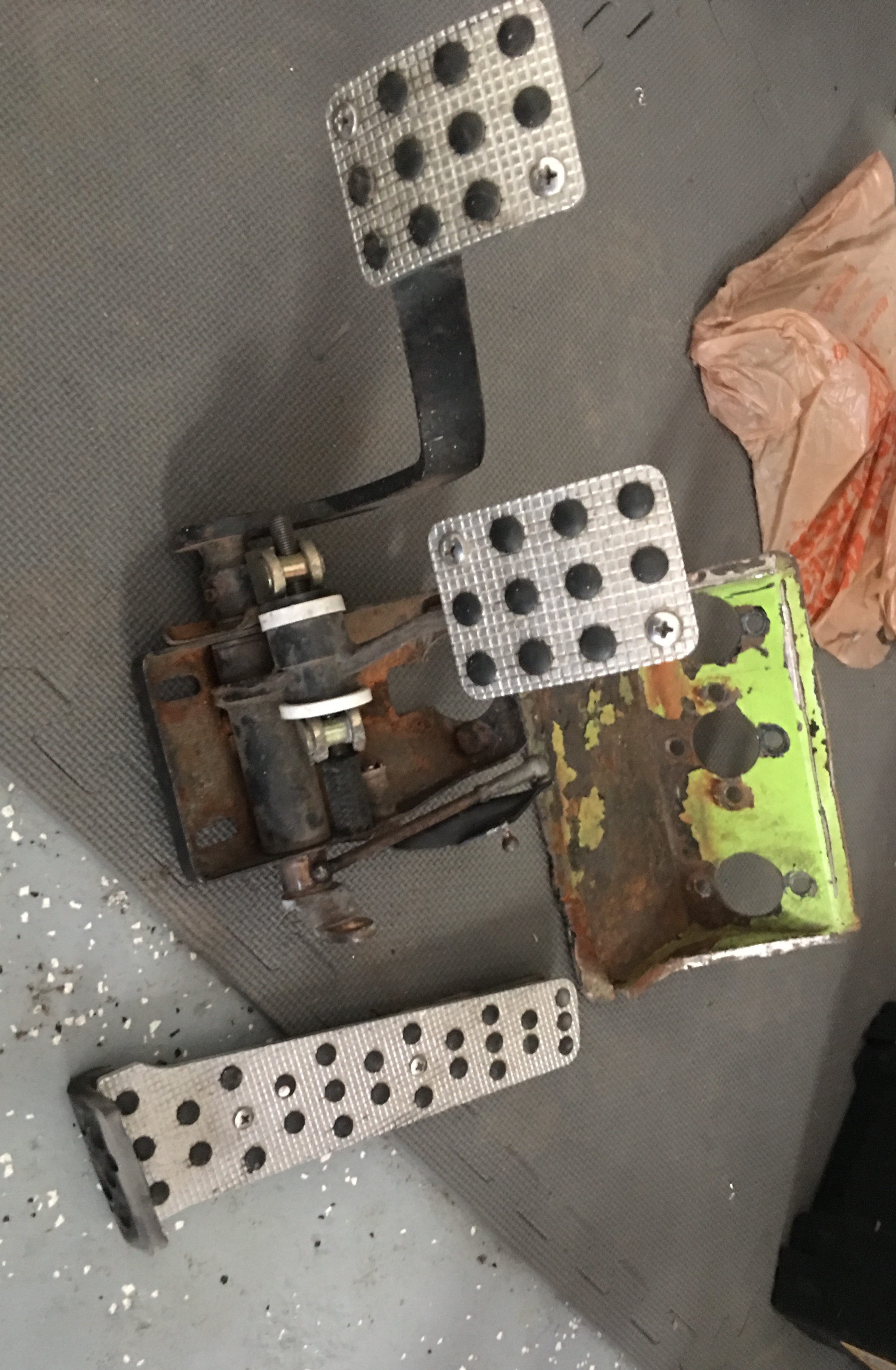

Dan, I took this out of my 914, gave it to a buddy, he went fancy pedals, still has this whole set up....its in sandeigo if your interested... (IMG:style_emoticons/default/idea.gif) (IMG:style_emoticons/default/popcorn[1].gif)

I know the clutch master was bad , brakes where good x2
get ahold of Chris...its cheep..I think... @effutuo101
single master like you have is just plain dangerous...

Here is what I have. The MC’s couldn’t be rebuilt (parts NLA and new ones in your choice of size are about $50.

effutuo101 is going to send me his pedal cluster, (your old pedals). I should be able to make that work. If not I'm definitely going to look into the second link you posted. Things are tight and if that fits then I'll give that a try. 3rd option is to play the safety card with my wife and get the house budget to fund a full on brake cluster. The bottom line is, I'm not going 150mph down the front straight with a single point of failure and I think she'll agree with me. She wants me around for a while longer.

Think this one through before you cobble masters onto a teeners pedal assembly. Please.
Tony you are correct ,,but if you look at rsr pedal assembly you will see its no mystery..the pedal assy. I have shown was done by a well known fabricator in AZ...its no cobbled together piece...but your right write a check...the skies the limit...maybe you should have chimed in earlier....just saying..race on
btw it worked great for 2 other owners,,my son is a foot taller . so I made an adjustable pedal assy...
I like that pedal assembly. It places the clutch further left allowing me to spread my legs a bit. Cause, apparently you have to have big jewels to drive these cars. I hope to find out some day...

Dan,
Pictures of set up. Tony says get the reservoir with the AN fitting.
Bob B
Attached Image Attached ImageAttached ImageAttached Image (IMG:style_emoticons/default/driving.gif)

You were telling me. Thank for that info. AM fittings = no leak
Bob B
