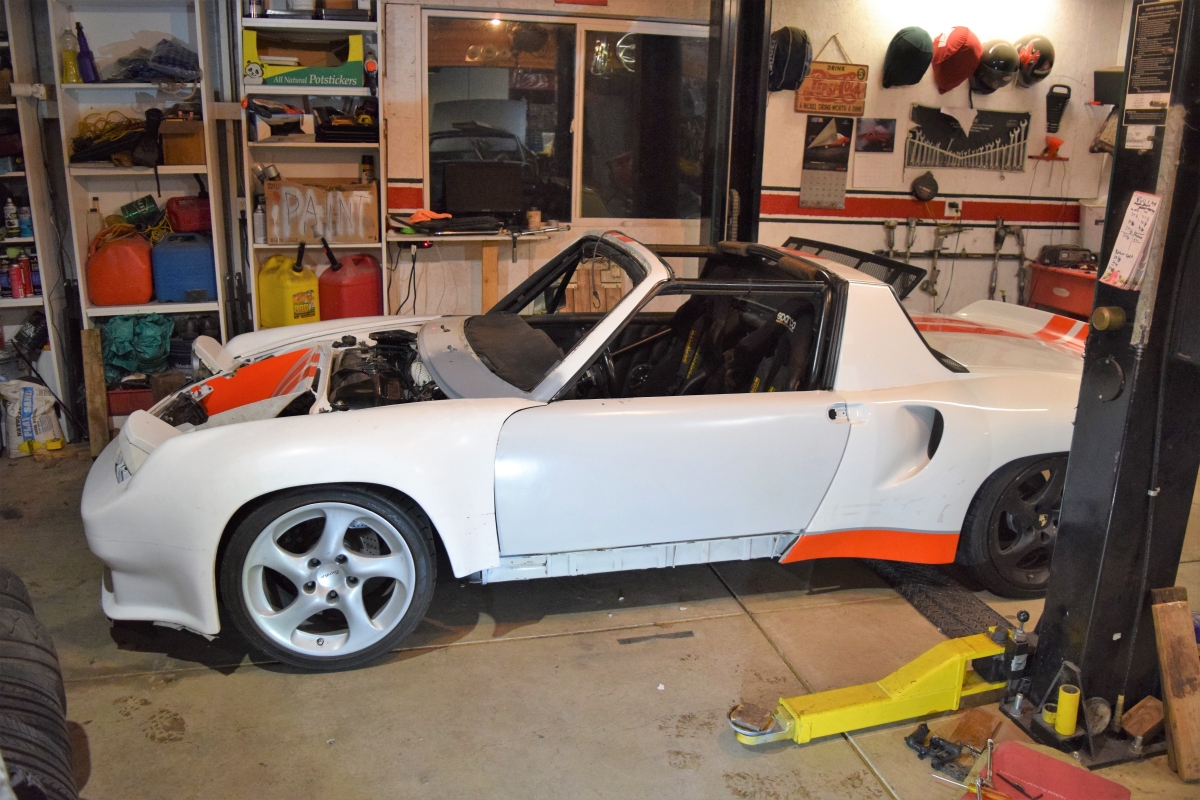

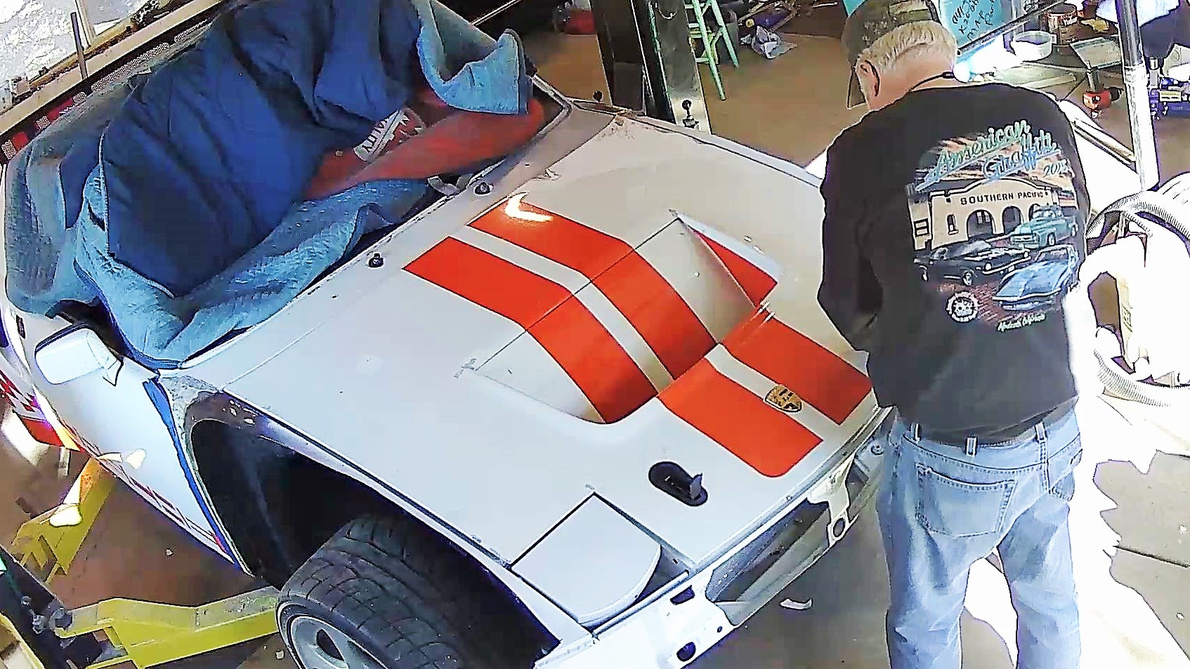

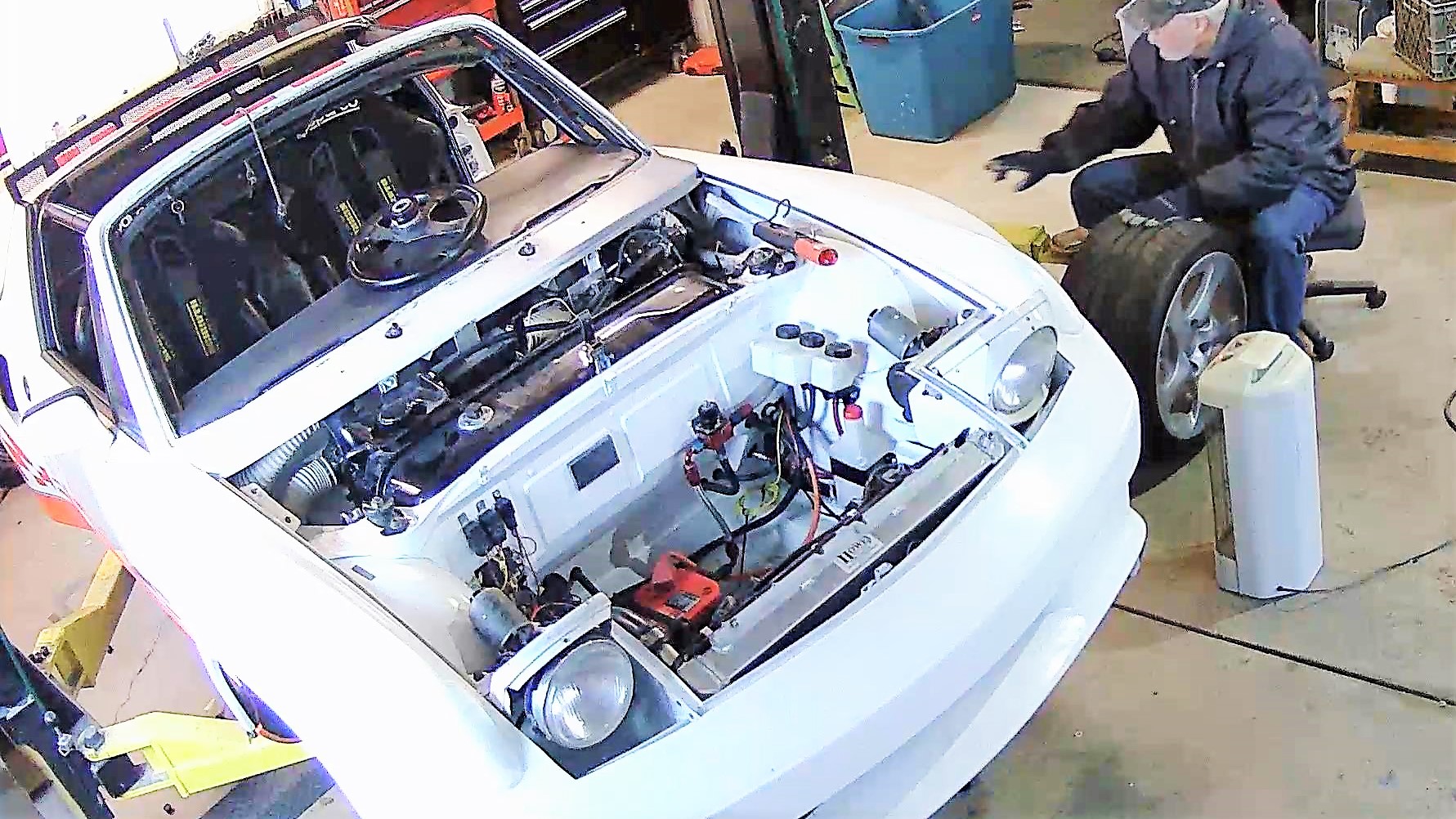

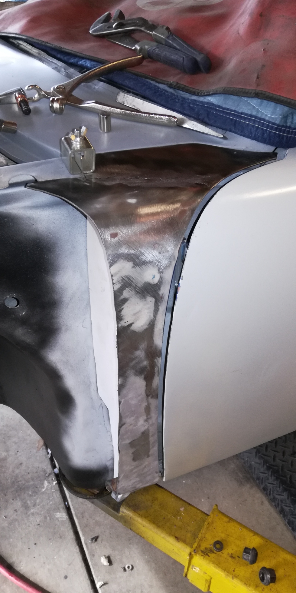

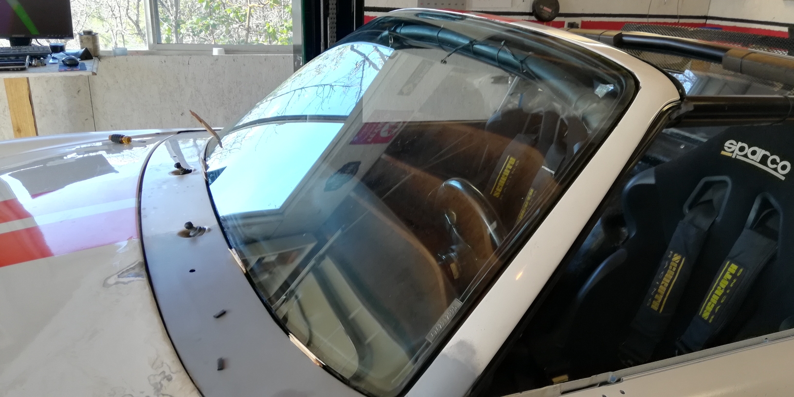

A lot has happened.
Finished up the seats, pedals and master cylinders. Made new brake hard lines to plumb in 2 master cylinders. Bled front and back brakes.
I finished the prep work to make ready to attach the fiberglass front end. Fabbed up a mounting piece near the drivers door hinge using the stock fender piece. Then I cleaned off what I thought was fiberglass pieces on the passenger side same piece. However it was combination of the remainder of the fiberglass fender graduating to bondo to meet he fender edge. I'll be putting it back together with DTUZ fasteners initially. After a bit of time I'll determine if I want to bond it on permanently.
Did a bit of body work on the cowl to ready for the next step.
Primed the windshield seat and a buddy and I dropped the used windshield into place.
I plumbed the radiator, fuel tank and pump and wired the frunk. Still more wiring troubleshooting to do. The headlights always want to pop up with power applied. Plus I need to wire in the turn signals.
I re-positioned the radiator mounting so that the GT40 scoop would sit correctly. It's now mounted in place and the hood closes with the stock latch as well as the 2 Aux latches.
After Andrew got his 914 outlaw running this weekend, I got excited to try mine.
Today I added coolant and oil and gave the key a try. it would have started but I forgot gas... hmmm Oh, and connecting up the computer after all the welding I was doing. After that, VarOOOOOMMMMM. (no mufflers...)
Things to do... (there's still lots to do, but this is what I need to do to drive it..)
Cut out signal light openings in the fiberglass fender.
Wire in turn signals with quick disconnects.
Mount the fiberglass fender and bumper assembly
Take it to DMV for VIN inspection and hope they don't say WTF!!
1st race March 29th.
It's getting close...

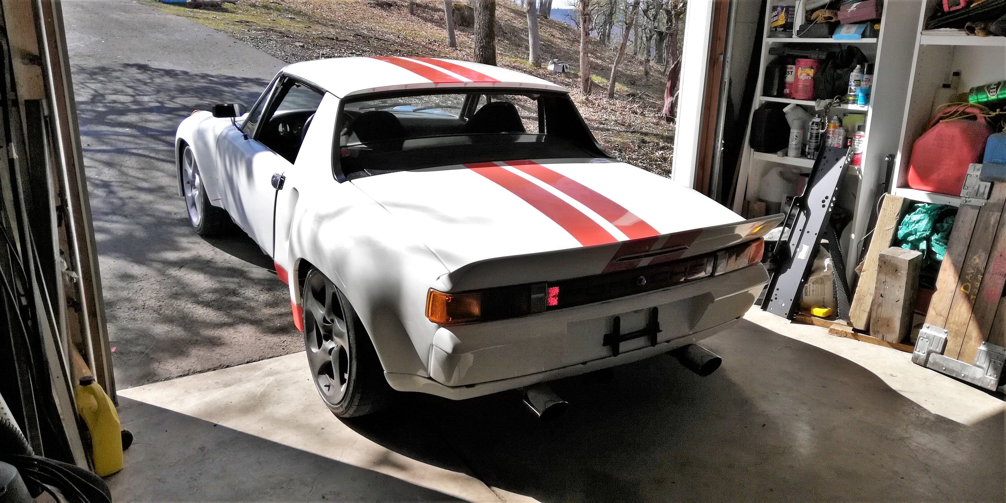

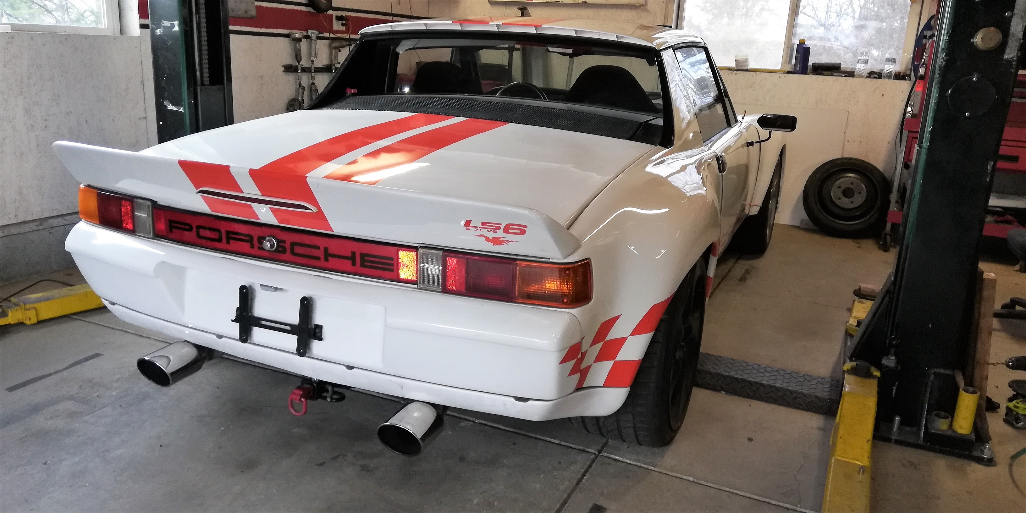

So a new picture and a new view. Does anyone know what that means???
Yes, it's running and driving under it's own power! Made it up and down the driveway with no real issues!
Oh, I colecoed the front fiberglass fenders and bumper. I'll redo it in Dzus fasteners when they arrive next week. By then I should be ready to haul it down to the DMV.
I did a tuneup changed the plugs and wires, and a coil, wrapped the headers to knock down some of the engine noise. it did help.
I also installed some rear view mirrors. Much smaller and lighter than the flag mirrors. Not everyone will like these, but they'll work for now.
I tried to order some tires for the 'other' set of wheels, but the ebay seller must have woke up and he canceled the order when he realized that he was selling for $100 less than the going price. I did find a used race tire dealer that might work for me.
