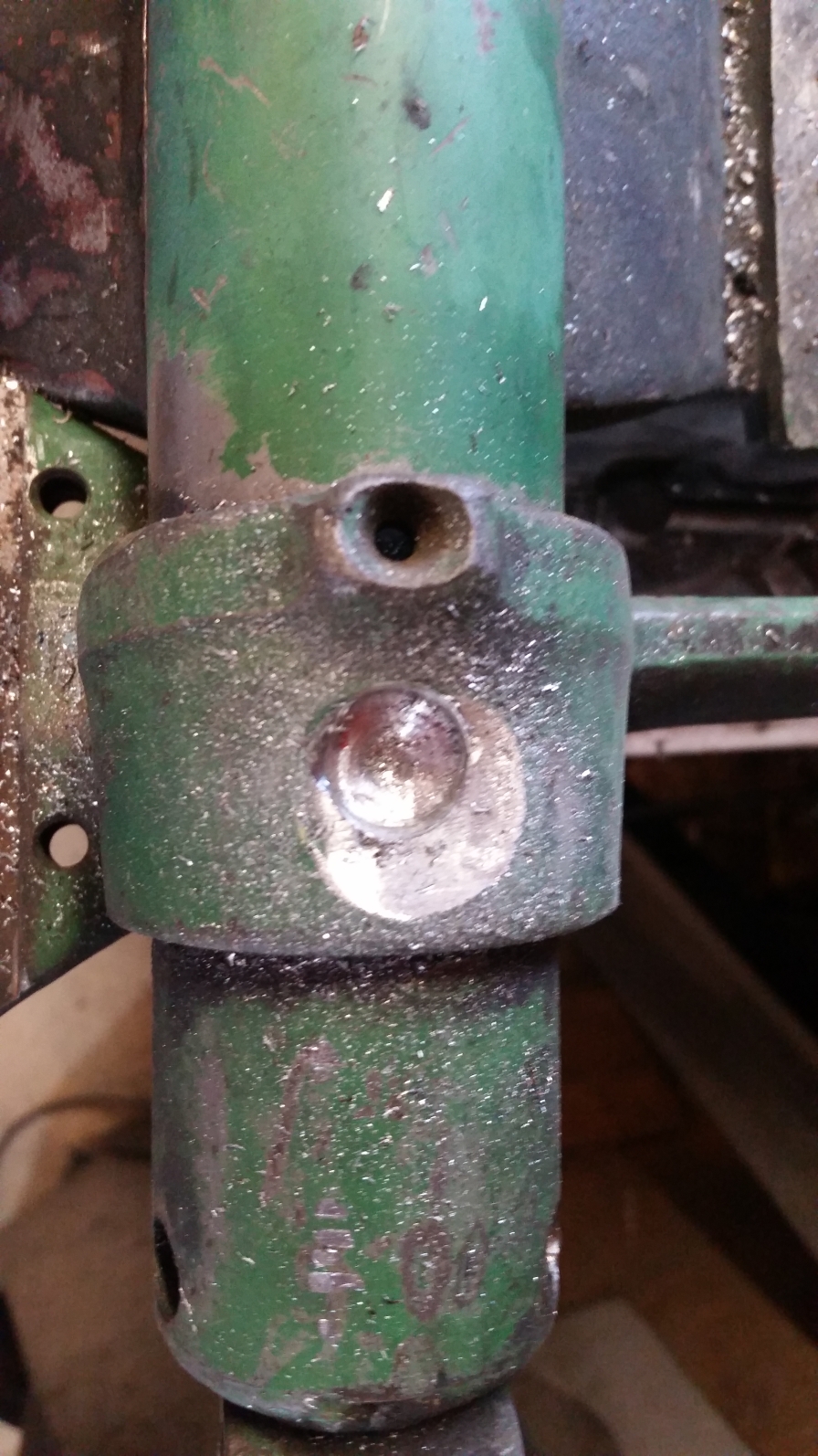

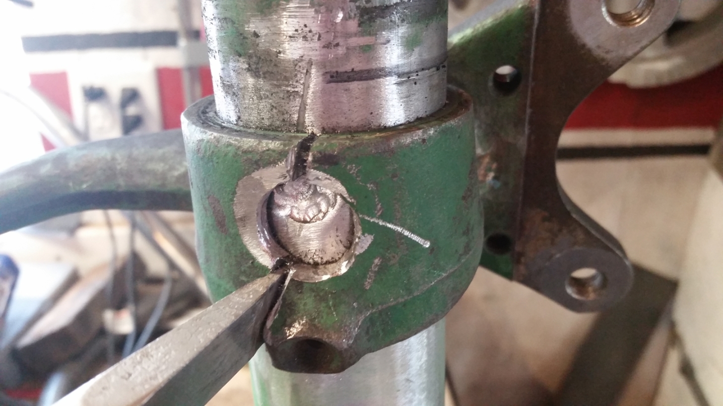

So I decided to experiment on my stock spindles and drop them 19mm (3/4”). Then lower the torsion bars a bit and gain some camber. Right or wrong here is my adventure in raising spindles on Bilstein struts.

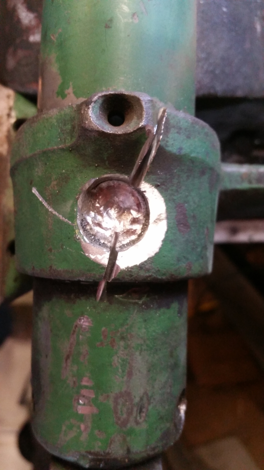

Start by locating the ¾” weld hole on the back of the spindle/strut.
I drilled a small starter hole then the largest bit I had to remove as much metal as I could with a drill bit without going thru the strut housing.
Then I took a dremel and rasp bit and ground the rest of the ¾ inch hole. I’m sure there are easier ways, but this is what I came up with.

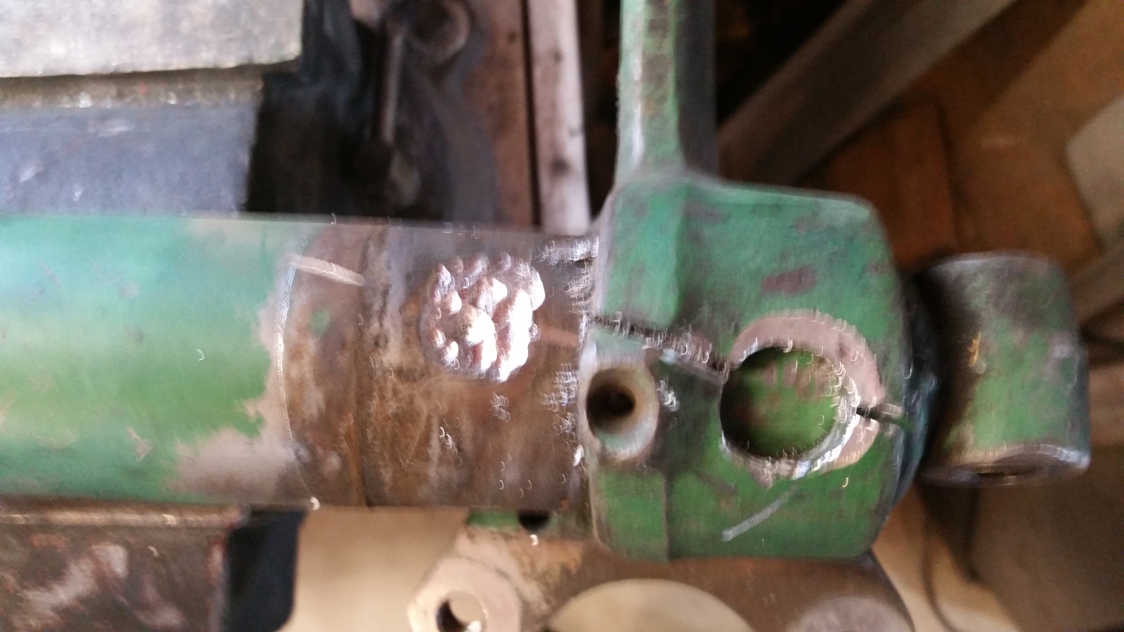

You can’t really get it all, so the next step is to cut a slot in the top and bottom, (see pict). Then tap a chisel or ground down screwdriver in there to separate it. It breaks the rest of the weld free. You may need to grind a bit more to break it all free.
After it starts to move you can see where the high spots are and grind them down until you can drive the spindle down to the bottom. It’s tapered slightly so it easier to go down first.

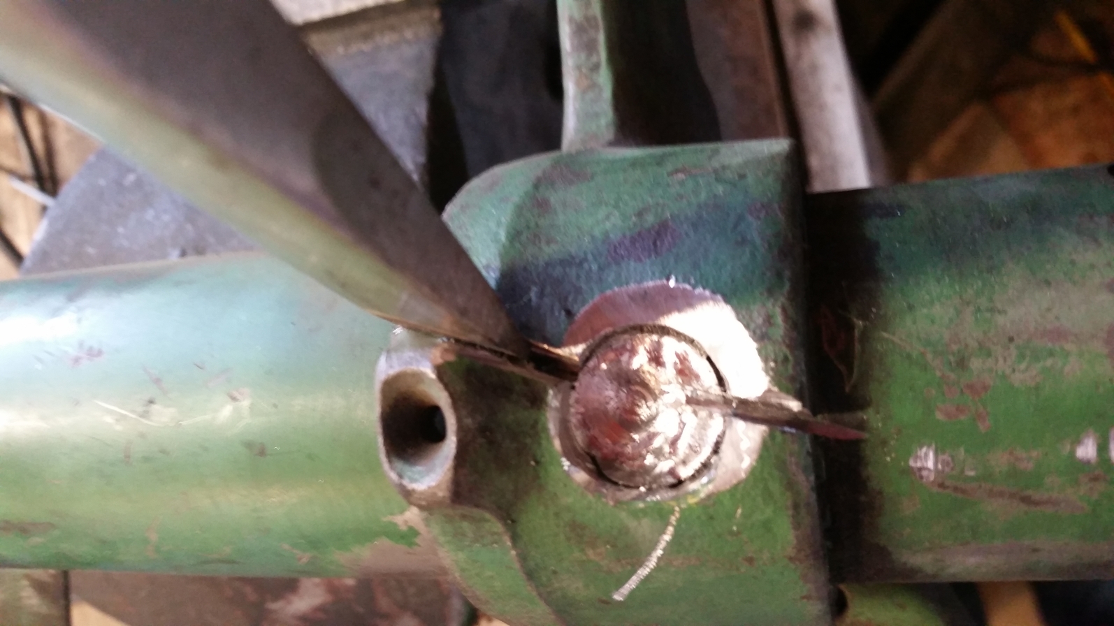

Then clean up the old weld spot and take the paint off the strut housing to make it easier to slide up however much you want to raise the spindle.
Now is the tricky part. Since I only wanted to raise it 19mm, it wasn’t a problem for me to tap a chisel in the slot and knock the spindle up 19mm higher than before. But going higher the taper becomes a problem. I imagine some heat or I think I read that others removed the spindle entirely and removed material from the inside would allow you to go higher. ( I’m speculating here, my 40mm were already done when I got them).
Once it’s at the height you want it, then it’s a matter of cleaning the paint off and welding it in place.
Note: I’ll be taking care to keeping my spindle to strut angle to 12degrees or less. One of mine was 9 degrees and the other 13 degrees. Moving it up the strut seems to have put them right at 11 or 12 degrees where I want.

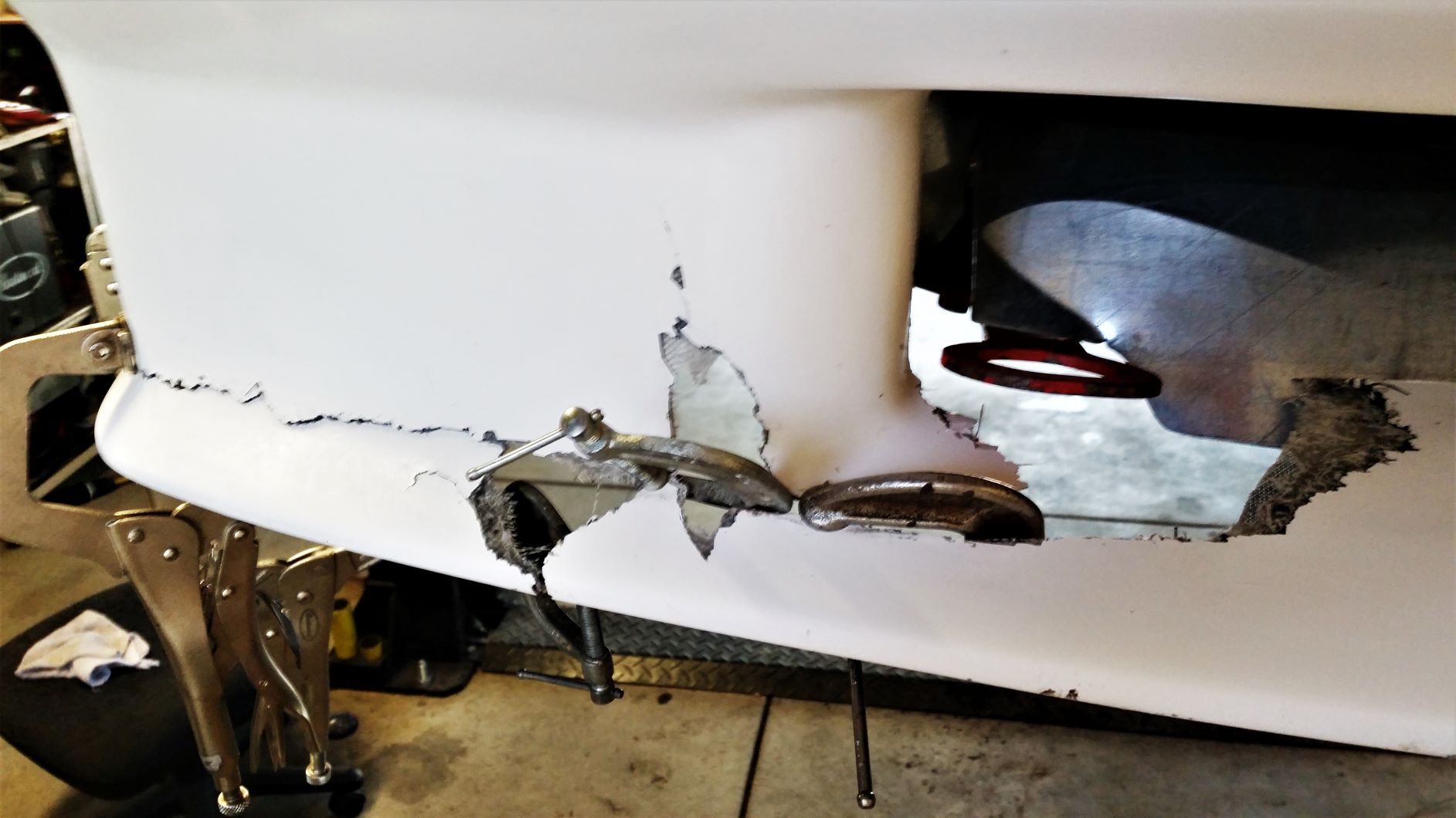

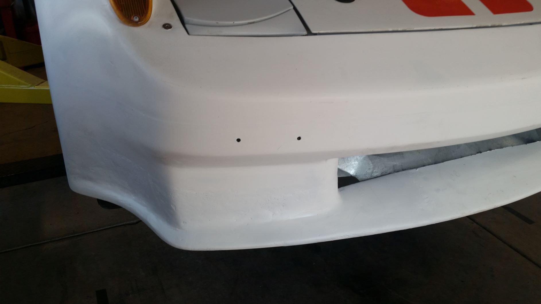

I spent some time getting back to the art of fiberglass work. My little experience with the trailer caused some damage and needed repair to the front splitter. I started by calicoing the pieces back together and determining a way to hold things together while things dried. I worked from the front first so I could make sure the 2 halves lined up. I used angle hair to glue them together, clamped them and let it get hard. Then applied some layers of matt to provide strength and to fill in the gaps. (yes, big gaps.) I worked the front a bit and then removed the front end, (hey, that’s kinda handy). Working from the back side I applied several layers to get the strength back where I wanted it. Then I moved back to the front where I could get it at least close.

Dan - Congrats on the class win! Nice repair on the fiberglass, too. (IMG:style_emoticons/default/beerchug.gif)

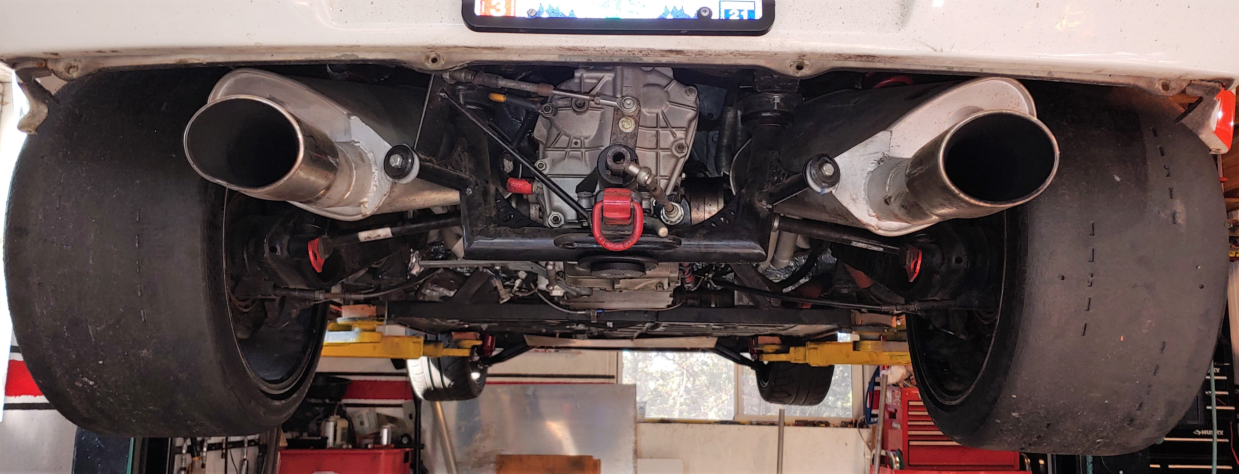

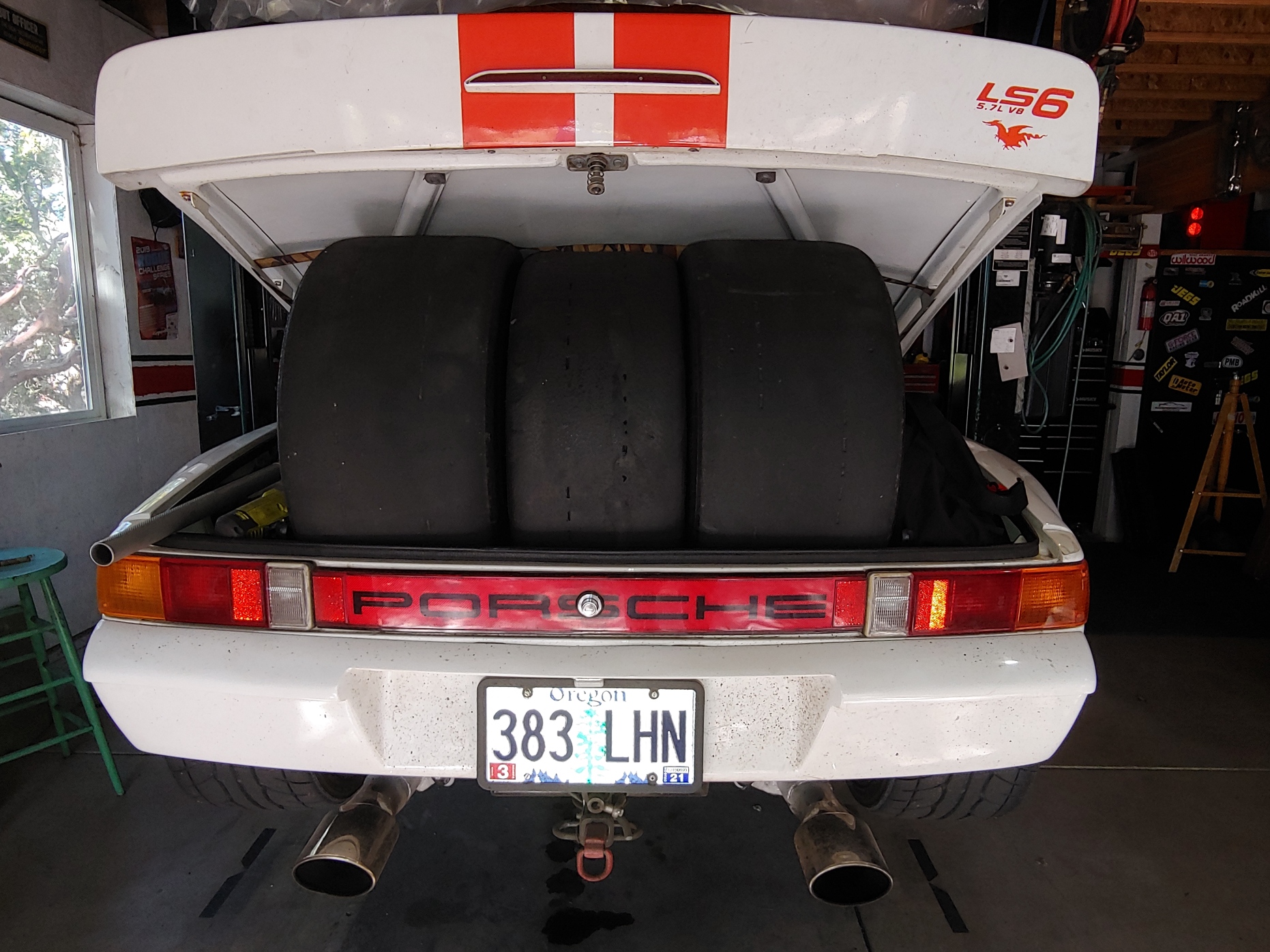

Here's my get to the track solution. It works for short excursions.
Here the long video if you're interested.
https://www.youtube.com/watch?v=DcBzrdm7ANc

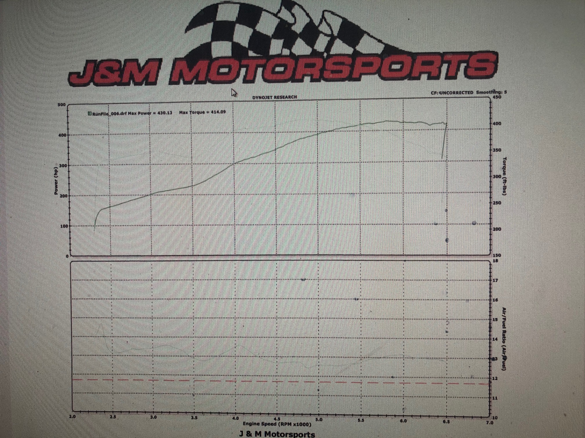

Fun Dyno Day!
Ok, I just saw this last minute. $100 for several pulls.
So after Cars and Coffee this morning I headed over to a dyno day.
Not the HP number I was looking for, but close to what I expected. 362 at the rear wheels. Anyway it's not about the number (so they say...) So more tuning needed. Plus I don't know if the computer is pulling timing. A/F look pretty good.
I ran the first several pulls in 3rd, because his dyno maxed out at 154mph. The last pull was in 4th to see what difference it would make. It stopped at 5500rpm.
enjoy...

Dyno figures that you are getting seem kind of low? Last time I had the motor tuned and dynoed on a Dynojet I got 430 WHP
