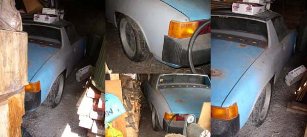

I know, I know, bad pics, but that's all I can get until I pull it out of its hole this weekend!
thanks for any thoughts

It's not a '74. Might be a 2.0. If it were a 2.0!.... (IMG:http://www.914world.com/bbs2/html/emoticons/ohmy.gif)
you could get $400 for the engine and $400 for the wheels!!Easy! Confirm?

That's how mine looked when I went to look at it for the first time.(stuffed in an old barn/garage) I spent a whole day cleaning out the mouse crap.

75 or 76 bumpers on it...... when you get it dug out take pics of the "hell hole" and the suspension mounts/longs
If you can read the serial number you can tell what yr it is

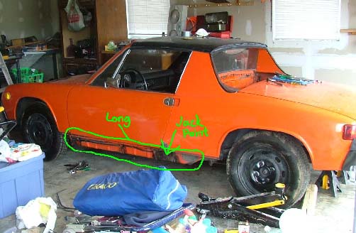

The longs are the Longitudinals. look behind the rocker panels and around the jack points. Do a search in the fourm for hell hole and rust repair before you buy anything. 914's can look good from the outside, but be rust buckets under the surface. Here is a photo of a Longitudinal. the driver side is usually not as bad as the passenger side. As far as the suspension mounts go, just check all around the rear suspension for any signs of rust. Also, look under the carpet and behind the seats. It's best to take your time and give the car a really good look.
