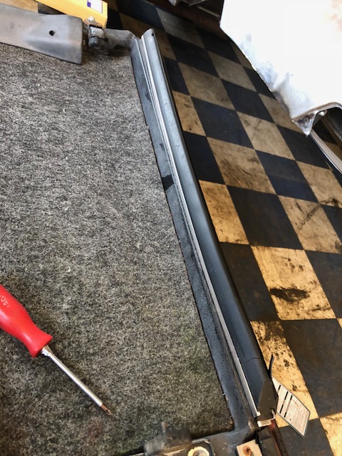

I volunteered to evaluate 5 pieces from URO. They are all trim pieces.
First of all, I am not going to resell these on my website. I have no vested interest in the company. I personally have used all of the regular suppliers and I hold no allegiance to anyone.
Competition creates quality. At Restoration Design we deal with it just as much as anyone else. It can be frustrating, but in the end it only make us work harder to have better quality parts.

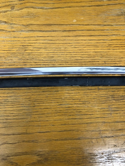

These are the pieces that I reviewed. I used original Porsche rubber to test the fit.

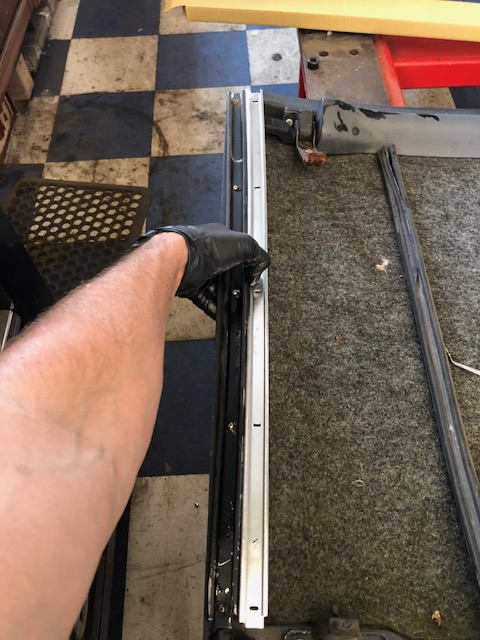

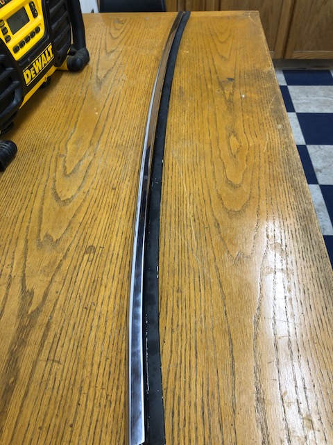

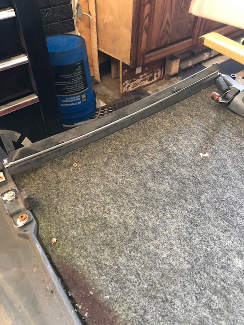

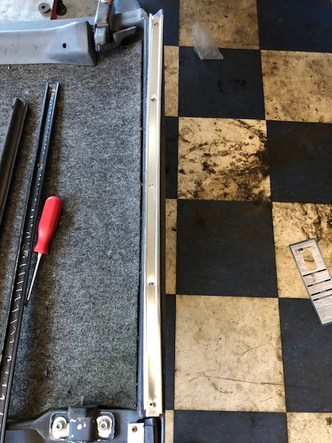

914 531 865 10 (This fits the left side targa top; has a very slight curve to it.)
914 531 866 10 (This fits the right side targa top; has a very slight curve to it.)
I test fit these on a /6 that we are assembling here, so its my desire to have quality pieces put on it.
The curve matched the original well. Also the screw holes are all in the correct location.

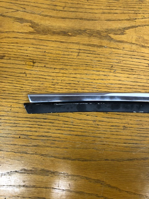

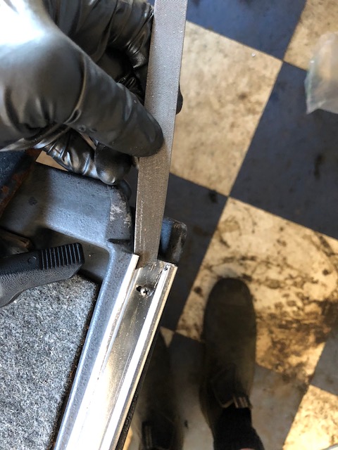

The only issue I have with this piece was that I had to file the edge of the trim to slide the rubber seal in. This did not affect the appearance from the outside.

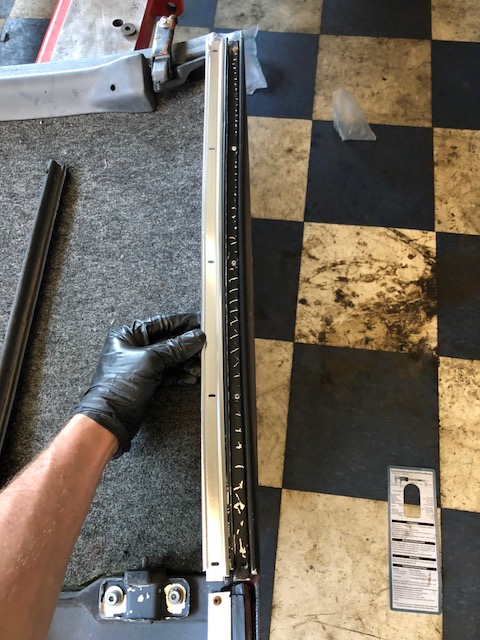

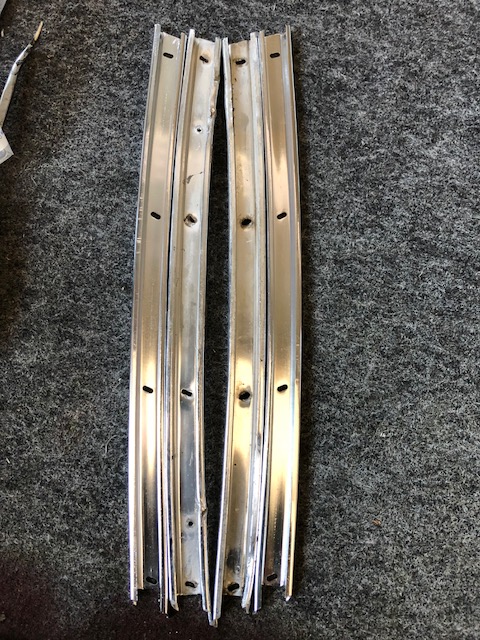

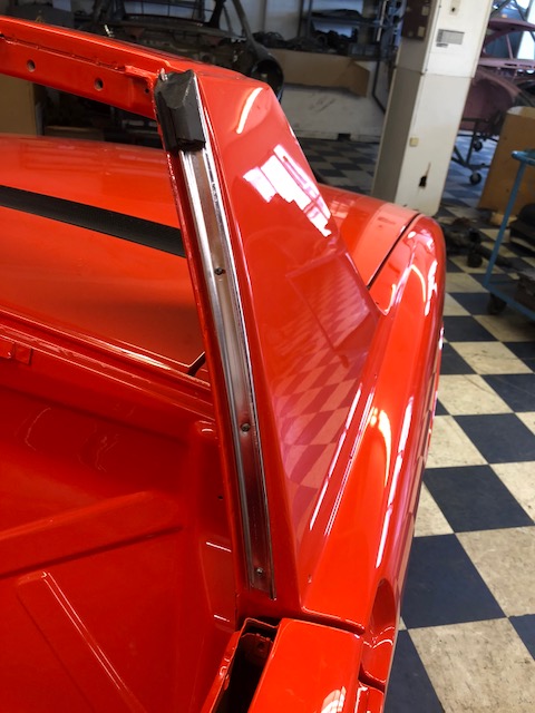

914 531 827 10 (This fits the left B-pillar; has a pronounced curve to it.)
914 531 828 10 (This fits the right B-pillar; has a pronounced curve to it.)
These pieces match up to originals well. The curve is correct and the holes are in the proper location. The factory had crimped the edges in several spots to hold the rubber in. These repros don't have the crimp, and in my opinion rightly so, because the end user needs to do the crimp once the rubber is installed.
I also had to file the edges to slide the rubber in.

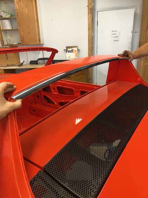

914 559 103 10 (Rear outer roll bar mounding)
This piece is also very nice in appearance. The one knock would be the curvature is slightly off from the original. It was not hard to flex it to the right curve while installing it though.
