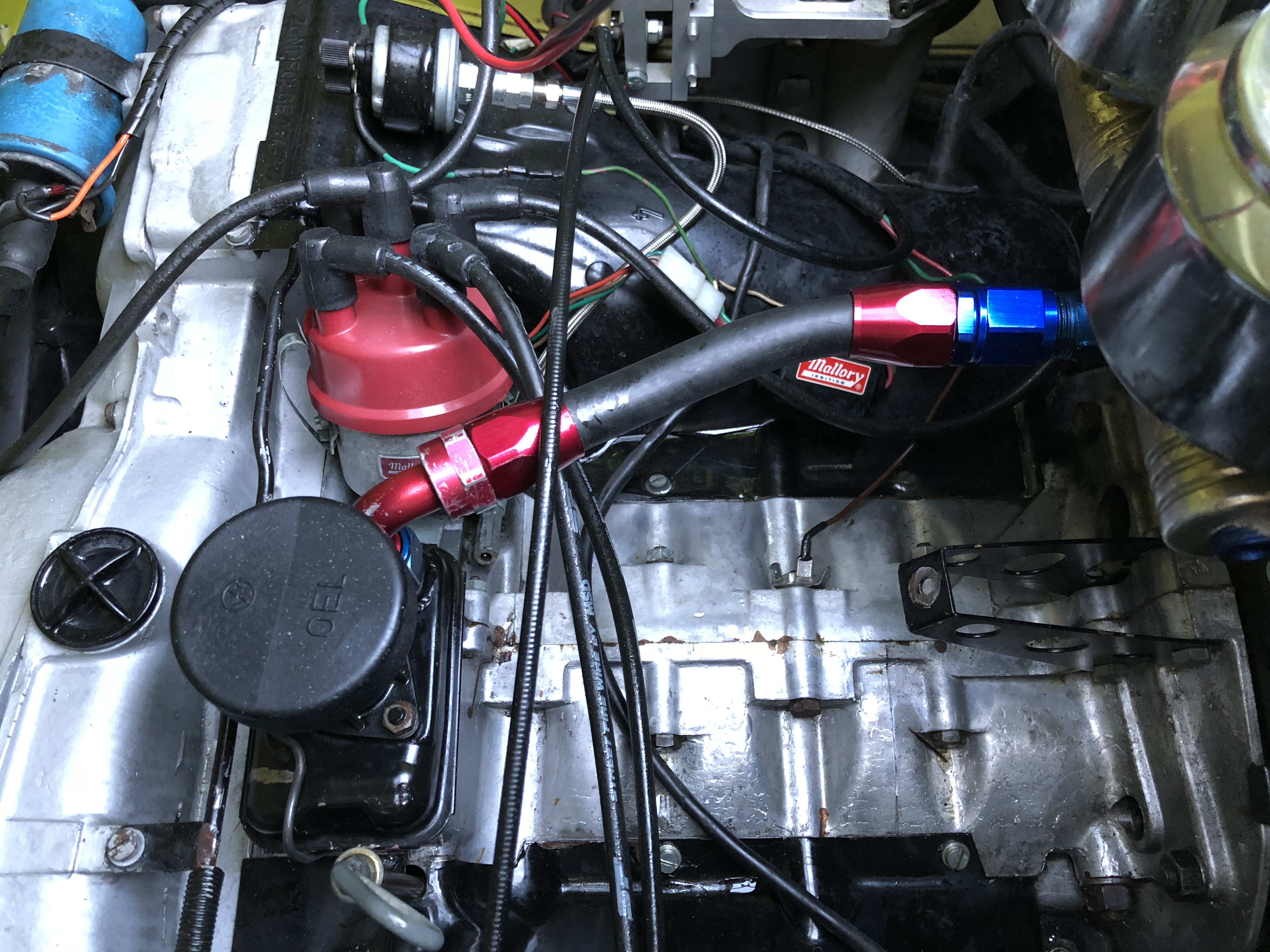

yeahmag
post Jul 30 2018, 08:21 PM
Posts: 2,455
Joined: 18-April 05
From: Pasadena, CA
Member No.: 3,946
I decided to bend the bale in to a better shape and ghetto up a softer, more flexible hose. 1/2” ID heater hose fits the -10AN fittings surprisingly well.

r_towle
post Jul 31 2018, 08:41 PM
Custom Member
Posts: 24,705
Joined: 9-January 03
From: Taxachusetts
Member No.: 124
Aaron, that just looks like it will wiggle lose with so little flex.
I would keep a close eye on it, and maybe consider a slightly longer piece of hose to add in some movement?
Seems from what I can see, the oil breather is mounted on a stationary part of the car, and the engine is moving?
that type of movement will loosen up something over time.
yeahmag
post Jul 31 2018, 08:47 PM
Posts: 2,455
Joined: 18-April 05
From: Pasadena, CA
Member No.: 3,946
I agree. The proof of concept is there though. That heater hose is super soft! If it survives the next event I’ll move to a nylon braided (style) hose and mount a standard, non-return breather/catch can to the stand off you can see in the picture.
r_towle
post Jul 31 2018, 08:56 PM
Custom Member
Posts: 24,705
From: Taxachusetts
Member No.: 124
it will get really soft and squishy when you are at the event...
Dont touch it or you may walk home...lol
I ended up putting the oil breather box on a bolt on the motor.
then, everything moved together.
I struggled with the head breathers and main breather until I moved the box...then all the wiggling stopped and things worked perfectly.
And yah, that tubing...it won't last if its what I think it is.
I tried that too (IMG:style_emoticons/default/smile.gif)
