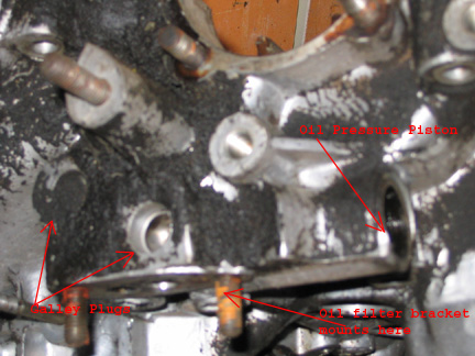

The oil pressure switch can be hard to detect. Sometimes it just seeps oil. I would recommend using some brake cleaner to clean up the sender and the area around it that you can see through the sheet metal, then go back and check it later to see if it is no longer clean.
The other thing on the front of the engine that can leak is the oil galley plugs as they loosen with age. There is one that is just above the oil filter that I lost on a very cold morning when my oil pressure was up. In hindsight I should have known that this is where my oil loss was coming from, but at the time it wasn't obvious to me. It's very dangerous if you blow out an oil galley plug - especially if you ignore the green light and drive it because you are sure you've got oil! (IMG:http://www.914world.com/bbs2/html/emoticons/wacko.gif) Wanna guess how I know that?
The ultimate solution for a loose oil galley plug is to have them removed, tapped, and plugged with threaded plugs. This is normally done when the engine is being overhauled so that you don't have to worry about metal shavings, but in a pinch it's been done very carefully with the engine still together (but not by me).

QUOTE (jim912928 @ Jun 15 2005, 11:41 AM)
I don't loose enough that a galley plug would be gone...doesn't mean it's not seaping though
It certainly isn't missing in your case - you'd be missing all your oil in a matter of minutes. Yes, they can seep - that's the sign that I missed. If the galley plugs are seeping oil, then it is a sign that they are loosening and that disaster is only a matter of when, not if.
There are more galley plugs on both ends of the engine, but the one by the oil filter bracket is the one that I blew out and I understand that it is the most common one to fail because of the oil pressure that it holds back.

I don't think you can see this from below the car. I looked at my old case, then crawled under the car, and I wasn't even sure that I could see the area where it was. For sure, you can't work on it without pulling the engine and removing the fan housing.
I know this picture is blurry, but I hope it helps some. Looking from under the car it looked like the lower plug is "behind" the engine mount, with a small space between the face of the engine and the mount. But every time I looked at the case and then crawled under the car to look at the same area, I became confused about whether I was really looking at the same place.
I think you can at least know if it's seeping if you know for sure that the oil pressure sender and oil cooler seals are not leaking and you've cleaned it up. I would use brake cleaner to spray around the oil pressure sender and be generous so that it runs down the engine and drips off the bottom. Then go back and spray this area from below to get it clean. Next watch the area to see if you still have oil in the area of the the galley plug.
I hope this helps. Sorry the photos are so fuzzy. I would have shot a picture from below the car, but I'm not on a lift so I don't have enough room to photograph it. I'll have to get Andy to show me how to take pictures!
