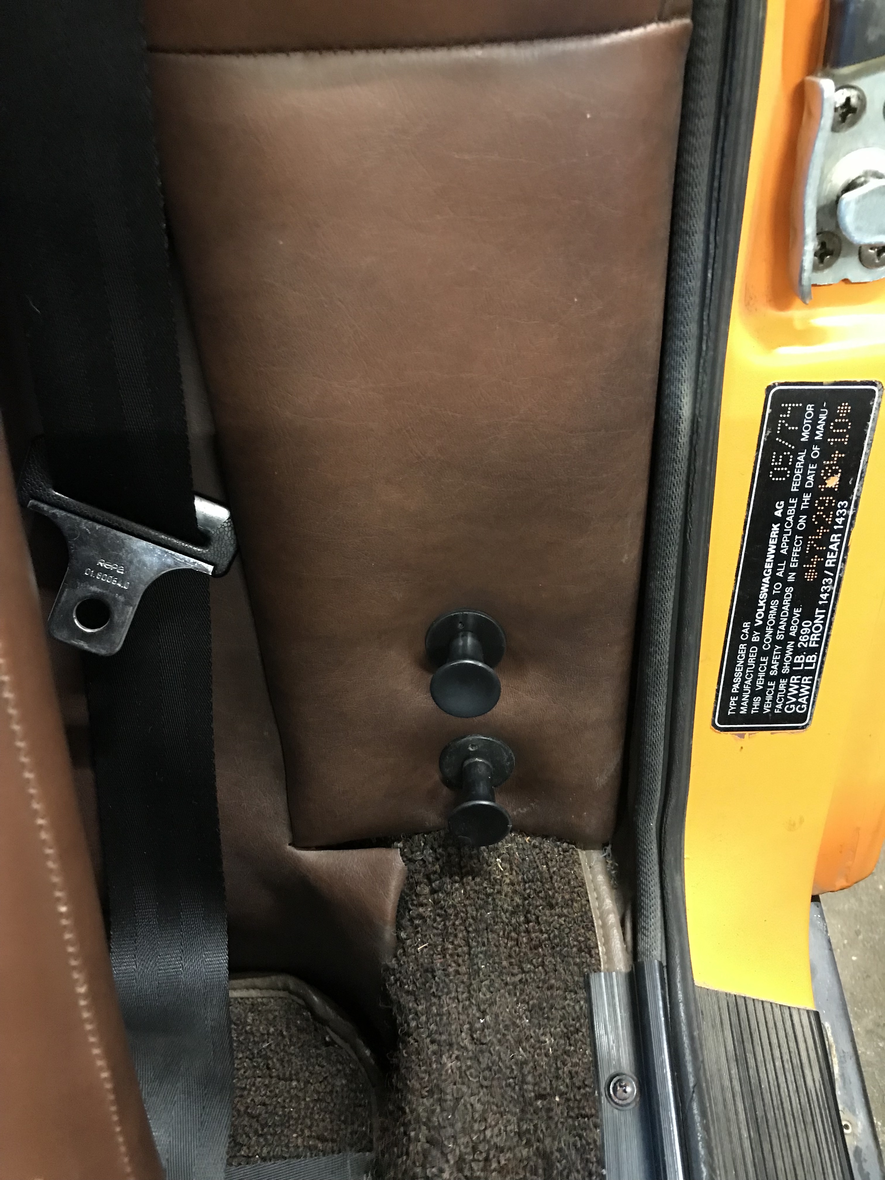

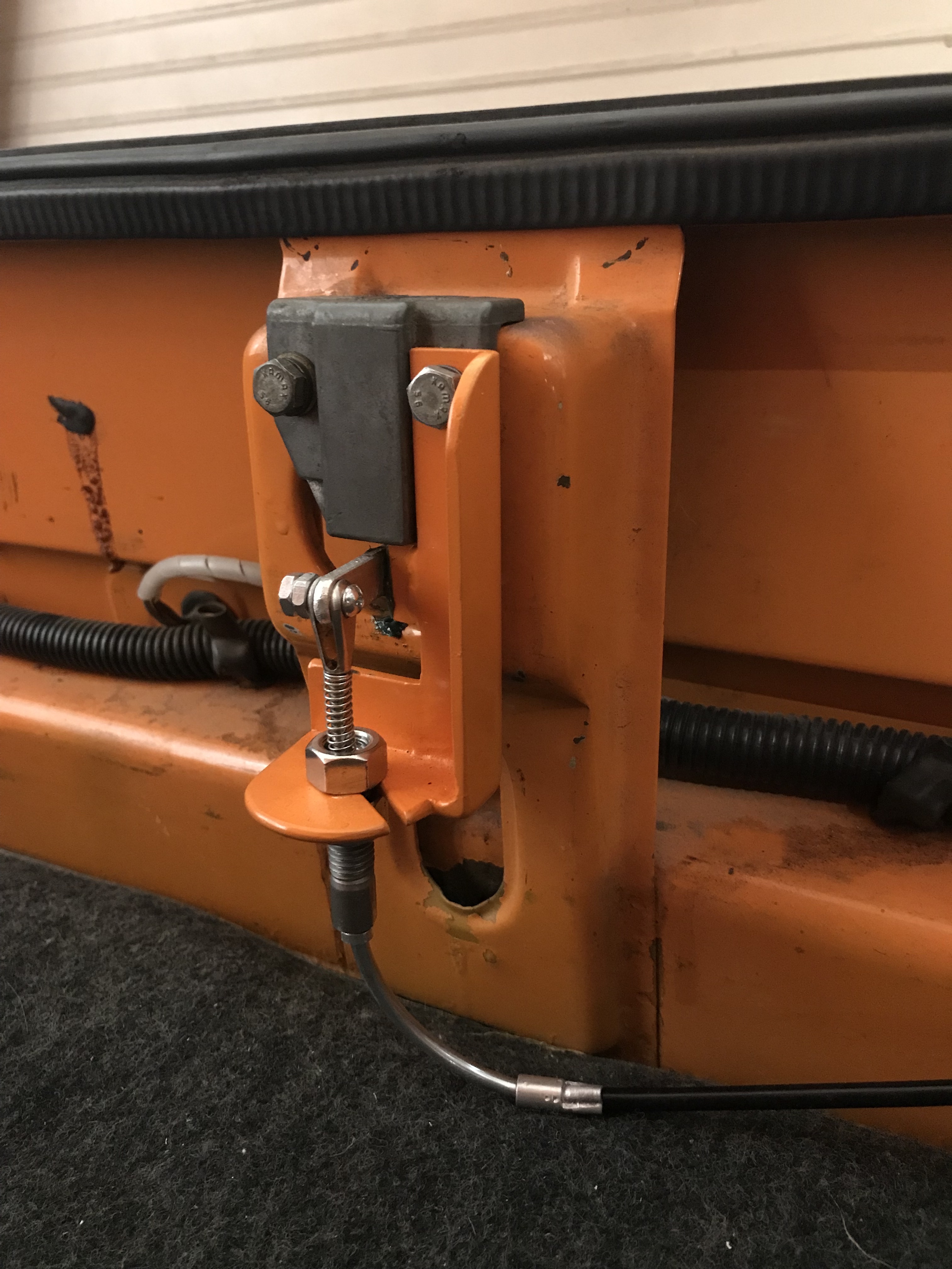

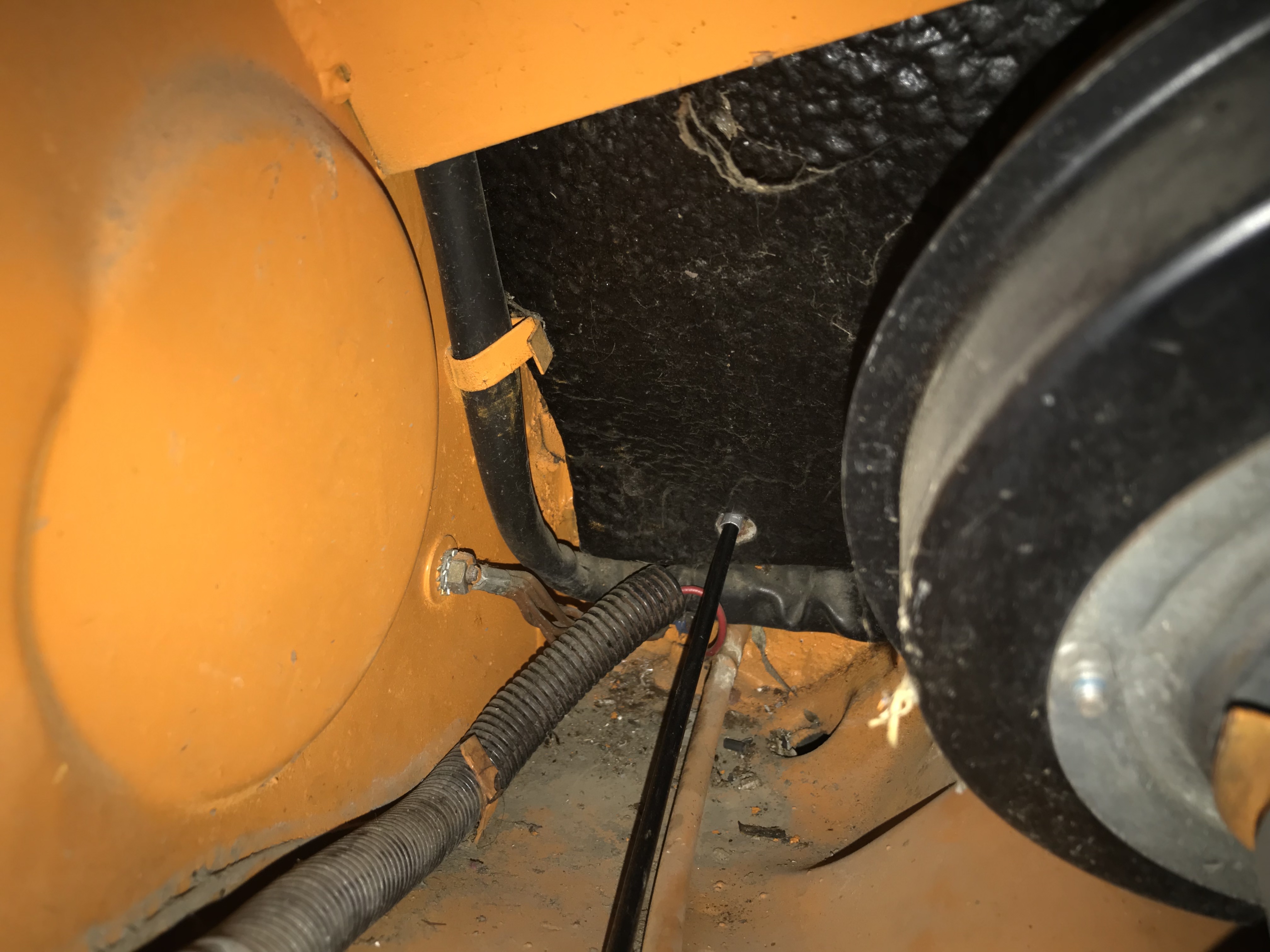

Alright as promised here are a few photos. @914werke reached out to me and will possibly be doing a run of these (or similar) if there is enough interest. If you would want to buy one send him a PM.
The in-car knob and bezel piece were 3D printed then I did some finish work (sanding and painting) to clean up the stepped layers the 3D printer leaves, before installing in the same manner the original pieces.

Nogoodwithusernames
post May 27 2019, 06:18 PM
Posts: 314
Joined: 31-May 16
From: Sutter, CA
Member No.: 20,051
Hand-made bracket based off the solenoid bracket that was previously installed.
