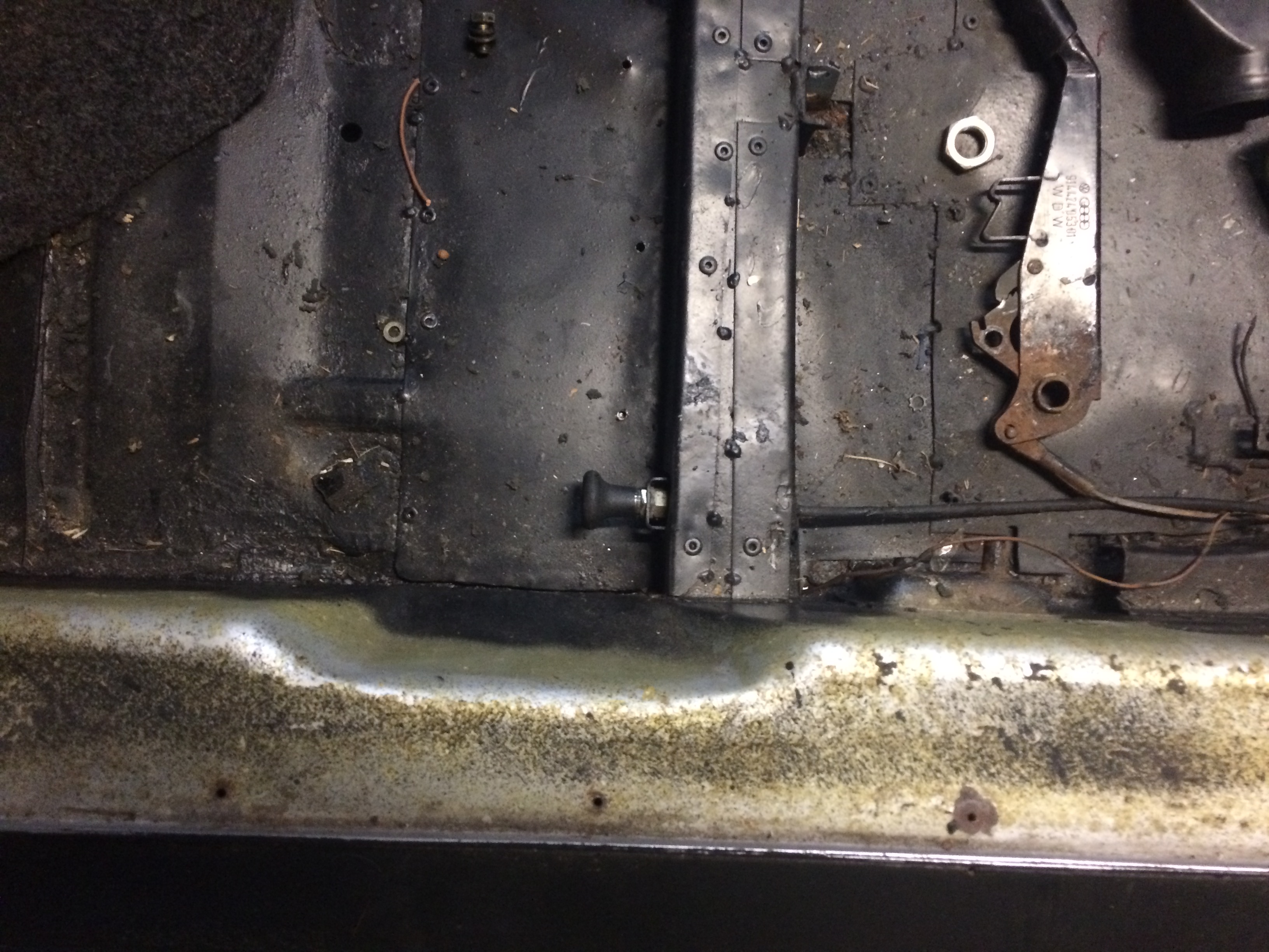

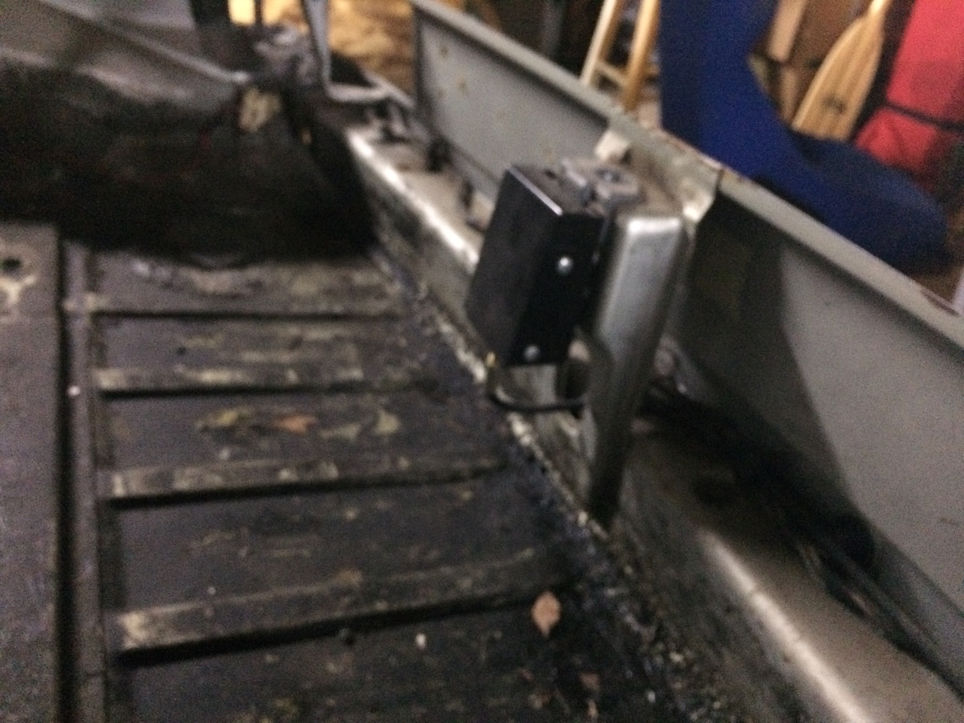

Don’t know where I got it, but about 10 years ago I bought a cable release mechanism after much frustration with the electric release. I ran the cable from the crossmember through the engine compartment and alongside the trunk edge to the lock. Worked every time.
I’ll try to take some pics tomorrow and will post them.

Attached are pictures of my trunk release. I’ll keep looking for info on where I got it.Attached Image Attached Image Attached ImageAttached Image

QUOTE(Bill Shaw @ May 28 2019, 06:42 AM) *
Those look exactly like what I was trying to accomplish here. Looks like you may have gotten the "Engmann" kit I refer to at the beginning of this. Unfortunately he passed a while back so the kits are of course not available anymore. Hopefully Rich will be able to make a few for anyone interested.
