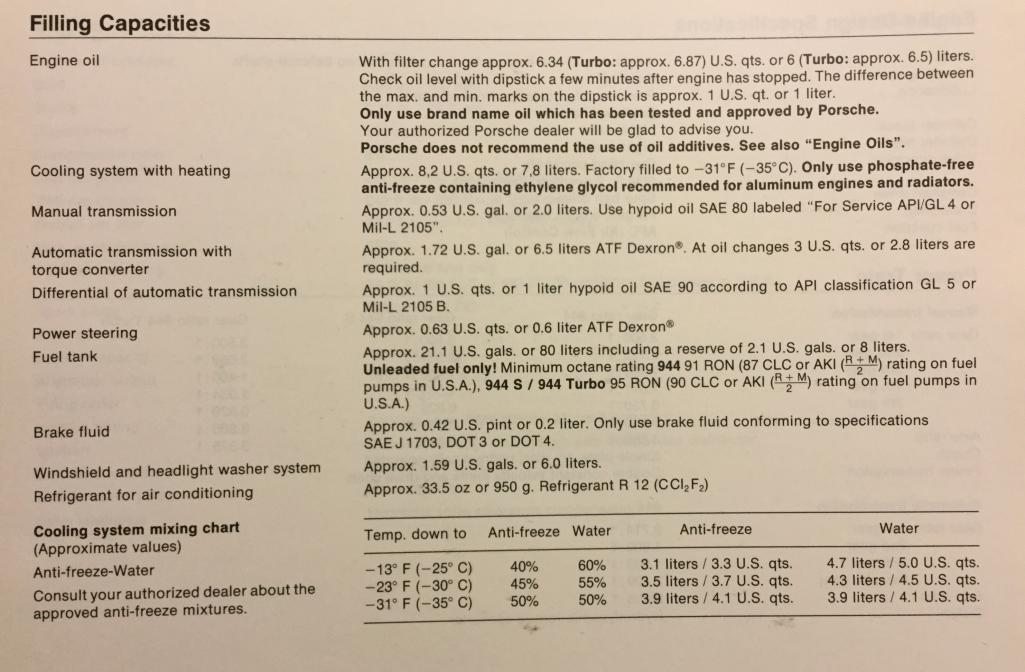

I checked my records and I added 6.25 Qts on my last oil & filter change. The owners manual says “approx” 6.87 qts with filter. Only a German would give an approximate oil capacity with 2 decimal places. Anyway 8 qts should be way too much oil for a stock engine. The dipstick in my car measures 20-3/4” from the edge of the plastic to the tip or 19-1/2” from the edge of the plastic to the bottom (low oil) notch.
