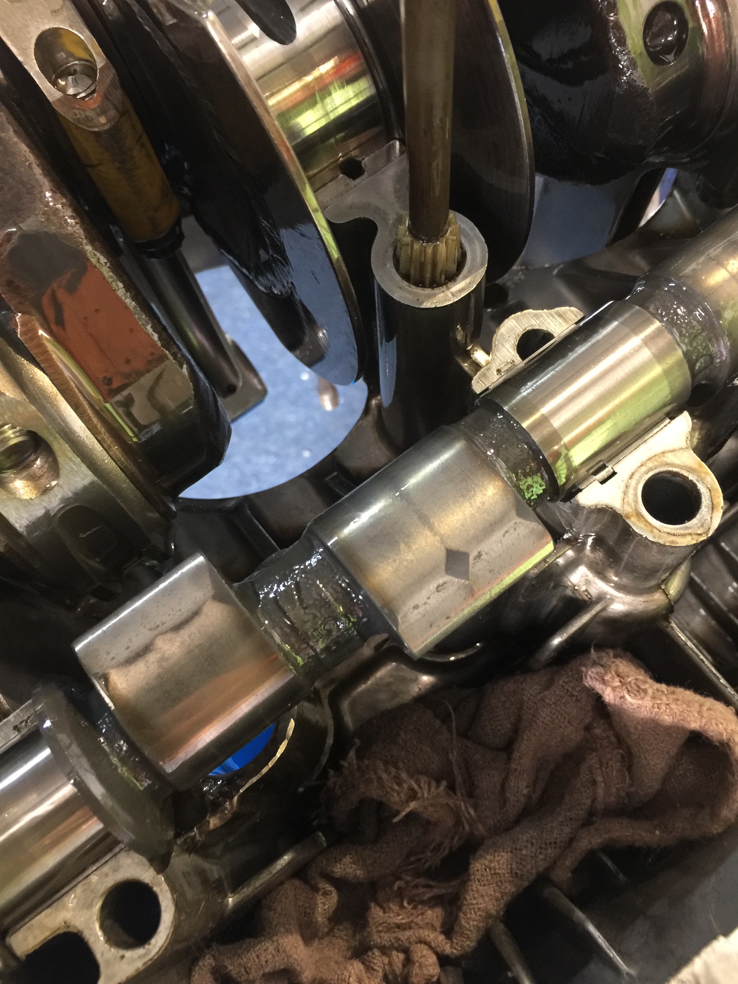

Jetsetsurfshop   Anyone have a picture of the camshaft after runnin...   Aug 24 2018, 10:15 AM
HAM Inc   Anyone have a picture of the camshaft after runni...   Aug 24 2018, 11:53 AM
euro911   Read this: https://www.dragzine.com/tech-stories/h...   Aug 24 2018, 11:05 AM
Jetsetsurfshop   I found a picture of my camshaft. Its just over a ...   Aug 24 2018, 12:20 PM
euro911   That could depend on a few factors ... What did ...   Aug 24 2018, 12:52 PM
ClayPerrine   The only time you should run 0 lash is when you ru...   Aug 24 2018, 01:07 PM
