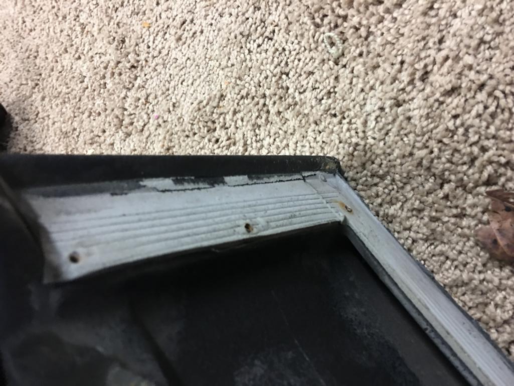

The ABM needs a new top. The prior one I had restored is early vs late. This time I’m going to do it myself.
I picked up a late top at the swap yesterday.
What are the 4 stages and products from wheeler dealer? I need to paint it for sure due to aging, scratches, dings and chips.

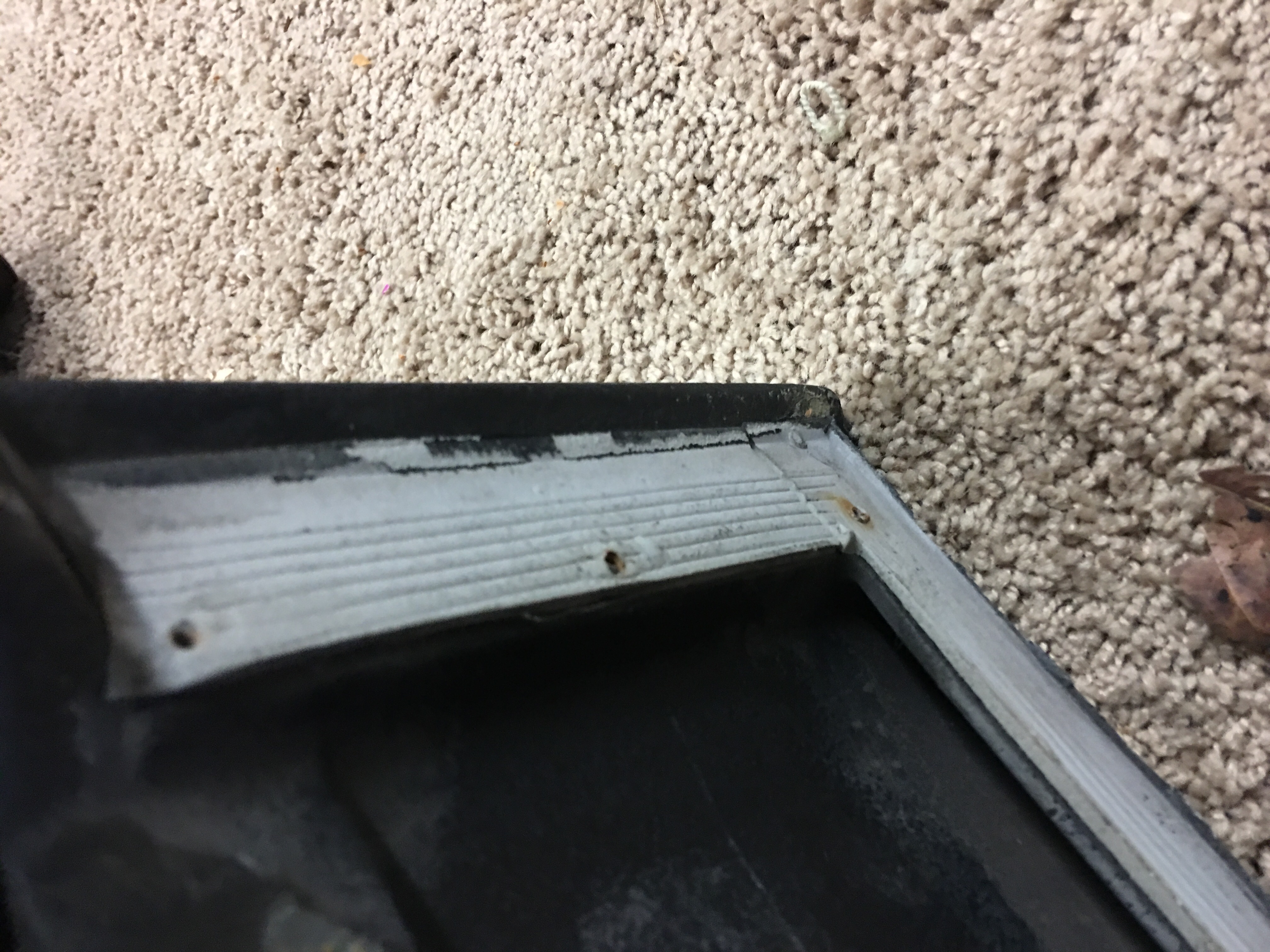

Also, what is this seal on the rear inside. It is chalky and old. Needs replacement.

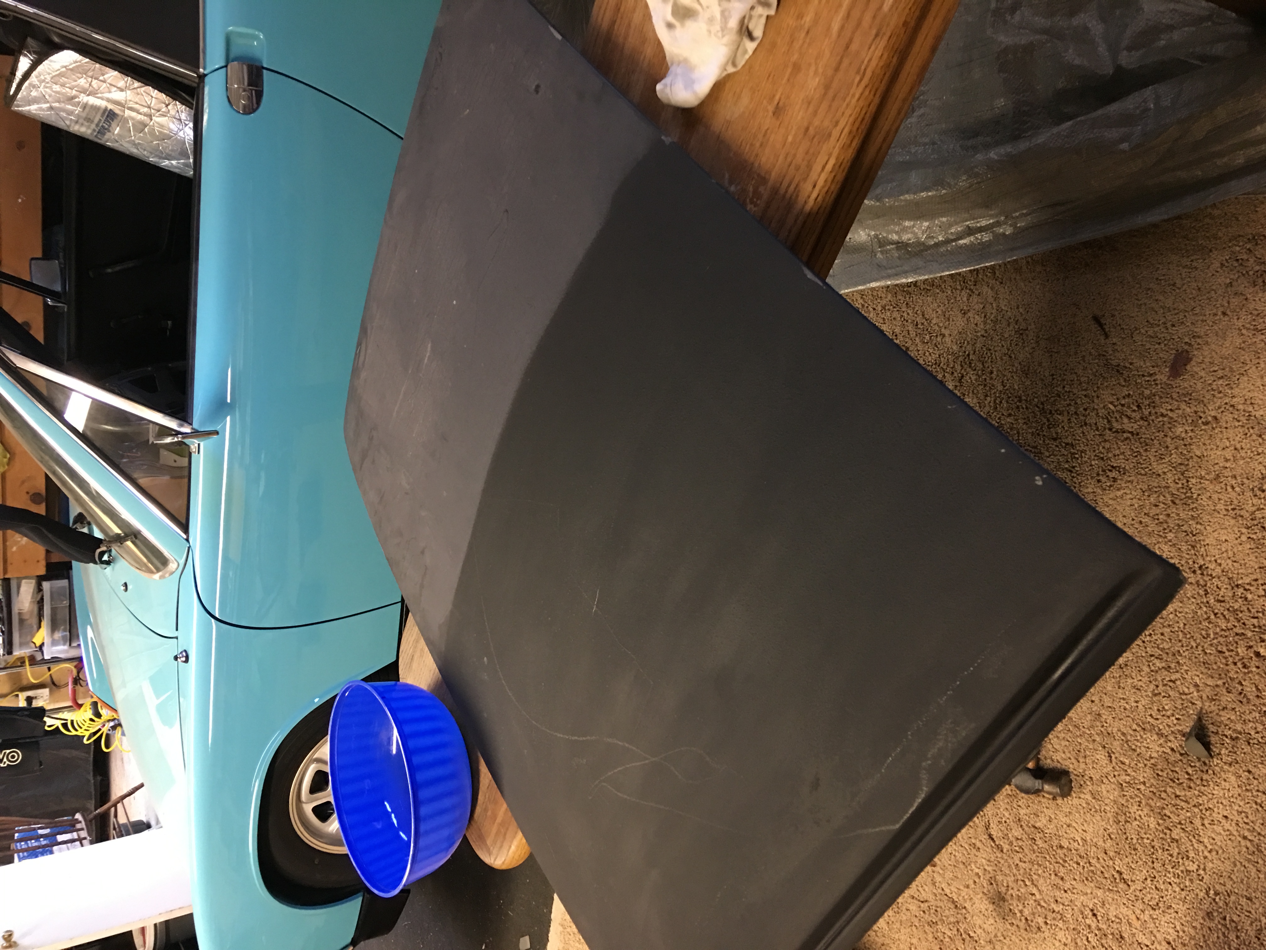

The top during cleaning. Lots of crap n crud.

Clean, clean, and clean again. Many years ago some guys were using black shoe polish. Not me though. I am guilty of Armorall though.
I've had a roof that I just couldn't get a good coat of paint, without problems. I personally hadn't Armorall'd that particular one, but I think it was probably shoe polish or silicone that had permeated the fiberglass. I bet I cleaned that thing 10 times with Prep-Sol and another 10 times with Klix, as well as several soap and water scrubbings.

I've wiped it with Simple Green 10 times so far. I finally got to the point where no more black stuff came up.

Its got about 20 points of chips, wear, and dings that I have to deal with to bring it back, but the corners are good! so I'm going to primer it, rubberize coat repair, prime again, and paint it. We will see.
I'm going to do a final acetone clean prior as well.

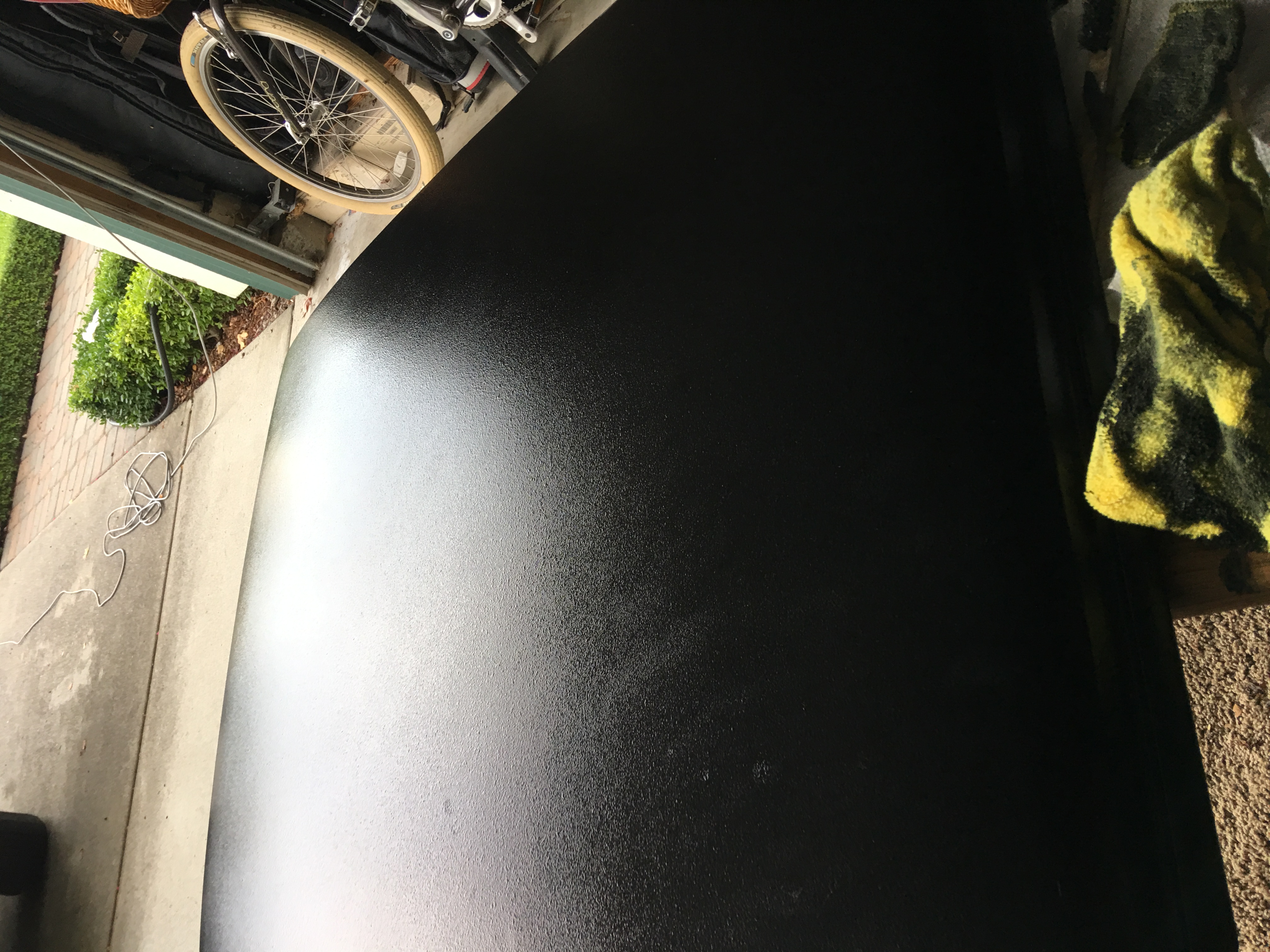

So you guys scared me out of painting it, so I ordered black rubberized spray, and forever black.....
Cleaned it thoroughly with simple green and acetone.
Thought I was a genius after 2 applications, but by applications 4-5 I had some awful streaking and swirls going on.
Tested some really old black chrome on it and got this....
