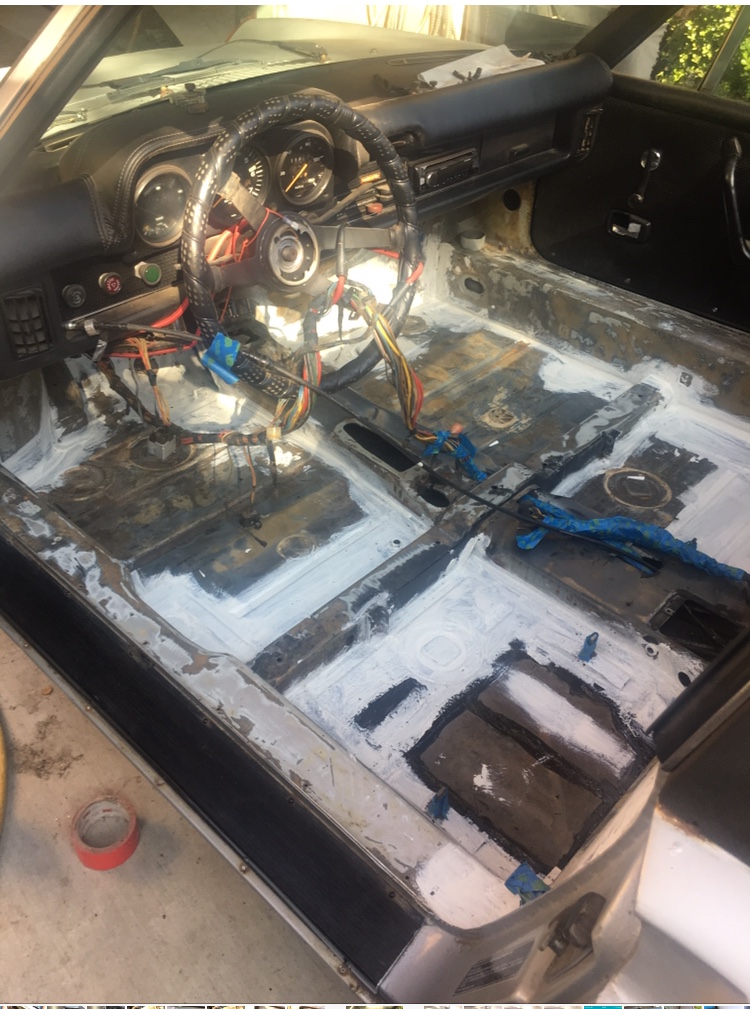

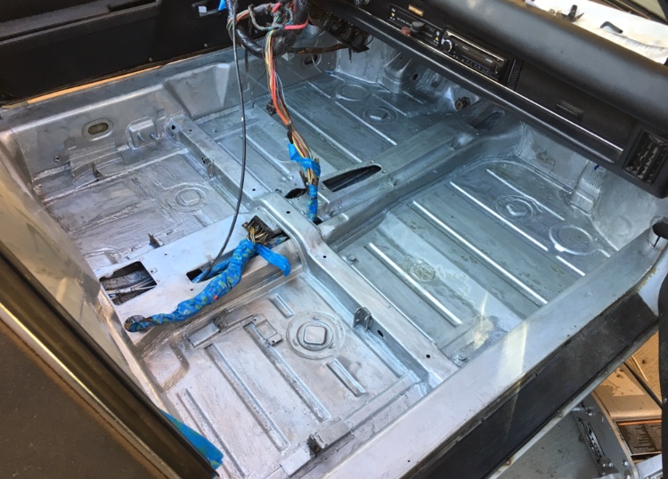

Removed the rust acid washed and use the POR15 on the floor pan. Cut out patched welded and use the POR15 in the hell hole. Figuring out what to do next? Do I put the old heat/sound insulation stuff back on and put contact cement on my beautiful paint job in the engine bay and back of seat? I have the old ones I pulled off. Using the 1975 technology for sound and hear versus new self stick items that Protect against both as well. New stuf Has to be better or at least the same? Also how bout I leave the engine insulation out all together and just use thick stuff behind seat. The old stuff , behind seat and engine bay my gether must weigh 60 pounds. Don’t really want to put the tar stuff back on the floor pan either as it took me a week to remove and seemed to trap water underneath.
I want this car to look and stay as oem as possible but it’s not going to Amelia island or pebble beach.
Thanks for all the input!
John Attached ImageAttached Image

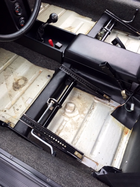

I recently cleaned my interior and was pleasantly surprised that the floors were in great shape.....I just vacuumed them and applied a coat of wax to the painted areas.

QUOTE(Cal @ Sep 14 2018, 10:31 AM) *
Looks amazing!
