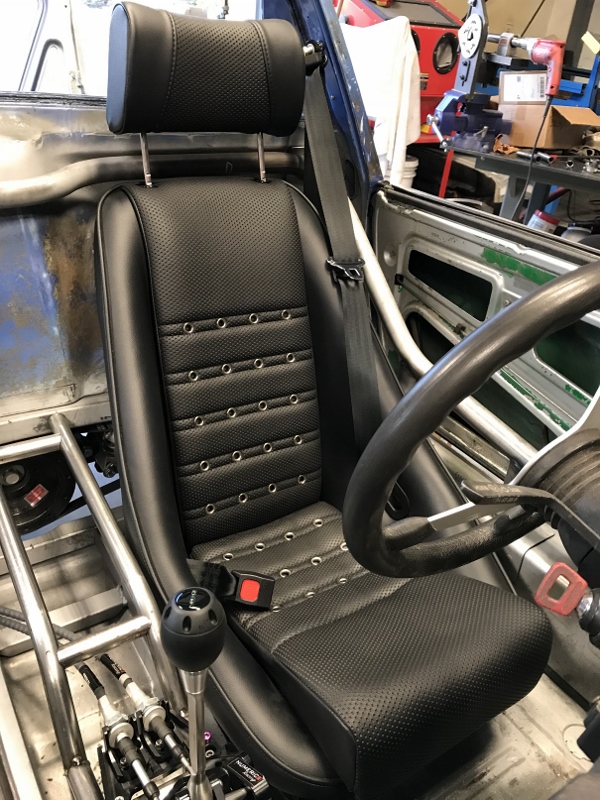

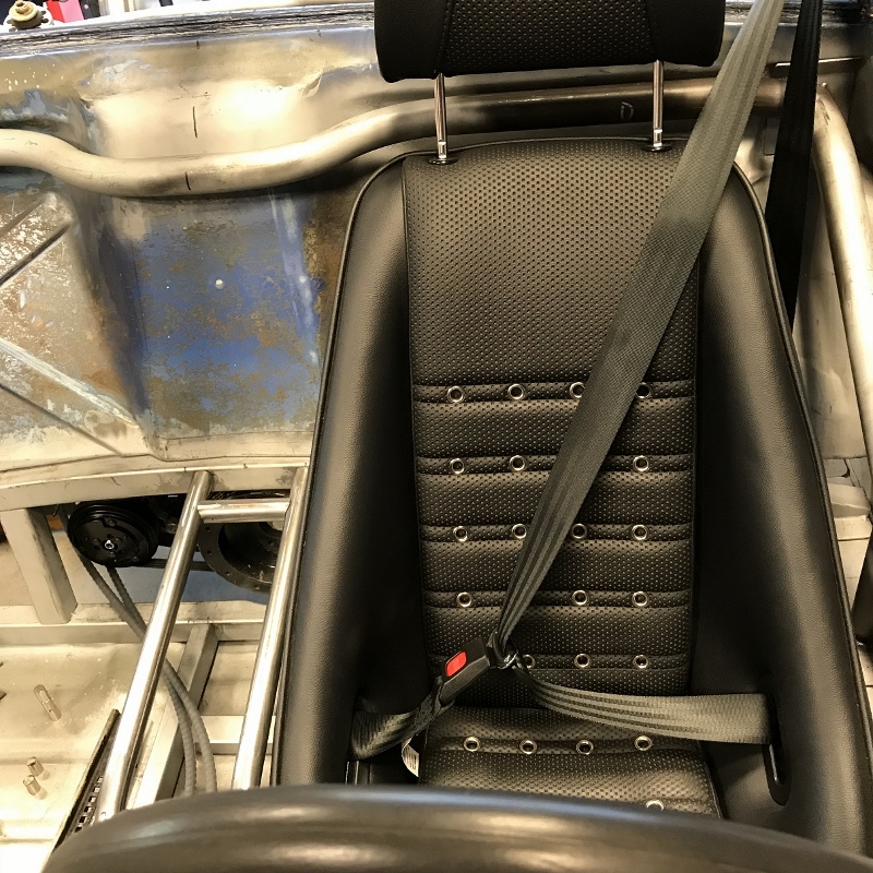

So I ordered new belts (from Seatbelt Planet) but specified belt, not the regular cable, on the female buckle end. I also went with a buckle that would pass through the seat openings so it's easier to take the seats out of the car.
Note that my retractor mounting location has been changed but I don't see why this wouldn't work for you.
PM me if you'd like to talk details.

Thanks, just what I wanted to hear!
