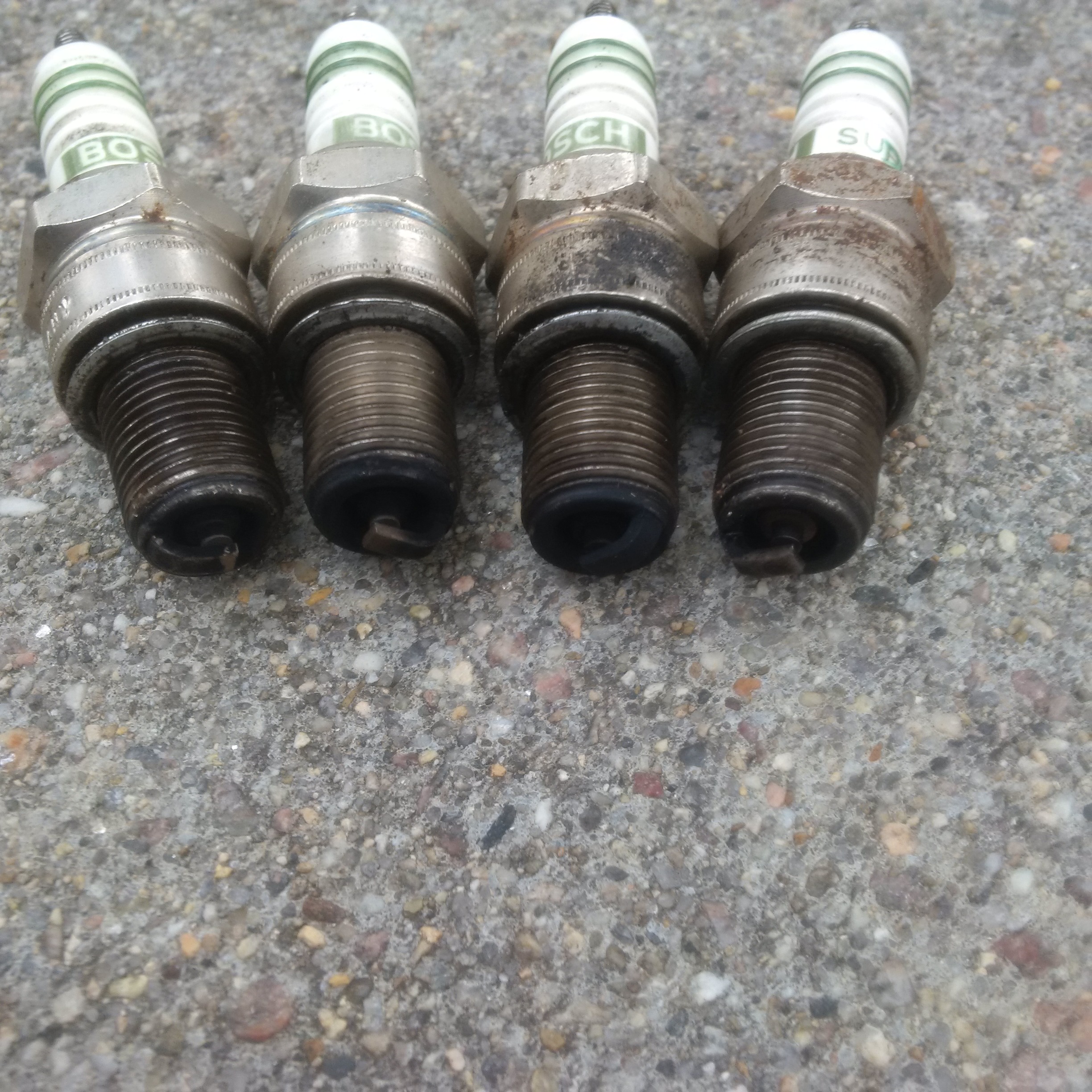

UPDATE
Today I changed the plugs with new ones. Here is what happened. The car started and ran clear and crips for about 10 minutes. THough, while it ran it smelled very rich.
About at 10 min the car started to miss a bit and then started to smoke. I looked at the old plugs and now I have a hypothesis.
My guess is that all of the cylinders are running rich but one is running extra rich or the injector is being held open. THis is flooding the cylinder and then the smoke is the un burnt fuel going out of the pipes.
Here are the plugs I pulled out, all of them are rich, one was wet and very rich...None had any oil.
Will update again tomorrow.
CTC
