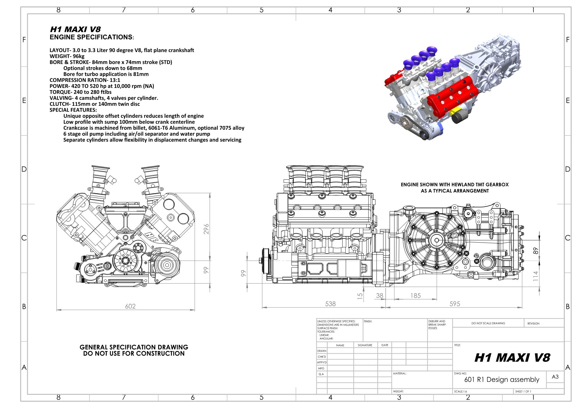

One of these Hayabusa motors would be a ton of fun!!!
http://www.h1v8.com/maxi-v8---specs.html

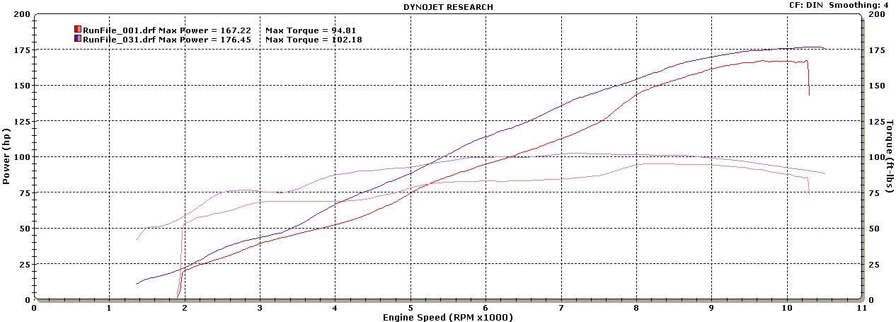

Interesting. According to one dyno graph I've seen, the torque rating of the 'Busa engine is 50 lb-ft at 2000 RPM. That's not too bad, actually!
(IMG:http://www.914world.com/bbs2/uploads_offsite/www.superbike.co.uk-121-1538782701.1.jpg)
--DD

QUOTE(Mike Bellis @ Oct 5 2018, 04:18 PM) *
Your the man , beat me to it
