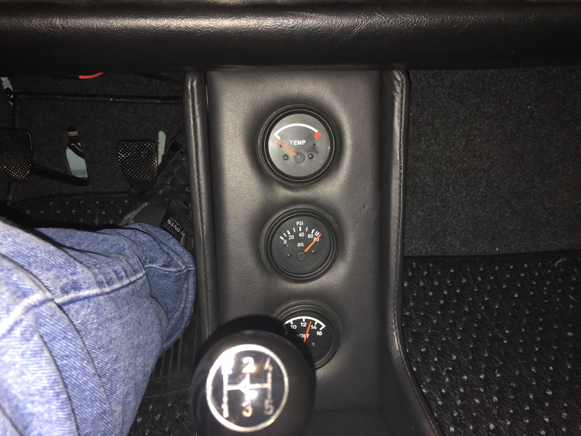

I recall reading about a dipstick that reads the temperature. I have a new gauge in the car and it would like to know what I'm actually running. If you have one I can borrow, that would be even better

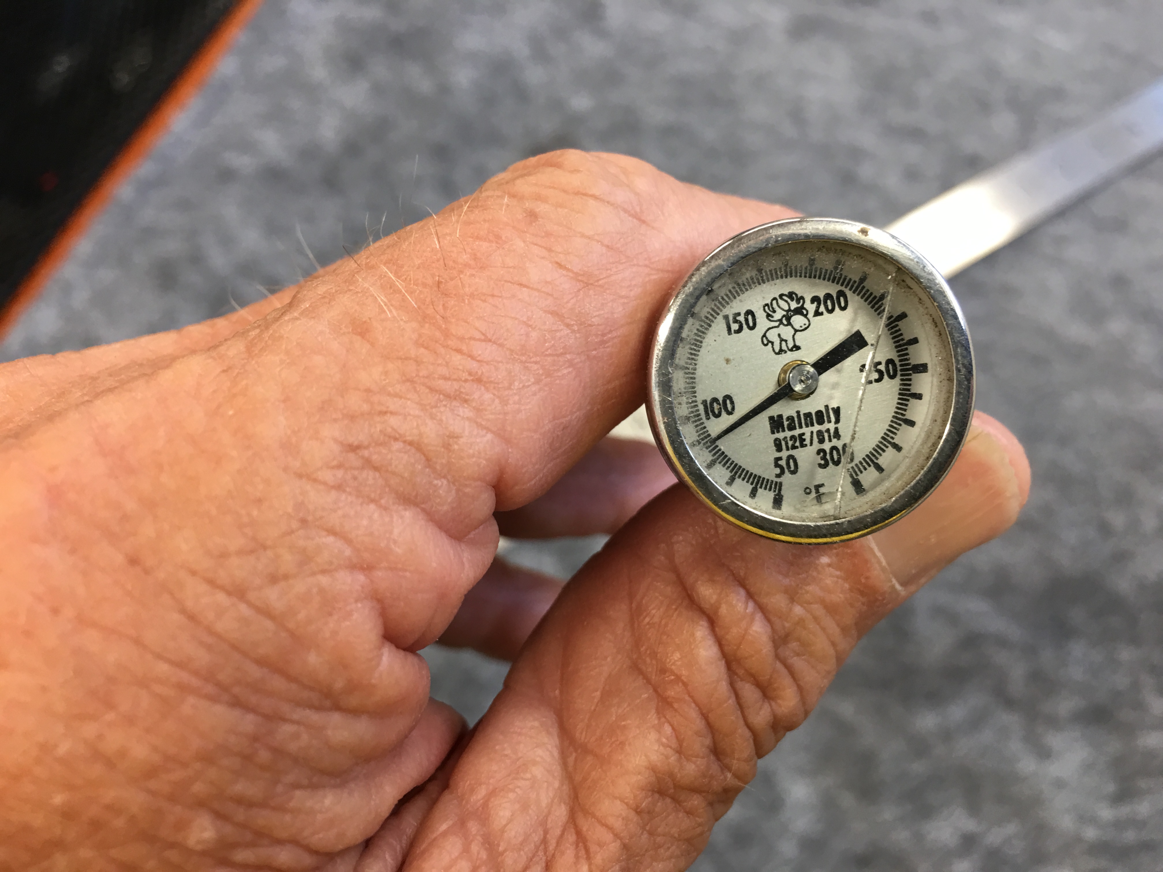

I seem to recall when I got mine in 2014 it was the last run and he was only making them for 912s and 356s. But someone organized a group buy for 20...
Edit: maybe someone can organize that again? I'd buy another one for the race car.
http://www.914world.com/bbs2/index.php?showtopic=241854

Originsal face size:
jim_hoyland
post Oct 29 2018, 12:55 PM
Get that VIN ?
Posts: 10,035
Joined: 1-May 03
From: Sunset Beach, CA
Member No.: 643
Preferred size:

I don't think the temp of the oil in the tank would be very useful data.
Since you already have what appears to be a temp gauge installed I will assume it's working but you are looking to get an idea oh what temp in relation to position on gauge.
A easier solution is to buy an IR thermometer and go for a drive, when the gauge shows half way, pull over use the laser pointer on the sump and record a temp. do that for the known needle sweep of your gauge and you now know what temp your car is running.

I have a dipstick one from the last run.
As much as like the idea, the gauge lost it's calibration pretty quickly (way off) so now I have just a pretty dipstick that tells me that my cold engine is at 375F.
I have no idea how to recalibrate it. I think I only need to rotate the dial but don't know how. If someone knows how, please share.

Usually the back of the gauge has a formed hex nut as part of the housing. Put a wrench on it and then with your other hand turn the temp gauge bezel/glass. Not sure what to use as a calibration medium but boiling water at 212 deg. F comes to mind. Not sure what the gauge face reads so not sure boiling water would work.

Thanks. I think that did the trick. Not sure how it happened so the credibility of the measurements will always be questionable though.

Could happen a few ways. But probably most common would be a twisting motion of the dipstick face while pulling the dipstick.
These are neat features to have but I agree that they’re highly susceptible to being waaayyyy wrong.

Before digital we used to use ice water (with ice in it) for 32F or steam (boil water and have thermometer set up in the steam not water) for 212F at sea level to calibrate our thermometers. Yes a twisting motion could change the setting so get used to pulling straight up.
