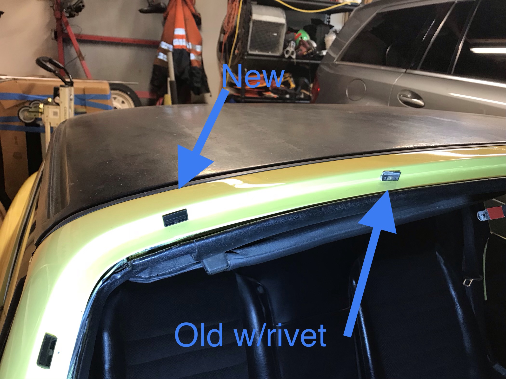

Earlier I lost one of the new clips, took and old one and installed it with a pop-rivet.
