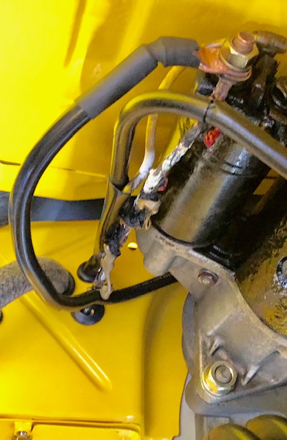

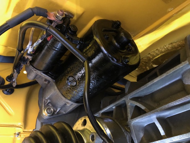

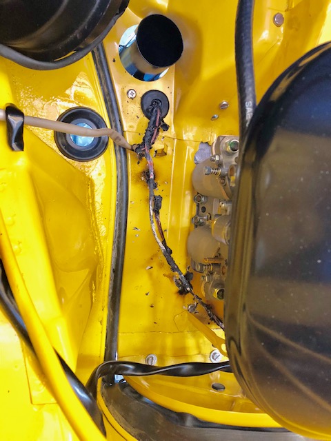

So the good news is that I managed to get the new engine started today. She fired right up after a crank or two and ran great!! First time in 2 years...
Then, I noticed the alternator light was on -RED. Then I noticed a bunch of smoke from the engine bay. Turned her off and...The red wire from the starter to the alternator was red hot and burning...it burnt all the way to the alternator from the starter.......
The battery was also making strange noises....and was very warm
When I got the engine the harness was already connected. I connected the longer end to the starter. and also plugged it in to the relay board
Sounds like something wasn't connected right? Perhaps the red wire wasn't connected correctly to the alternator?

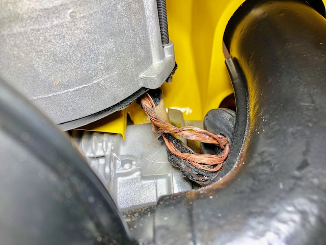

simonjb   So I managed to get the alternator out.. As you ...   Nov 5 2018, 05:53 PM
mepstein   We take our starters and alternators to a local ba...   Nov 5 2018, 05:56 PM
simonjb   perhaps this is what happened ? Its the washer tha...   Nov 5 2018, 06:03 PM
Spoke   How does that 2nd stud compare with a stock 914 al...   Nov 5 2018, 07:17 PM
dlee6204   I’ve also seen it before on a rebuilt unit where...   Nov 6 2018, 06:23 AM
simonjb   So it looks like the post was not too high - rathe...   Nov 6 2018, 10:50 AM
simonjb   Here is the solution...cut the edge off the washer...   Nov 6 2018, 10:52 AM
