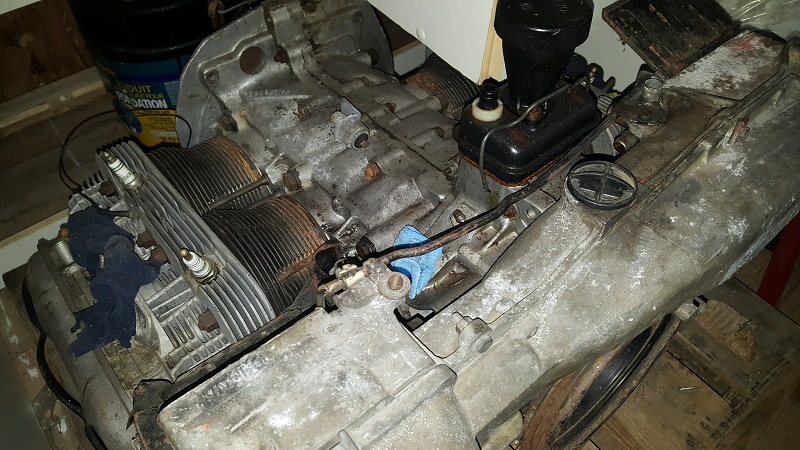

My mid-life crisis 914 has a very tired 1.8, that I was planning on rebuilding to a 2056. With that in mind, I purchased a 1.7 with unknown history that I was planning on putting in the car while rebuilding the 1.8.
The 1.7 came from an uncompleted project car, and has heads that look suspiciously clean from the outside. I am now wondering if there's a chance that somebody has already rebuilt this engine into something better than a stock 1.7.
So... should I take the 1.7 apart to some degree to inspect, or just throw it into the car and run it per my original plan?
Here's the 1.7:

I can say with 100% confidence that your engine case was opened, just from looking at the color of the sealant.

I decided I might as well at least take off one of the heads. No use building up my other engine on the off chance that this one has already been upgraded.
Starting with the serial numbers, what do these indicate?
jcd914
post Nov 27 2018, 10:01 AM
Posts: 2,098
Joined: 7-February 08
From: Sacramento, CA
Member No.: 8,684
The EA engine code means it started out as a 72 or 73 1.7L with F-jet.
Good starting point for a build, good case with the windage tray.
You won't know condition or engine size until you open it up.
Jim
