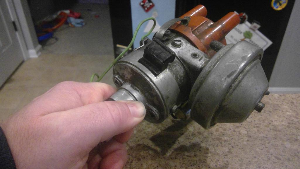

Tested the coil and am getting a strong white spark. Point gaps are perfect at 0.016. Starting to suspect the distributor. I found this distributor in some parts that the previous owner gave me, so it should work. (Whatt the big silver thing on the side for?)
So, if I understand correctly how to replace the distributor, I just need to :
1. Put it at TDC
2. loosen the adjustment bolt
3. Rotate it to get to the 13mm removal bolt.
4. REmove.
5. Put in new distributor with rotor in same direction as one that I took out.
Any tricks here. I read something about a spring that could fall down in the engine? Is that on the distributor shaft, or is that below the gear shaft?
Basically, my only hesitation is doing something stupid, unknowingly, and having something fall into the engine.
Thanks

The item on the side of the distributor is the vacuum advance can. I doubt that the distributor is causing your issue. Going back to your first video, the engine turns over strong then chugs. It revs to about 3k RPM before dying. Nothing in the distributor would cause that except points.

QUOTE(ericoneal @ Dec 9 2018, 09:36 AM) *
1. Put it at TDC
4. REmove.
Thanks
Hi,
1. TDC on #1
2. yes
3. yes
4. rotor is keyed should point to close to index when installed.
5. I'd eyeball the distributor drive gar to confirm it is correctly indexed.
6. That a vacuum advance/retard can. do your carbs, hve ported vacum? it will work withit it hooked up.
Yes I lost the spring on the distributor. I had my son working on my 27- build when he was about 10. He dropped and it fell to the ottom of the case. Disassembled/reassemblemed motor. Have a pick in hand to tr\p the spring if you have to noodle with the gear. It's not likely unless this engine ran a Unilite with vacuum.
You are so close.
