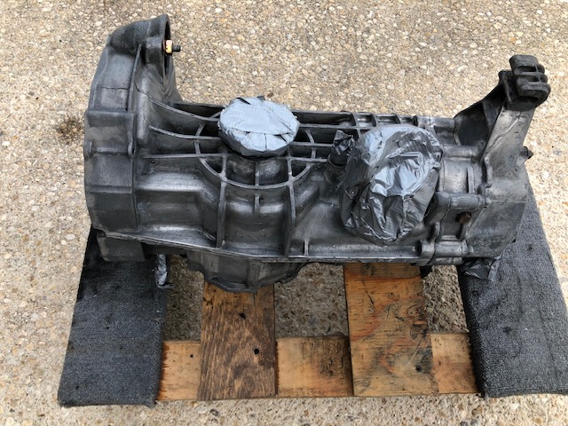

I recently had the fan housing cerakoted and now I want to do the transmission. On the fan housing I removed all the grease and oil and the shop that applied the cerakote blasted it withe 200 grit aluminium oxide in a cabinet and it came out great.
I will get all the grease and oil off the transmission, but the blasting will be done with 100 grit aluminum oxide outside of a cabinet. I believe I have protected everything but was a little concerned about 100 grit being to course. ![]() |

mepstein I would only soda blast unless you intend to overh... Nov 28 2018, 08:58 PM
rstover
I would only soda blast unless you intend to over... Nov 28 2018, 09:11 PM
wes I cleaned mine up getting rid of all the oily mess... Nov 28 2018, 09:08 PM
IronHillRestorations I've only used crushed walnut shells for whole... Nov 28 2018, 09:12 PM
rstover
I've only used crushed walnut shells for whol... Nov 28 2018, 09:46 PM
mepstein Dry ice would be another way to go but I wouldn’... Nov 29 2018, 06:53 AM
toolguy I wouldn't use sand. . I doubt that any tape ... Nov 29 2018, 09:44 AM
ValcoOscar
I wouldn't use sand. . I doubt that any tape... Nov 29 2018, 10:37 AM
Dr Evil
I wouldn't use sand. . I doubt that any tape... Nov 29 2018, 01:48 PM
brant I agree with all of the above comments
to the OP
... Nov 29 2018, 10:18 AM
rstover Thanks for all the responses. I have spent about ... Nov 29 2018, 06:48 PM
cary We do quite a few gear boxes at Rothsport. 1 to 2 ... Nov 29 2018, 11:02 PM![]() ![]() |
