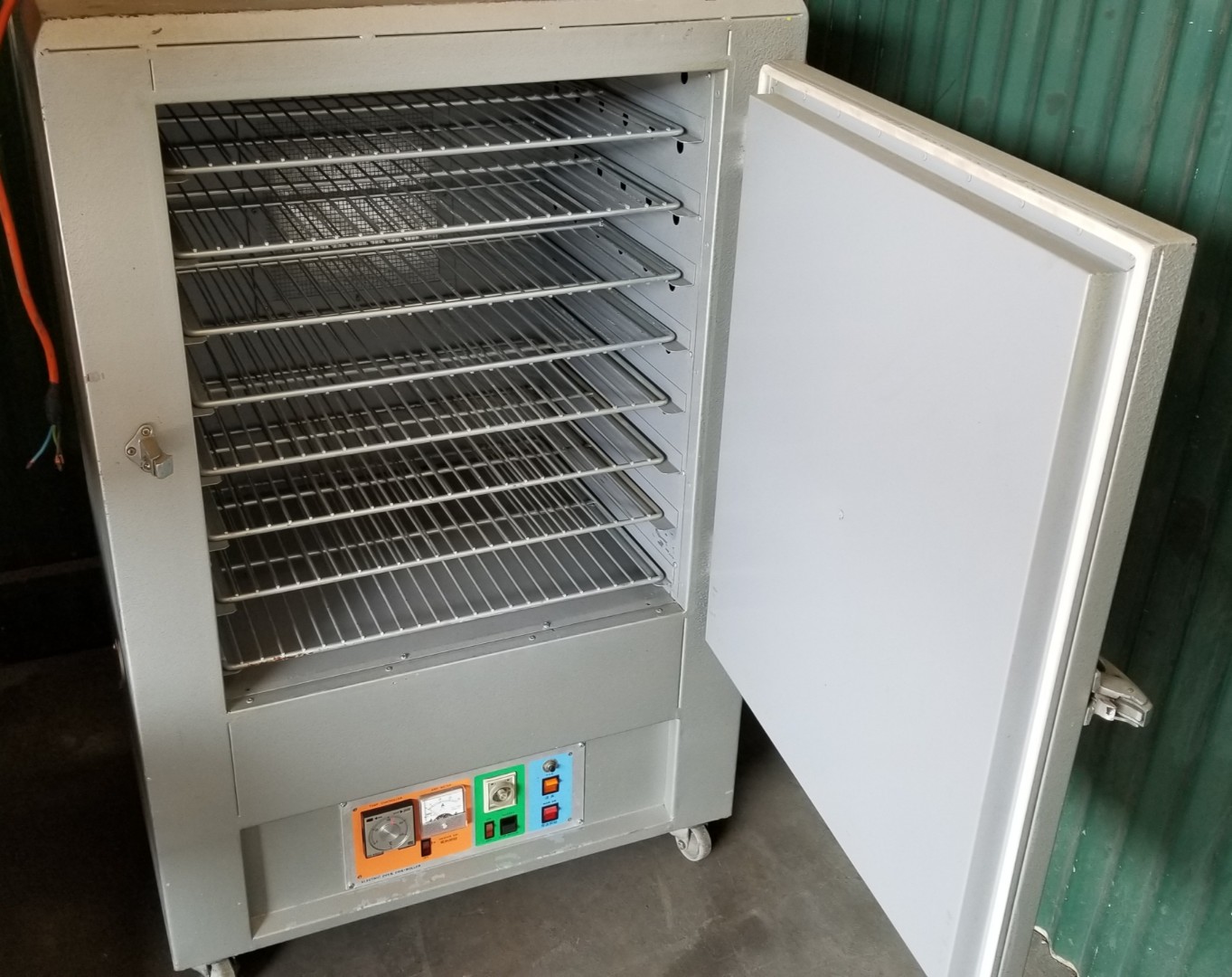

Well, after getting quotes on powder coating three sets of rims and misc suspension components I've decided to do my own powder coating. I've seen lots of YouTube videos but wanted some feedback from someone already doing this. Please share any tips.
My oven is 20 W x 24 D x 30 H so I'm thinking going with dual voltage Eastwood gun set up.
If I get decent at this, perhaps we can have a SoCal powder coating tech day in the near future. Any interest? (IMG:style_emoticons/default/idea.gif)

mepstein   We do a lot at our shop. It's very easy to mak...   Dec 12 2018, 04:07 PM

burton73   Oscar, I have used Blue M Ovens at my plastic fac...   Dec 12 2018, 04:53 PM
ValcoOscar   Oscar, I have used Blue M Ovens at my plastic fa...   Dec 12 2018, 05:06 PM

infraredcalvin   Until you want to throw a sway bar or valence in t...   Dec 12 2018, 05:20 PM
914forme   :agree: I still have my toaster. Always look at t...   Dec 13 2018, 08:29 AM

infraredcalvin   Oscar, some of that orange peel may be from too lo...   Jan 17 2019, 11:44 PM
mepstein   We usually pre heat the larger items.   Jan 18 2019, 07:23 AM
