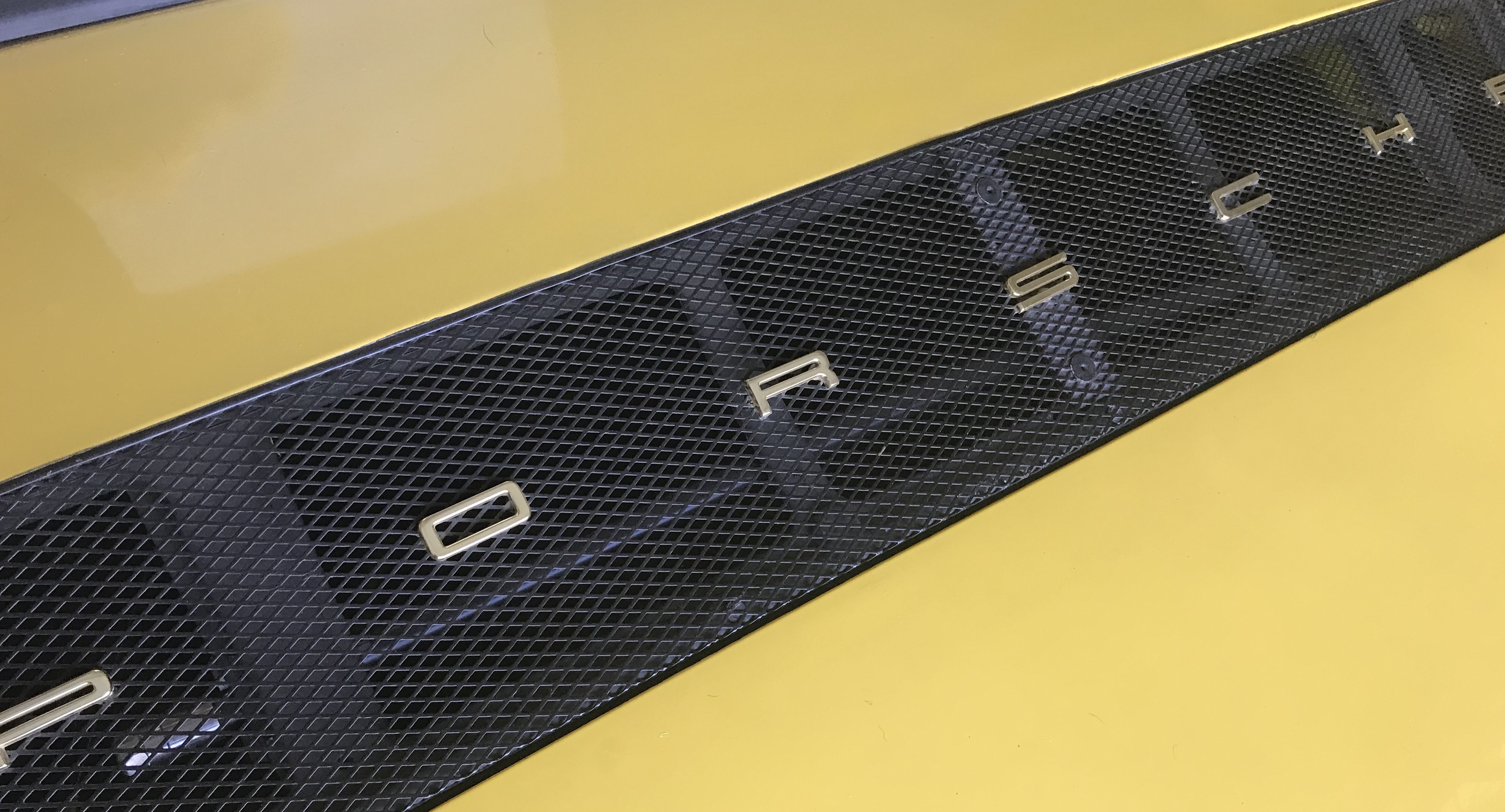

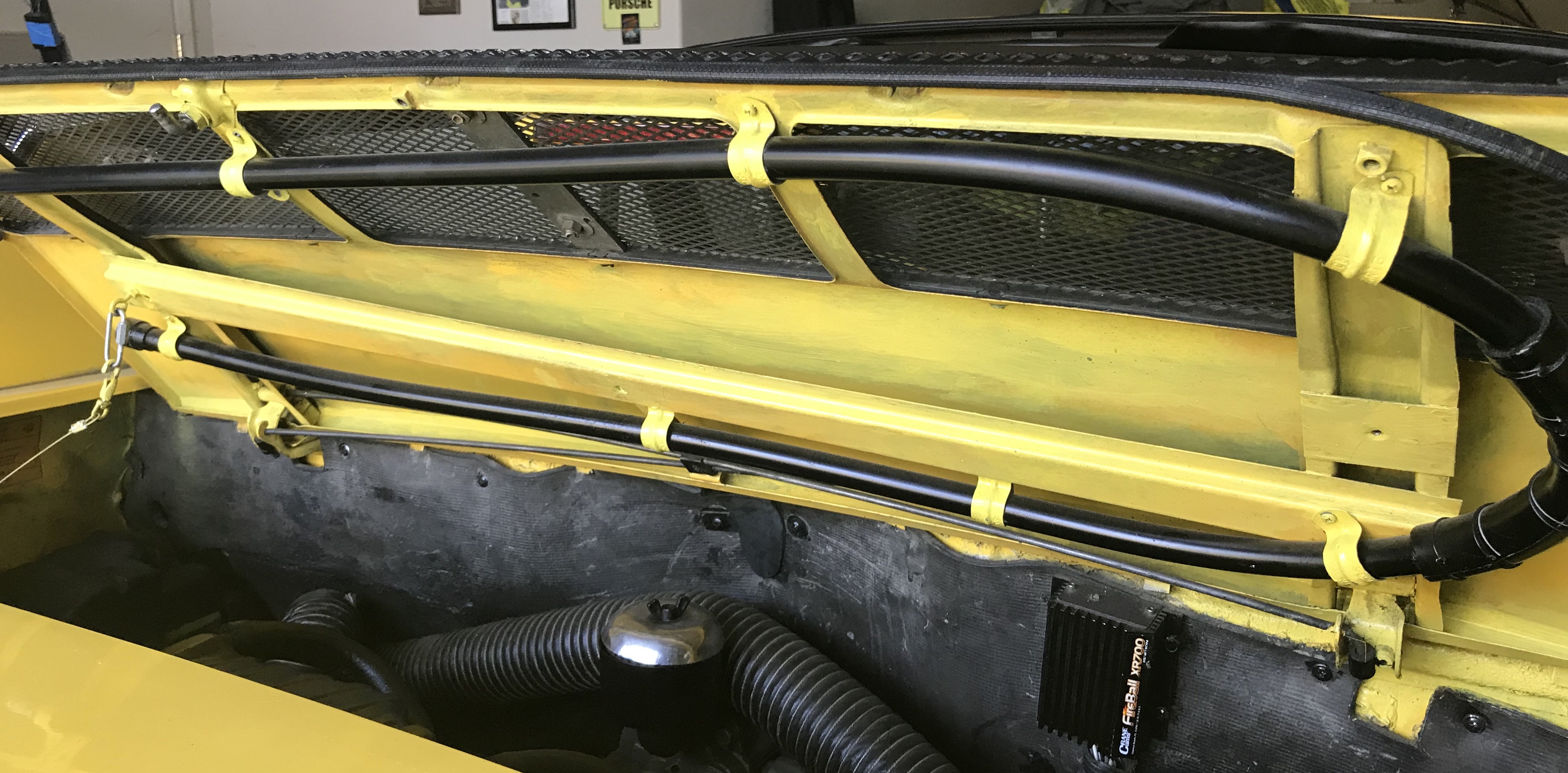

Here's my fire solution(s). I have a BlazeCut system installed under the lid. I do not use a rain tray since I NEVER drive in the wet. I painted the BlazeCut tube black so that it does not show through the engine cover. You might also notice the engine deck lid steel cable restraint on the left side so that when I pop the lid, the hinges aren't slammed and worked until breakage ensues.

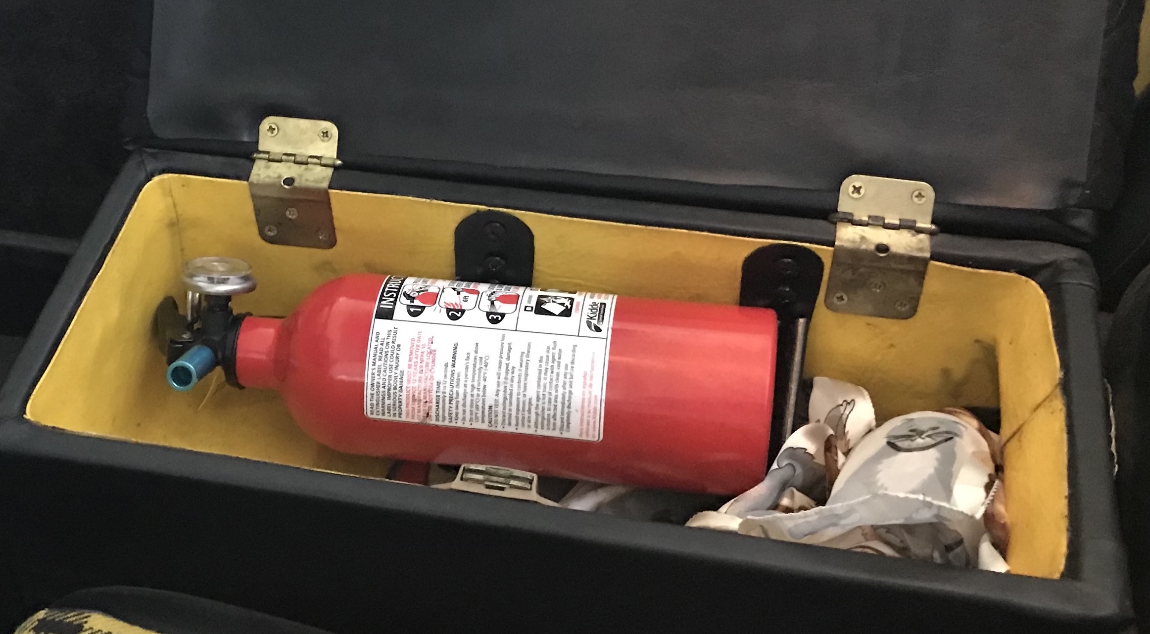

And just in case I have a cabin fire, I have a Kidde extinguisher inside my custom built center console box..... (IMG:style_emoticons/default/piratenanner.gif)

Kinda ironic you have a Crane "FireBall" right under your Blaze-Cut.

Don’t you believe in ying and yang?? (IMG:style_emoticons/default/grouphug.gif)

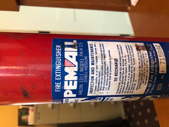

Sir Greg @coondog ,
this is from your car and do u still have the same size on your car now? Like Jeffrey is asking, is 2.5lbs enough or is there any smaller that will fit under the 914 passenger seat?

Greg, How about this PEMALL HALON 1211 PA-H 2.5. It is a liquified gas type extinguisher?

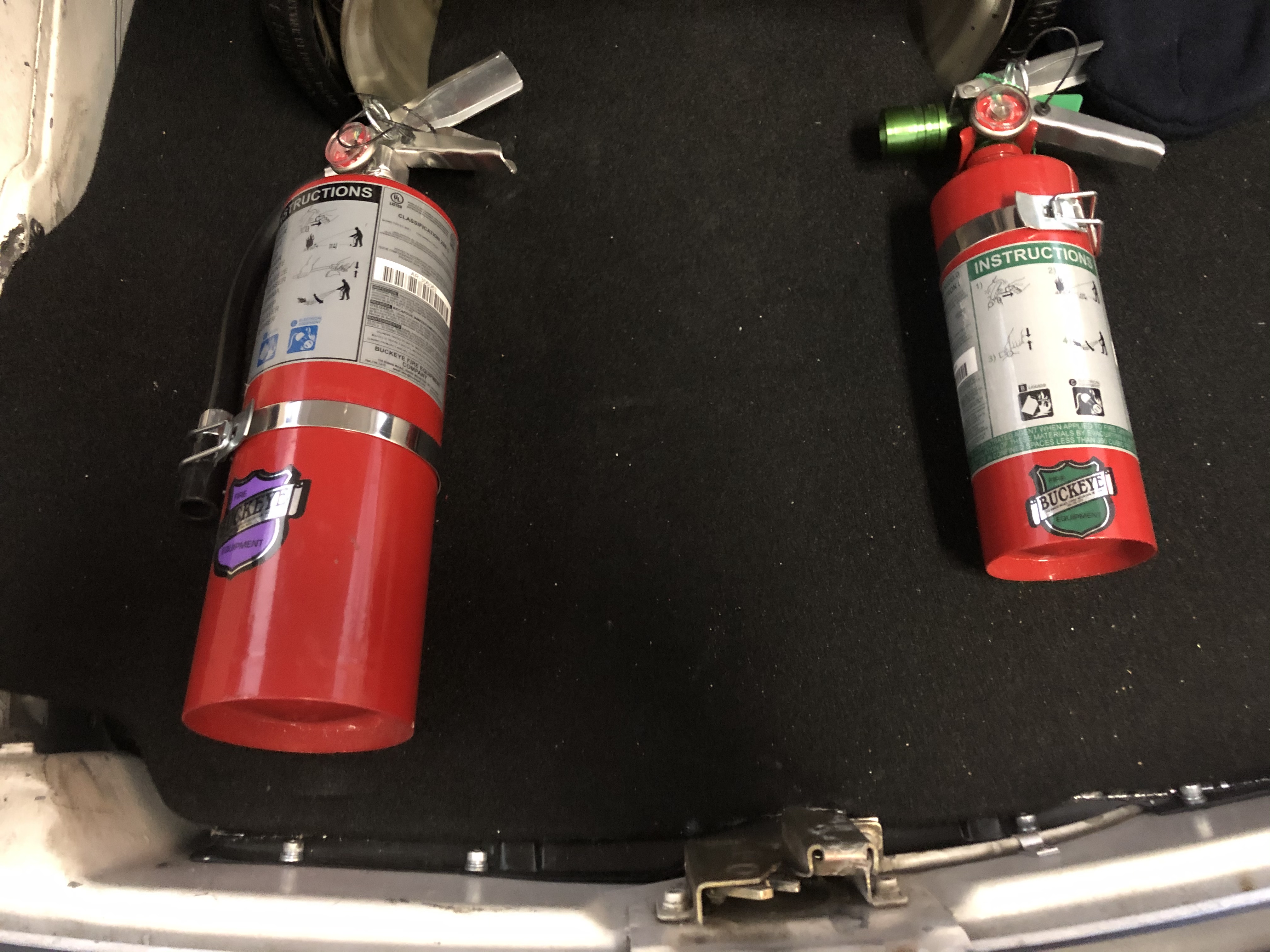

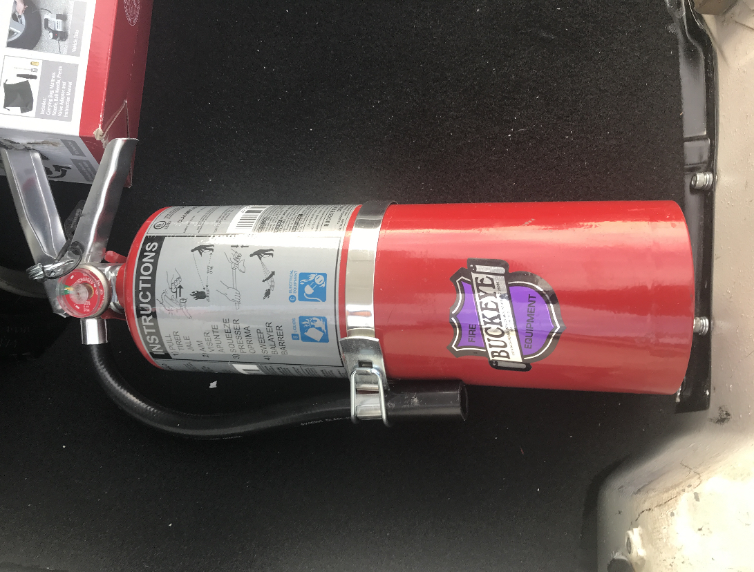

Here is my current set up Purple K 20 B-C. Halotron 2.5 B-C
Going by pounds is not accurate. The number for a B or C fire extinguisher tells you how many square feet it will put out. For a A the number means gallons equivalent to water.
2A 10BC Two gallons of water for a type A fire. 10 BC 10 square feet. It’s the B C rating that’s important to us due to fuel fires. Purple K is the best for fuel and metal fires. The halotron for electrical fires. Amazon sells both.
Great for electrical fires not so much for gasoline. Get a a Purple K and put both in your car. Gasoline travels under the engine tins so while your trying to put out the upper engine fire it’s still running underneath the car. This is why I don’t like those stick fire extinguishers as it doesn’t allow you to get close enough to put out fire under the tins.
