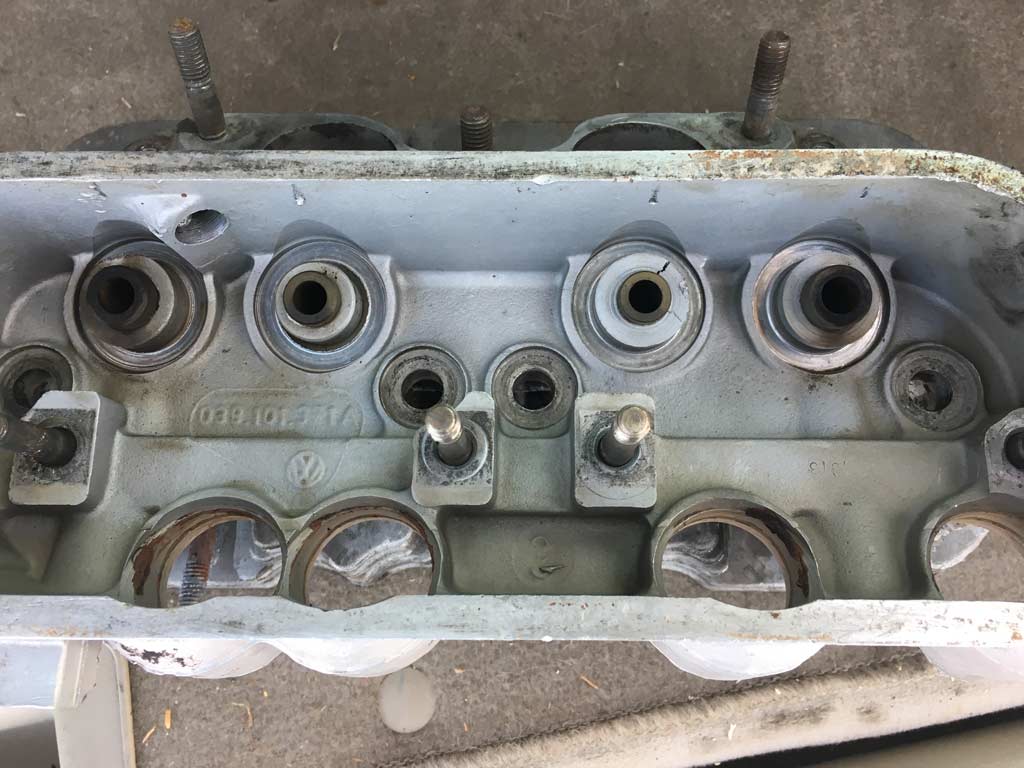

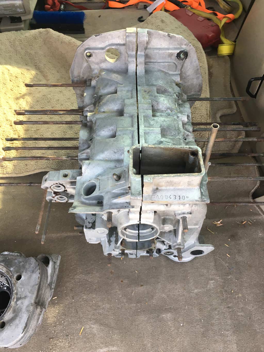

Finally got a call from the machine shop that was cleaning my case and seeing if they could polish out the crank that was already 0.010" undersize.
The case turned out nice but will still need lots of love. This engine had massive rust in the sump. All galley plugs will need to be pulled so that the ends of the galleys can be cleaned to ensure there isn't a nice little pile of rust at the dead end just waiting to come out inside a freshly rebuilt engine.

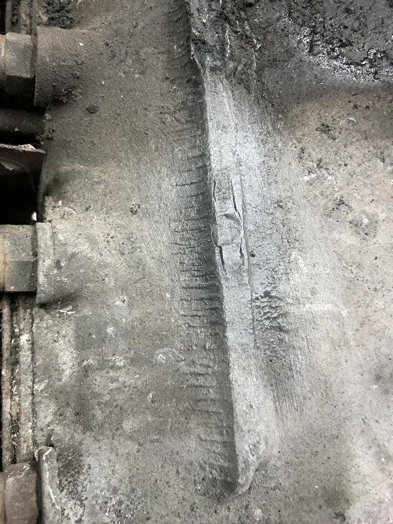

There will also be machine work to deck the piston seats lightly, and the oil pressure sensor hole is stripped and will need to be re-tapped.
Now for the bad news. One cylinder is cracked at the boss for the valve guide. Likely a result of prior poor workmanship. I can see evidence of the valve guide having been replaced previously. (IMG:style_emoticons/default/headbang.gif)
I'm undecided on next steps for this head. I hate to toss a 2.0L head. May weld it but that will be down the road since it will involve lots of work to weld it and then to re-machine the valve guide boss properly. I will probably bead blast it just to see if there are other cracks in the combustion chamber to help seal the deal.
Ah . . . the joy of restoring 40+ year old cars. (IMG:style_emoticons/default/icon8.gif)

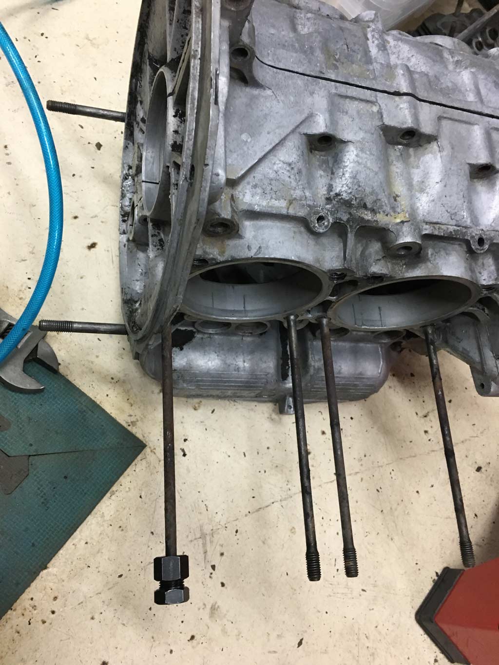

Tool Of The Day Post.
I've been working to get my original case ready for some machine work.
Needed to pull the cylinder head studs.
I love these stud installers & extractors from Snap-On.
I know this can be done by jamming nuts together and hoping for the best. I did that for a lot of years when I was broke.
These collet type extractors make the job a pleasure rather than a pain. No risk of galling threads. Work the first time, every time.

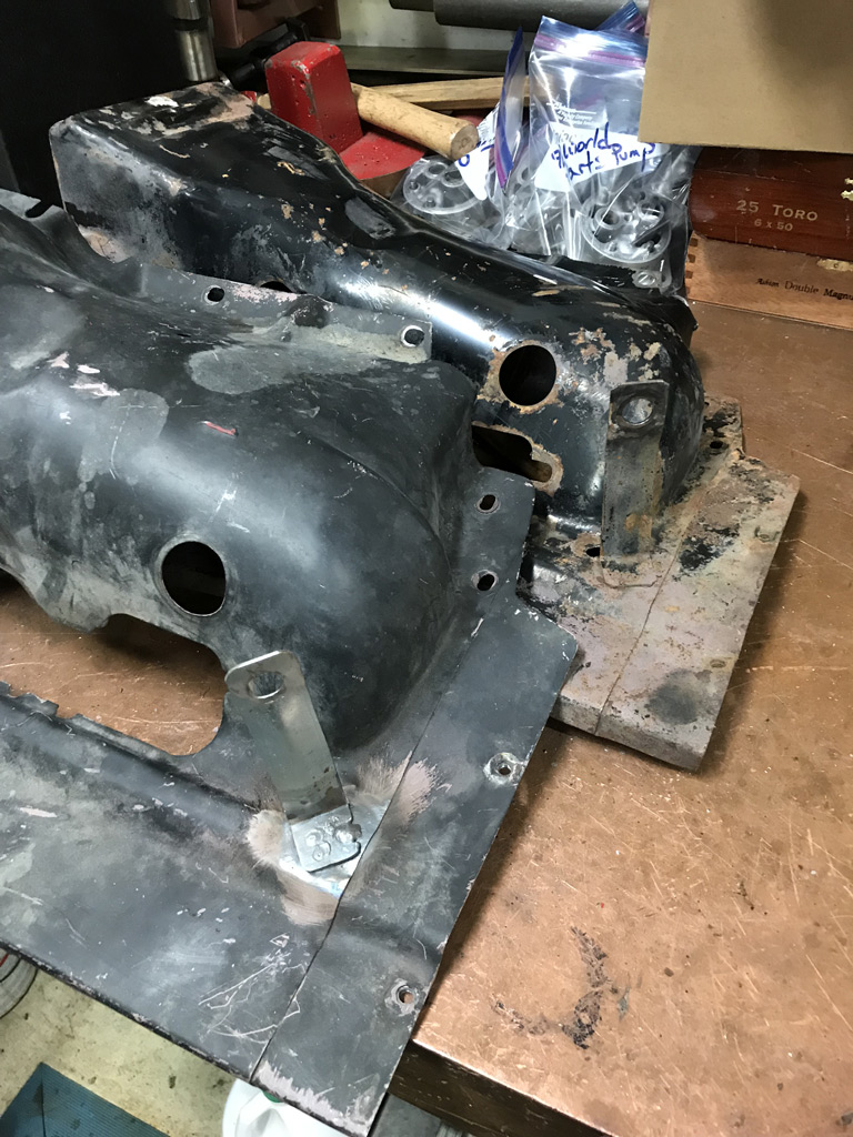

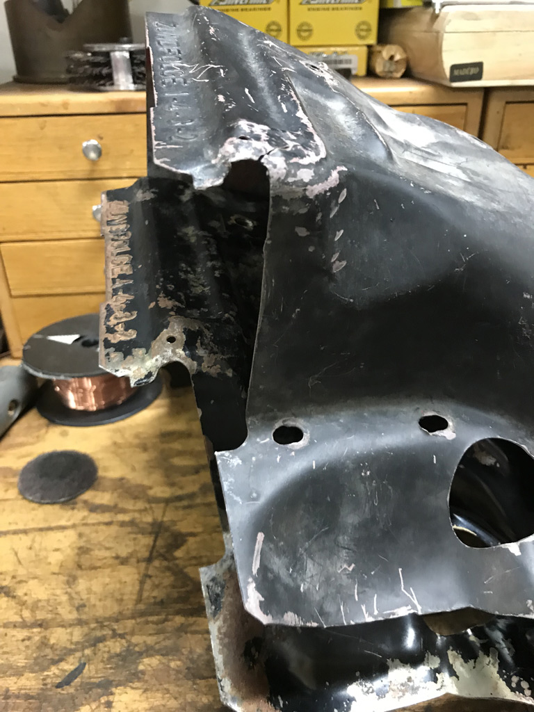

Well it's been a while since I posted to this thread. Chassis work is on hold due to the Melanoma surgery stuff, but I'm still plugging away at the small stuff I can do without stressing my shoulder.
The engine that came out of this vehicle is GA004310. Whoever had this engine had a knack for screwing things up. (IMG:style_emoticons/default/mad.gif)

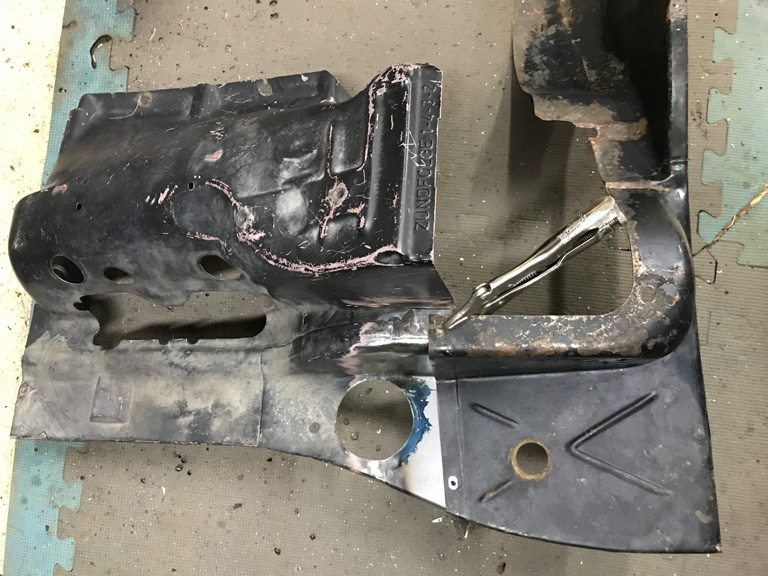

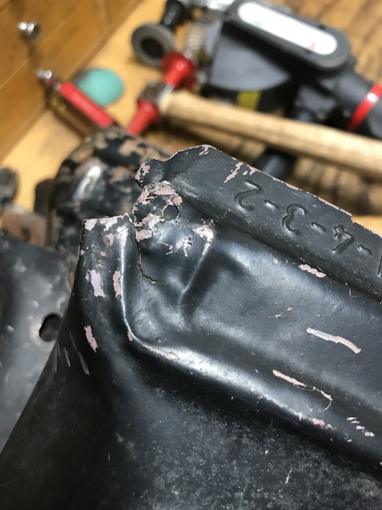

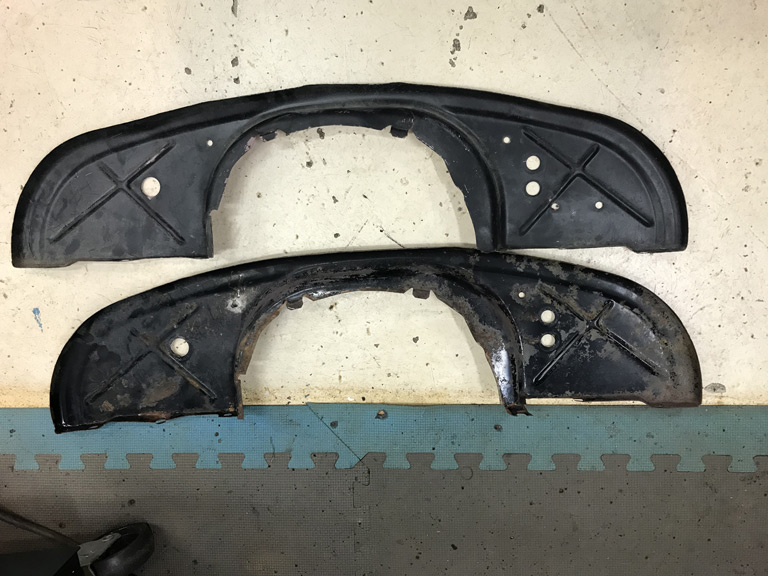

The flaps were removed from this car and the engine tin is sort of mangled on the passenger side tin at the corner where the flap rod passes through.
In anticipation of having tin sent out for media blast and power coat, I've been fixing tin cracks, stuck cheese head screws, and trying to straighten this tin back to original shape. Luckily I have decent tin from GA000099 to see what it should look like.
It's actually so bad, I'm sort of wondering if it was just a bad stamping. Otherwise, someone really worked to screw it up.
Here is the starting point.
Just basic hammer and dolly work but the tight radius and the raised semi-circular formations are making it a tough slog. The photo below is getting closer but still needs a crack welded and some more shaping.
Getting a little closer to the right shape but I think a few of these creases are going to get locked in as the material work hardens.
It also appears that the rear tin had two extra holes drilled for some reason. Will need to fill these. (IMG:style_emoticons/default/chair.gif)

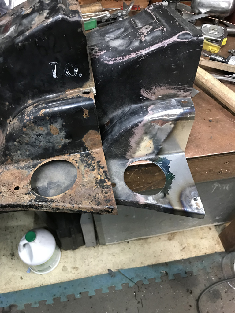

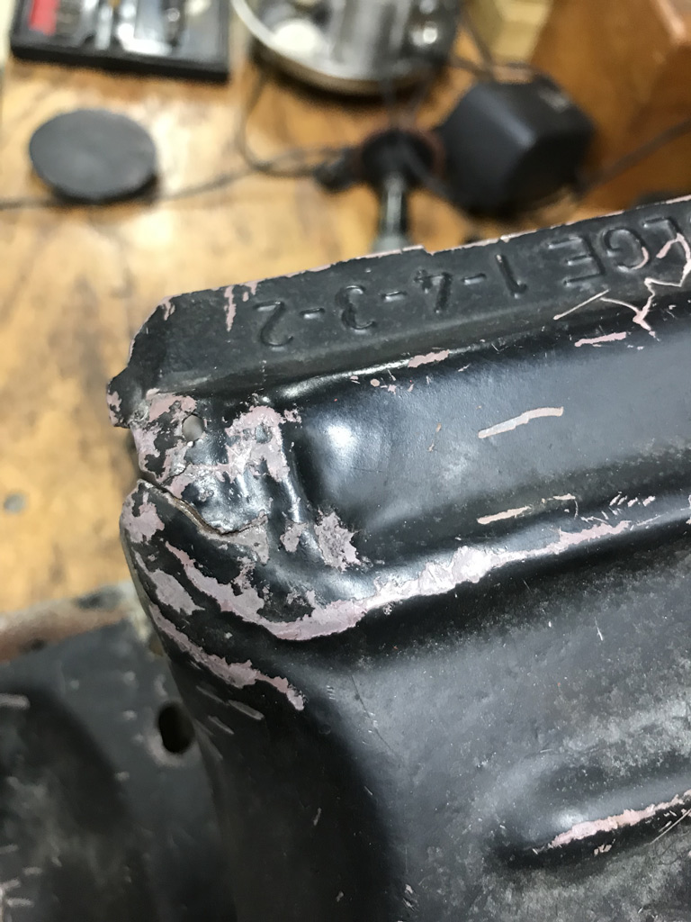

Now in the process of comparing tin between the two engines I noticed the tin from GA000099 had the 621 and I.0. markings that Brent has so carefully reproduced.
However, I did note that the I.O. mark is in a different location. Hopefully this doesn't mean he has to start all over again. (IMG:style_emoticons/default/huh.gif)

Ha! (IMG:style_emoticons/default/laugh.gif) Jeff Bowlsby has two pics of the I.O. stamp on his site. Neither show it where yours or mine were located. Seems they allowed creative license on that one as long as it was in the general neighborhood. Let me know if you want to borrow the stamps, or just pass them along to the next person who needs them. I can't imagine how tragic it would be to be driving around in a car with an engine that wasn't certified "in order." (IMG:style_emoticons/default/lol-2.gif)

More tin work in progress.
Tin on GA004310 was hacked up for dealer installed AC. Time to fix.

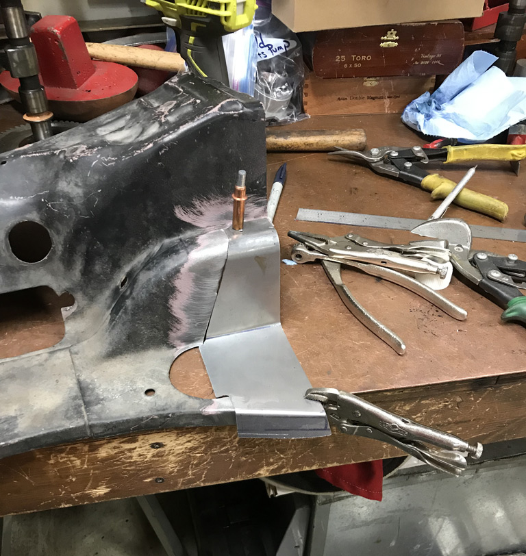

1st fabricated a new fuel pressure regulator bracket, the original had been cut off as part of the carb conversion and someone taking this engine apart and rebuilding with the deep dish bus pistons. (IMG:style_emoticons/default/headbang.gif)
This piece bracket is made out of 0.057" and has a stamping dart in it for added stiffness. I was able to approximate the stamping dart with a small bench brake.
Started fabrication work to address the missing sheet metal section that was cut out of the cylinder 3/4 side tin to accommodate the York compressor.
Here is the start of it.
Will finish this up today.
post Sep 18 2019, 02:45 AM
Post #133
Posts: 8,046

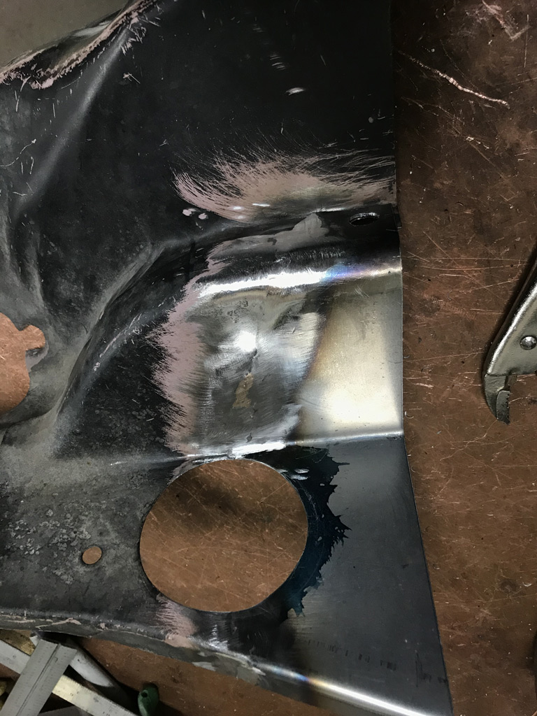

Well, 9/17 was my final skin graft surgery so I'll use the downtime to post up some work that I was able to get accomplished prior.
Engine Tin repair was completed. I did use a little bit of silicon bronze TIG rod to help fill in low spots and/or minor porosity to help with quality of final powder coating.
Mocked up to fan tin to determine where hole needed to be.
and there you have it A/C butchery repaired. Would have been way easier to buy tin, but, it made more sense to fix this and not break up a full set.

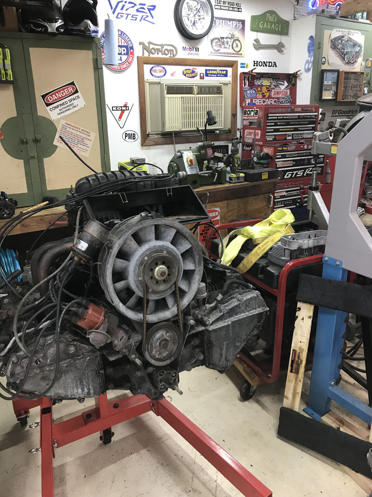

Not having enough to do with two 2.0L engines already torn down and and various stages of rebuild, I decided to pull the trigger on the 2.4L six that was floating around over on the Classifieds forum.
You know, cause I really need more to do. (IMG:style_emoticons/default/dry.gif) But at some point, I have always wanted a 914 with a six. 914/6 prices are in the Stratosphere so a conversion is my best bet to have a six in my lifetime.
The plan:
1) Tear this engine down
2) Figure out what I have
3) Try to recoup some cost by selling off the 1973.5 CIS components to a needy 911 owner
4) Cash flowing the rebuild over time as finances permit
5)Offset this engine cost by selling GA004310 (engine from my car) 1st after it has been rebuilt
6) Selling GA000099 after a year or two when I have this engine rebuilt and the funds for the conversion parts (Need a set of Ben's awesome SS heat exchangers and a nice SS muffler, a DIY oil tank kit, and other hoses, engine mounts, etc.) These costs stack up pretty quickly and will be done over time to ease negative cash flow.
7) Determine induction -- PMO carbs would be nice but I'm contemplating modern MegaSquirt based FI with PMO ITB. Has to have a ITB's or Carbs for that look and oh so sweet induction noise.
8) Question my sanity again!

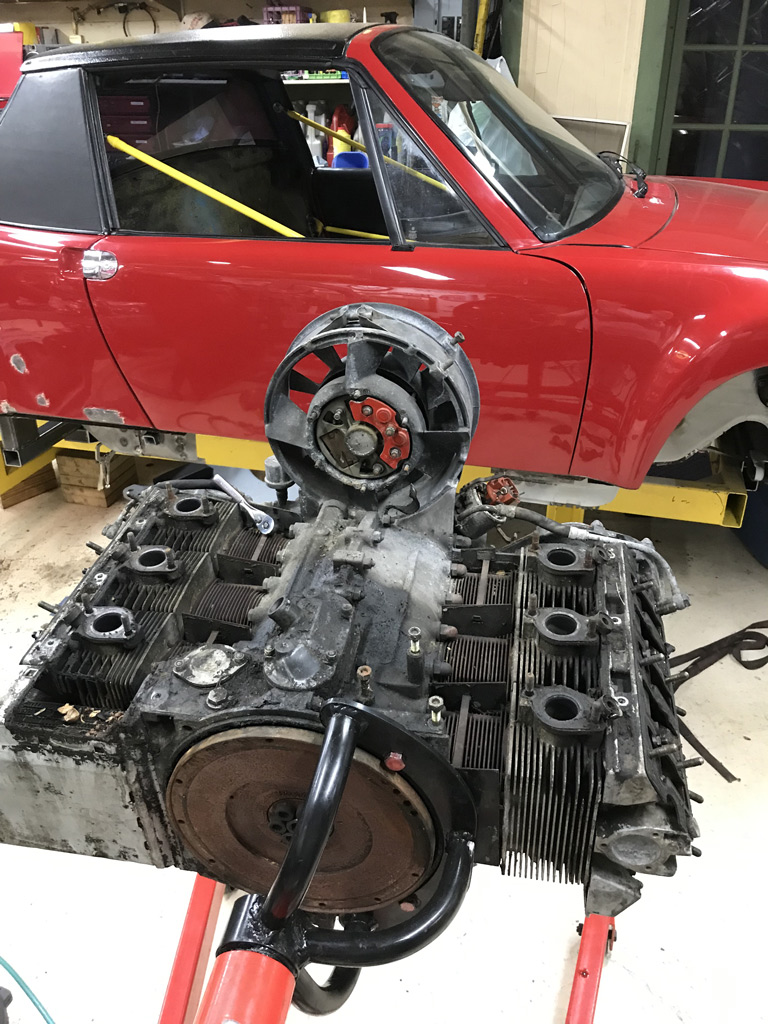

I want to post up front that this engine was bought as a core, at core price with no assumption that this would be a running motor. Engine was purchased from a terrific guy with no warranty expressed or implied! Thank you for selling this to me.
@Rolinkhaus
Upon arrival in my garage and finally up on the engine stand after a long drive, and lots of mid-west style sweating.

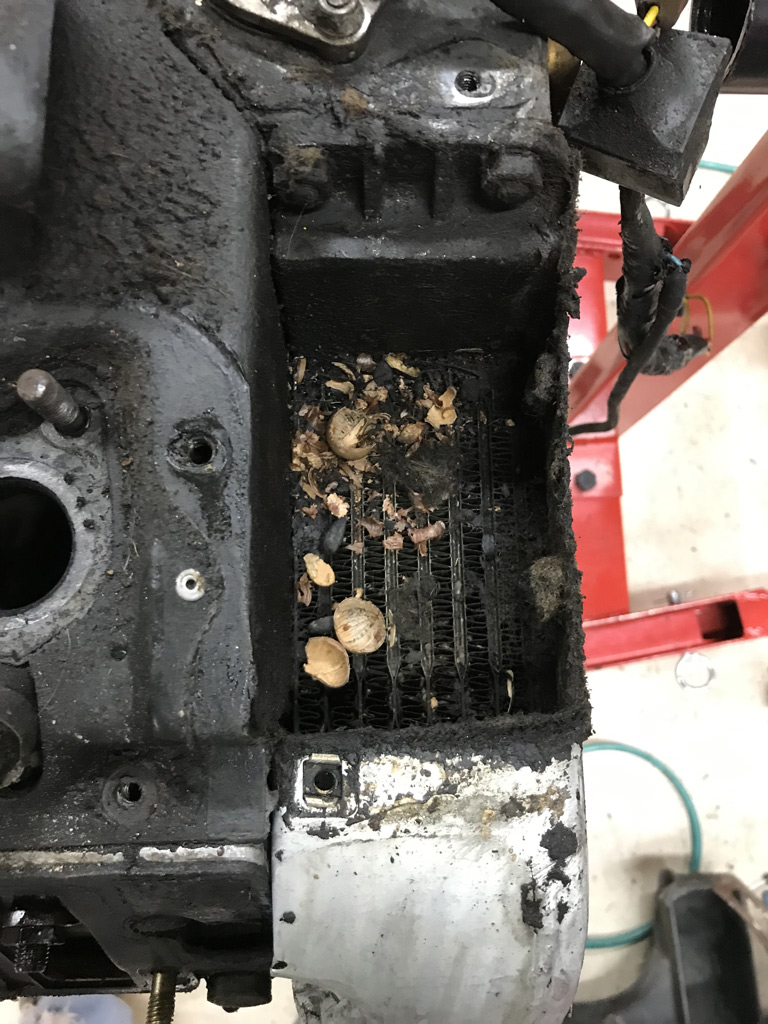

Also right up front I want to reinforce with you guys buying cars and then having overheating problems. Don't assume that the mice haven't set up home while your car and/or engine was in storage.
Here is the standard oil gunk, pollen or cottonwood fluff crap that clogs up oil coolers plus some deposits from Mickey Mouse.

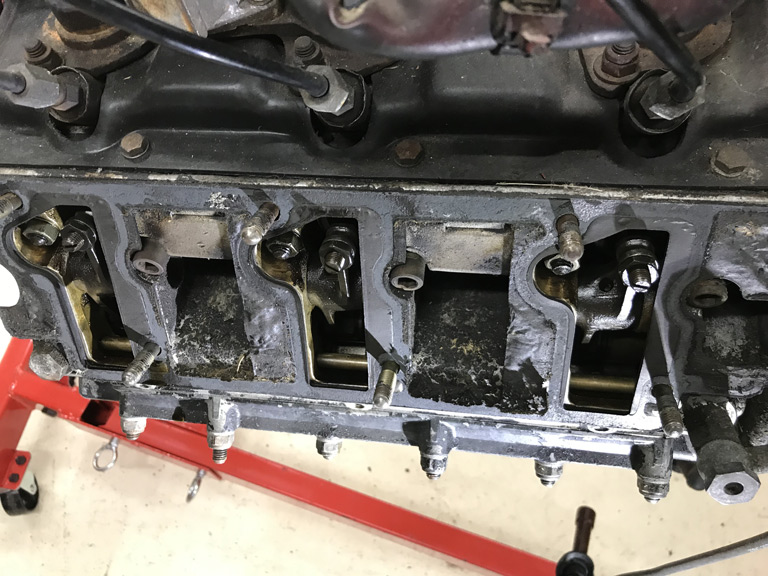

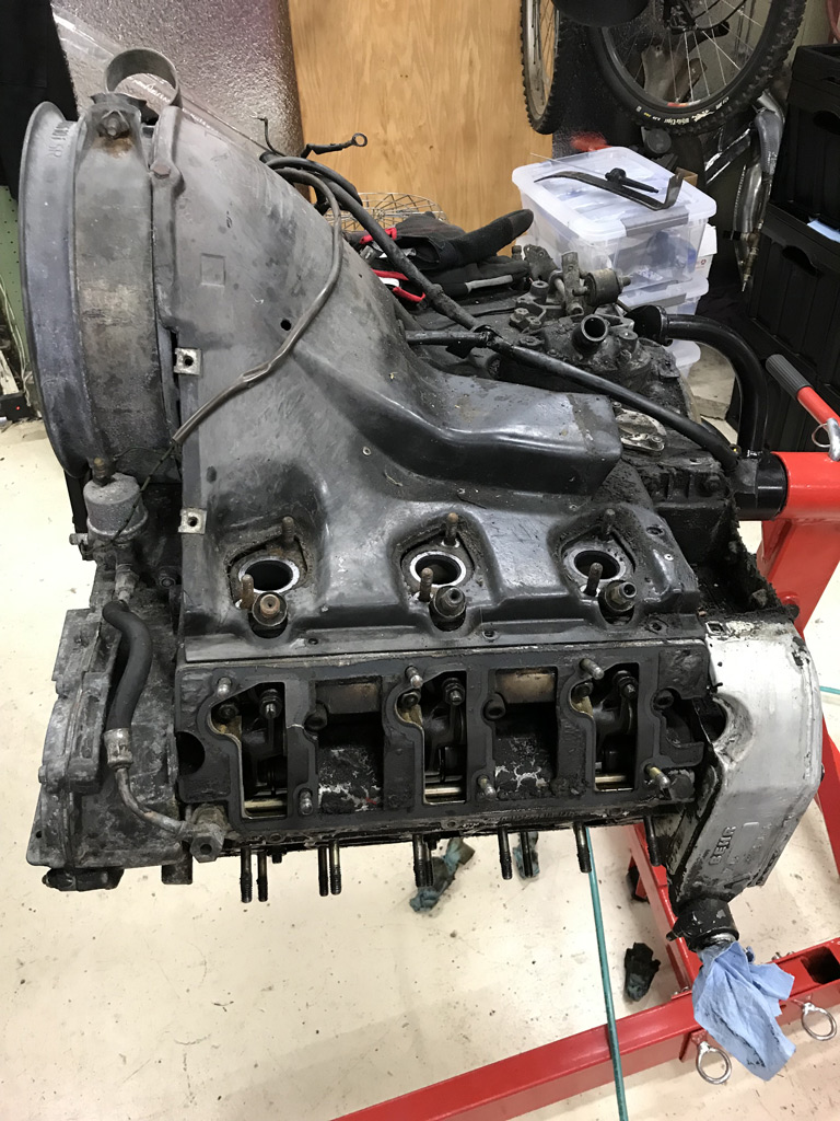

As I mentioned over in the buid thread for GA000099 I absolutely love tearing down old engines.
It is sort of like Christmas. You never know what is in the box. Sometimes its good, sometimes, it's sheer terror.
I purchased it in part because it is a 1973.5 7R motor. My car is a 73'. Seems like a good match to me. (IMG:style_emoticons/default/biggrin.gif)
Case shows signs of having been disassembled before as witnessed by RTV sealing the case and timing chain covers + heavily loaded in around the oil return tubes. I'm really hoping that someone didn't cut the cylinder spigots. Cylinders are cast iron so I have high hopes they are 2.4L originals.
Early plan of action:
1) Do leakdown just to see if I got lucky.
2) Teardown completely and assess what I have.
This engine purchase was a bit of a risk due to it being a 1973.5 2.4L and that only being a 1/2 year engine with CIS. The heads are different, CIS parts for 1973.5 are hard to find because, well you know Porsche. They were so hot to do CIS in 1973.5 that they turned around and changed a bunch of stuff for 1974! Hopefully some of this works to my advantage in trying to unload the CIS as a cost offset.

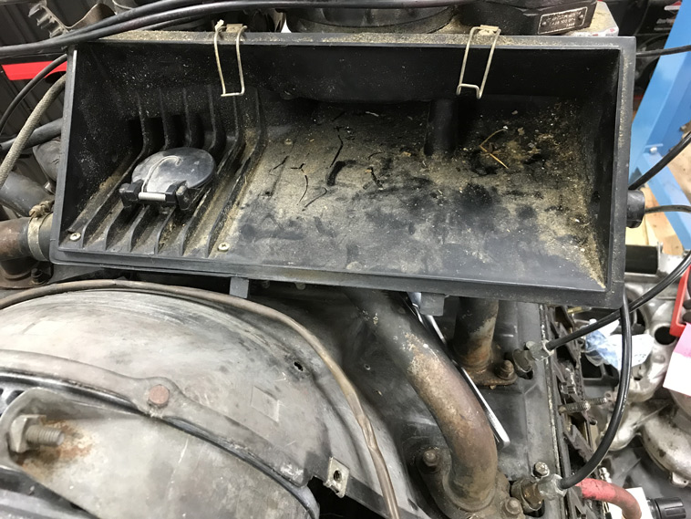

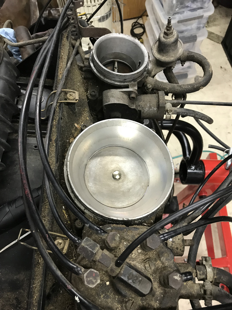

Another risk is that the air box has a ton of dirt in it. This could be debris from storage, engine shipping to Rolinkhaus, or it could be somebody was doing a track day and ingested this crap during an off course shunt.
When I pulled the CIS boot, at least the throttle body and the CIS valve look to be clean. Not a guarantee a bunch of dirt / dust didn't come through though.

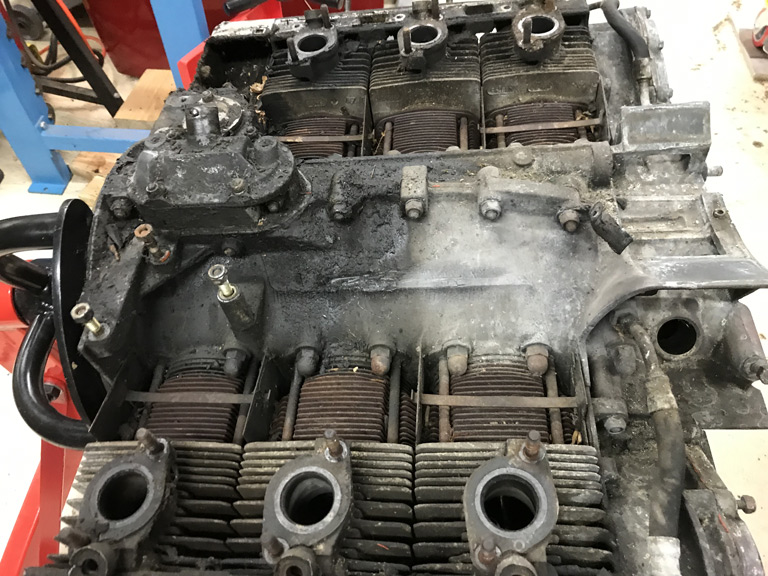

Opening up the rocker boxes to get a look at the valve gear, cams, and to be able to see them in preparation for leakdown checks.
Not pristine but engine was supposedly 90K so not outlandish either.
Between the fact that the CIS internals and the fact that the side of the rocker boxes exposed air aren't covered in dust matching the air box, I'm going to say the airbox dirt probably came during shipping or storage.

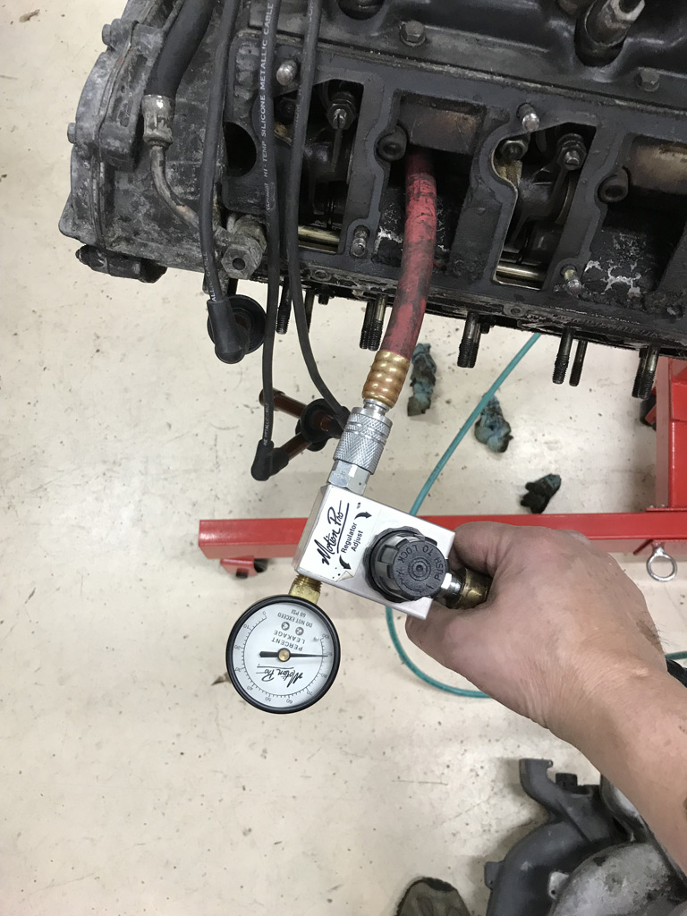

After pulling all rocker covers, I did a leakdown.
Not so encouraging. Bank 1-3 is 16% to 30%. Definitely rebuild time.
Bank 4-6 is more concerning. Basically, complete blow though with 70-90% leakage. Leaking into the case partially and hard out the exhaust valves. No compression feel when air is applied via the leak down gauge and starting before TDC and cycling up though and past TDC. Nothing . . . Nada. (IMG:style_emoticons/default/sad.gif)
There is a lot going on in my head at this point. This is the sheer terror part! (IMG:style_emoticons/default/stromberg.gif)
Valves seem to have clearance to rockers on the compression stroke so we really shouldn't have this much valve leakage. Might be burned valves.
I did pop a borescope into a couple of the cylinders before I purchased and didn't see any holes or valve heads in there and the engine turns freely. (IMG:style_emoticons/default/confused24.gif) likewise, I can see all valve heads are attached. Whew!
I may go back and back off the exhaust valve adjusters just to be sure but honestly, it doesn't matter since a complete tear down is going to occur.

Next order of business is to get the shroud pulled.
Easier said than done. CIS had to come off which is easy enough but the CIS injectors proved to be a challenge.
I've read all the Pelican forums about how hard these are to pull. I honestly can't imagine trying to do this in car.
I ended up using a slide hammer. I made an adapter to thread onto the CIS injector body and then to get a nice hard straight line pull out. They still didn't come easy.

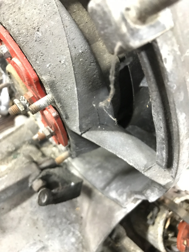

Removal of the shroud came with a few unpleasant surprises. Like all machinery of this age, it has been abused at some point in it's life.
This one appears to be no exception.
I found the fan housing to be cracked and a slight chip out of the backside of one of the fan blades. Most likely from an inept mechanic trying to wedge a screwdriver or pry bar between the fan and the housing to loosen the fan belt nut rather than using the proper holding tool.
You would think Porsche 911's might get a touch better attention than the 914's. . . but nope! Not if you happened to be in Iowa in 1974 and needed a fan belt replaced. Sorry - not trying to pick on Iowa . . . . just an analogy. Could have happened as easily in Detroit back in the day! (IMG:style_emoticons/default/happy11.gif)

1) It isn't as strong as cast iron and deserves a little more respect.
2) The legend that it can't be welded without starting on fire.
I also found this cracking on the case. (IMG:style_emoticons/default/stromberg.gif) The case is the desirable 7R case and is the bulk of the reason I chose to purchase this core.
I think this is just casting shrink at the casting gate where molten metal flows into the mold. The gate intentionally provides a place for metal to shrink from when the casting cools.
The fact that there is no oil residue here likely means this doesn't penetrate the case. We'll see when I get the case split. I'll keep my fingers crossed that it is indeed gate shrinkage. Or worst case, it is repairable by Otto's or the like.

So finally after much cursing and a little more disassembly, I finally got it down to a long block.
This is the current state of affairs.
Once I'm past this 2nd day of post surgery pain, I'll get back out into the garage and start working toward a complete teardown and determination of what's going on over on the bank 4-6 side of the engine.
