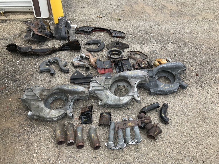

Superhawk996   The other work that has started in April is beginn...   Apr 23 2019, 09:04 AM
Superhawk996   Here is a bit of previous work. I removed the tun...   Apr 23 2019, 09:27 AM
Superhawk996   For all you guys that think just a little rust in ...   Apr 23 2019, 09:34 AM

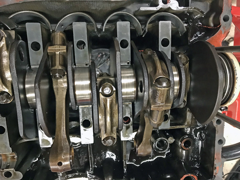

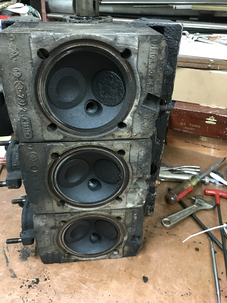

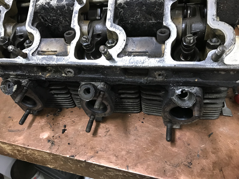

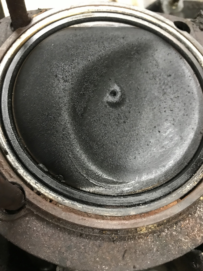

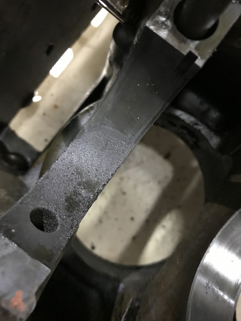

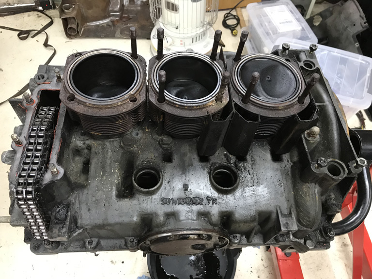

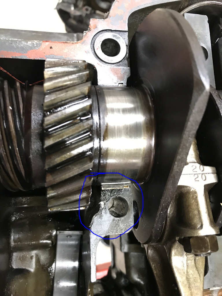

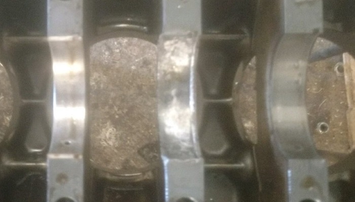

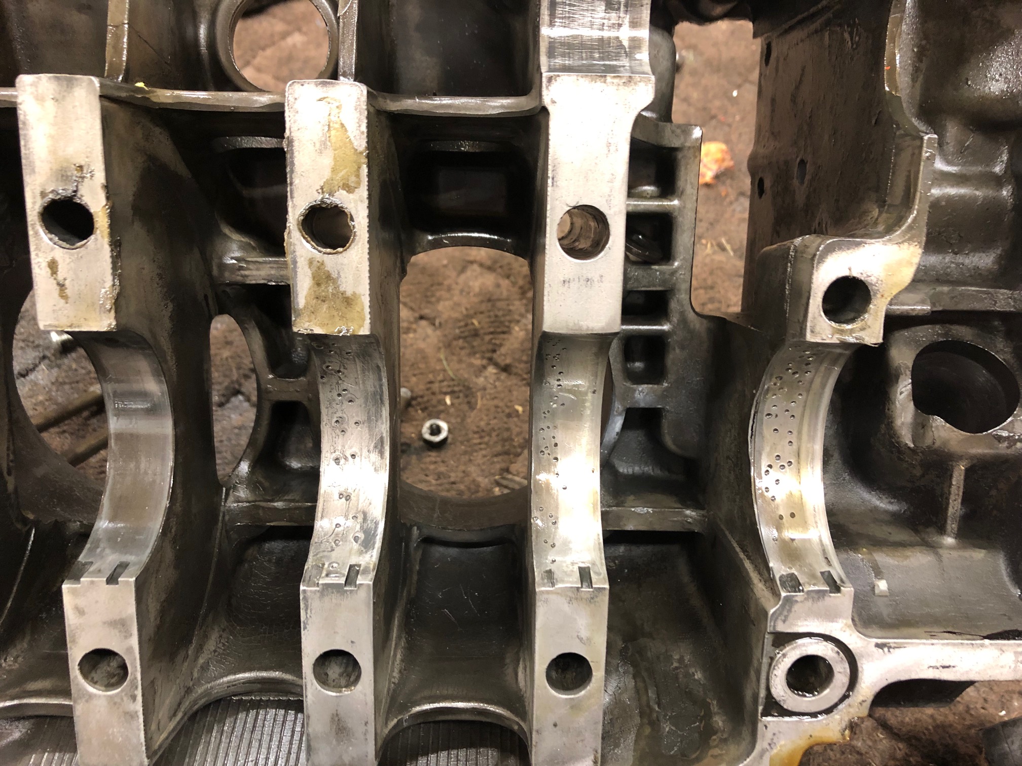

Superhawk996   Well since I'm not supposed to be doing any he...   Apr 28 2019, 04:49 PM
Dave_Darling   Worse than the rust debris / garbage there is som...   Apr 28 2019, 07:02 PM
bbrock   Worse than the rust debris / garbage there is so...   Apr 28 2019, 07:31 PM
restore2seater   I have no idea what this is or where it came from....   Apr 29 2019, 08:04 AM
Superhawk996   On a more positive note. Most of the other engine...   Apr 28 2019, 05:03 PM
bbrock   When I rebuilt my short block, I filled all the ga...   Apr 28 2019, 05:13 PM
Superhawk996   I've gotta admit JB weld is pretty good at res...   Apr 28 2019, 05:24 PM
Superhawk996   Here is the Miata in it's prime as a MUV. Mia...   Apr 28 2019, 05:27 PM
bbrock   Here is the Miata in it's prime as a MUV. Mi...   Apr 28 2019, 05:57 PM
Superhawk996   @bbrock Wait a few years, but, you definitely sh...   Apr 28 2019, 06:12 PM
Superhawk996   Here's a video of the posted Miata turning 220...   Apr 28 2019, 06:18 PM
bbrock   Here's a video of the posted Miata turning 22...   Apr 28 2019, 07:36 PM
Tenner   A few posts earlier, you've been talked about ...   Apr 29 2019, 02:55 AM
injunmort   to fill pits in rocker covers, try boiler cement. ...   Apr 29 2019, 04:33 AM
Superhawk996   @Tenner [b]Looks like nice work. You most defin...   Apr 29 2019, 04:44 AM
bbrock   @[url=http://www.914world.com/bbs2/index.php?show...   Apr 29 2019, 08:11 AM
injunmort   brake piston   Apr 29 2019, 10:18 AM
Superhawk996   brake piston Good guess . . . but it would ha...   Apr 29 2019, 11:40 AM
