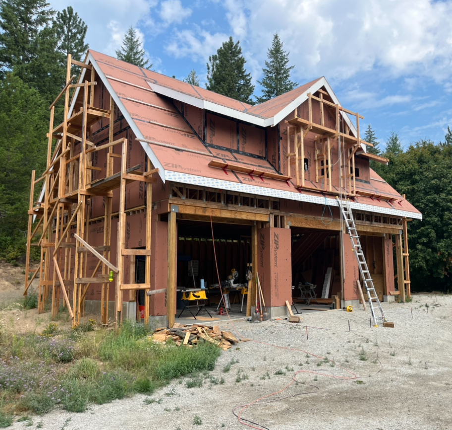

Among that work, I had to get wood stacked for winter (5 full cords - not face cords (IMG:style_emoticons/default/laugh.gif) ), and of course do my other job as chimney sweep.
Since I work so slowly it doesn’t make sense to rent scaffold or rent bucket / man lift equipment. This hillbilly scaffold got built instead (lumber later to be recycled into sheds / greenhouse). This had to be done on both gable ends and front peak to do sheathing and fascia work and took about 4 days to build (each).
There was a couple lost weeks to vacation in June and two weeks of 100 degree weather in July that really slowed productivity.
Currently the push is on to get the finish fascia installed so that I can get roofing contracted & done. So this is pretty much how it currently stands. Hopefully have a roof in a month. Got windows quoted, etc.
Overall, not too bad for a one man (IMG:style_emoticons/default/stromberg.gif) show, just a little over a year since I put up the first wall. I try to keep some perspective otherwise I’d be overwhelmed with how much still needs to be done.
Going to be a busy winter. Probably end up doing cladding and some interior work over the winter.

QUOTE(Superhawk996 @ Aug 12 2024, 11:41 AM) *
QUOTE(930cabman @ Aug 12 2024, 12:20 PM) *
Haven't seen an update recently, is the barn getting closed in?
(IMG:style_emoticons/default/av-943.gif) Thanks for asking @930Cabman
Basically I’m a lazy POS. Not dried in yet.
I have excuses though.
Part of this deal of relocation was I get a garage, wife gets a patio. We live on a sloped property so there was nowhere that was flat and safe to walk without mole holes to twist an ankle in, and lots of dirt that turns to dust during this dry time of year.
May and June largely went to excavating the yard, and literally bringing in hundreds of tons of gravel fill that the rodents can’t burrow in. Though much of it was contracted, I was in the hook for “project management” duty as well as the mundane labor of laying drain tube, electrical conduit, and irrigation lines for future use. Basically the patio is another 10 phase project into itself.
Current state awaiting install of 12 pallets of retaining wall block / borders. Then need to decide if we are going to do artificial turf or pavers on top of gravel base.
I probably would not agree with the "lazy POS" reference as this is a massive project. Keep up the good work and be safe there in the wilderness

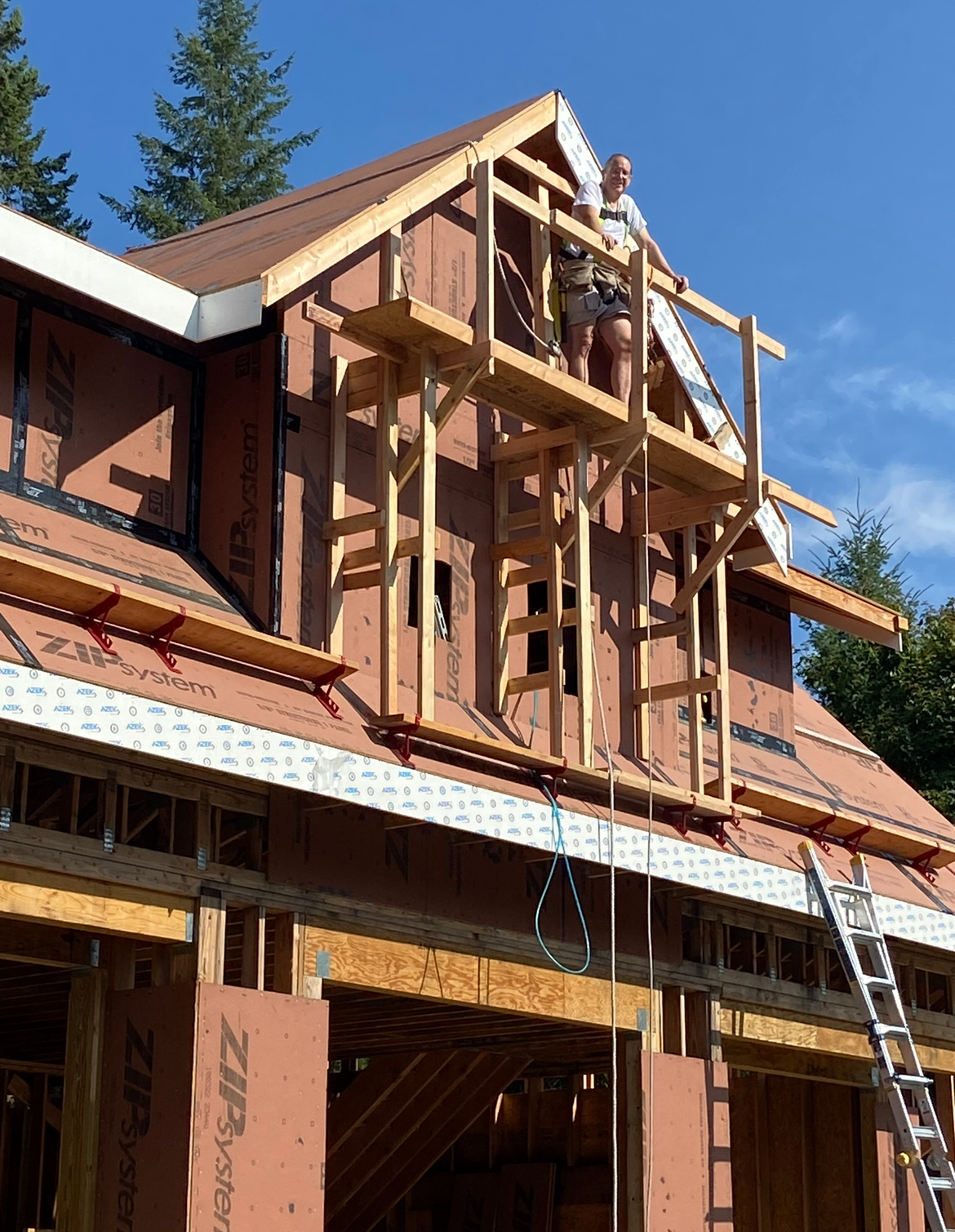

Are those working decks 2x4's with plywood?
Superhawk996
post Aug 14 2024, 06:34 AM
Post #585
Posts: 8,135
Joined: 25-August 18
From: Woods of N. Idaho
Member No.: 22,428
QUOTE(930cabman @ Aug 14 2024, 06:58 AM) *
@930cabman
Yes, basically but used scrap 3/4” T&G subflooring that was leftover from the 2nd floor subfloor build. 23” wide or so. I really don’t like working off the 10” toe boards at the edge of the roof; too narrow for my comfort.
2x4s limited to about a 6’ span.
Always have a harness on when I’m up there.

That is NOT a "Hill Billy" scaffold!
That's "engineered"...
It doesn't incorporate a live oak OR barnyard animals in its construction.
It's not made out of stolen street signs.
No duct tape to be seen anywhere.
Not "Hill Billy" at all!
Actually, the scaffold (and the rest of the project) looks BAD ASSED to me.
That is a wonderful 3 bay shop!
It will look "Homes and Gardens" when you're done.
Very nice!

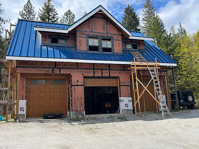

It’s been along time since I’ve updated anything on my “build” page.
Unfortunately the garage build still dominates instead of the 914. 2025 was a really bad year for progress due to the passing of my father in law, disputes with the health department over tying the garage into my septic, and my own health challenges now that I’m officially an old man.
This is going to be a long series of posts to catch up. I’m also really missing Brent’s posting of wildlife so I guess I’ll throw some into this post in memory of Brent.
For anyone that doesn’t have the patience and wants the TLDR
Here’s the latest status. Roof went on in fall of 2024. Garage doors went up in late fall 2024. Currently I’ve been putting in windows that have been onsite and awaiting install since December 2024. Apparently I’m still inventing hillbilly scaffolding to do what needs doing.
Superhawk996

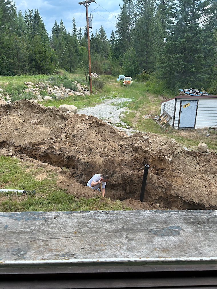

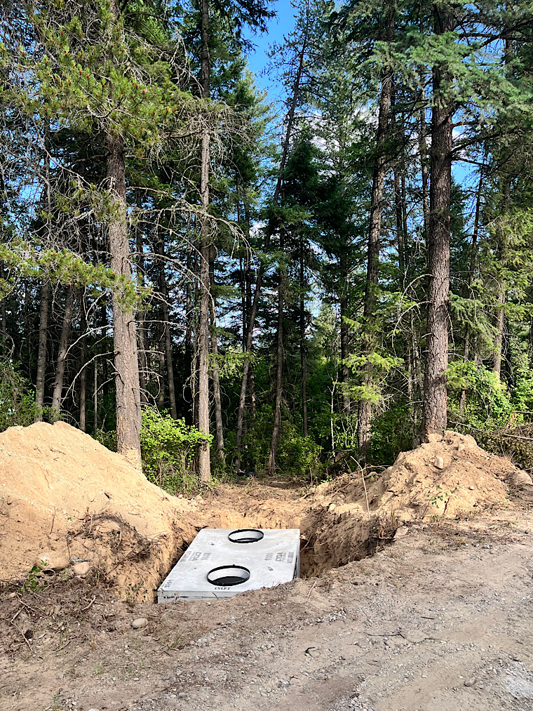

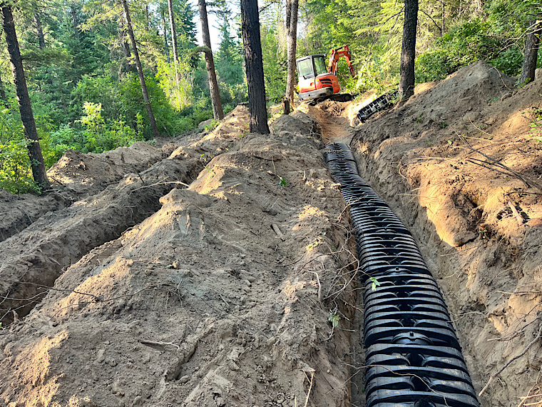

I did learn that if I ever hit the lottery I will be suing the health department just for sport.
Basically due to them losing paperwork from 1993 regarding my original septic, I had to install a dedicated 1000 gallon tank for the garage and 222’ of new drainfield. It’s such a long story and it just makes me mad telling it so I’ll skip it.
Lots of digging trenches and dealing with rocks in 2025.
Only time will tell how many trees survive the install of the drain field. Likewise I’m not fully convinced this new vaulted drain field is going to last as long as the old school perforated pipe and drain rock but hopefully I’m dead and gone before we find out.

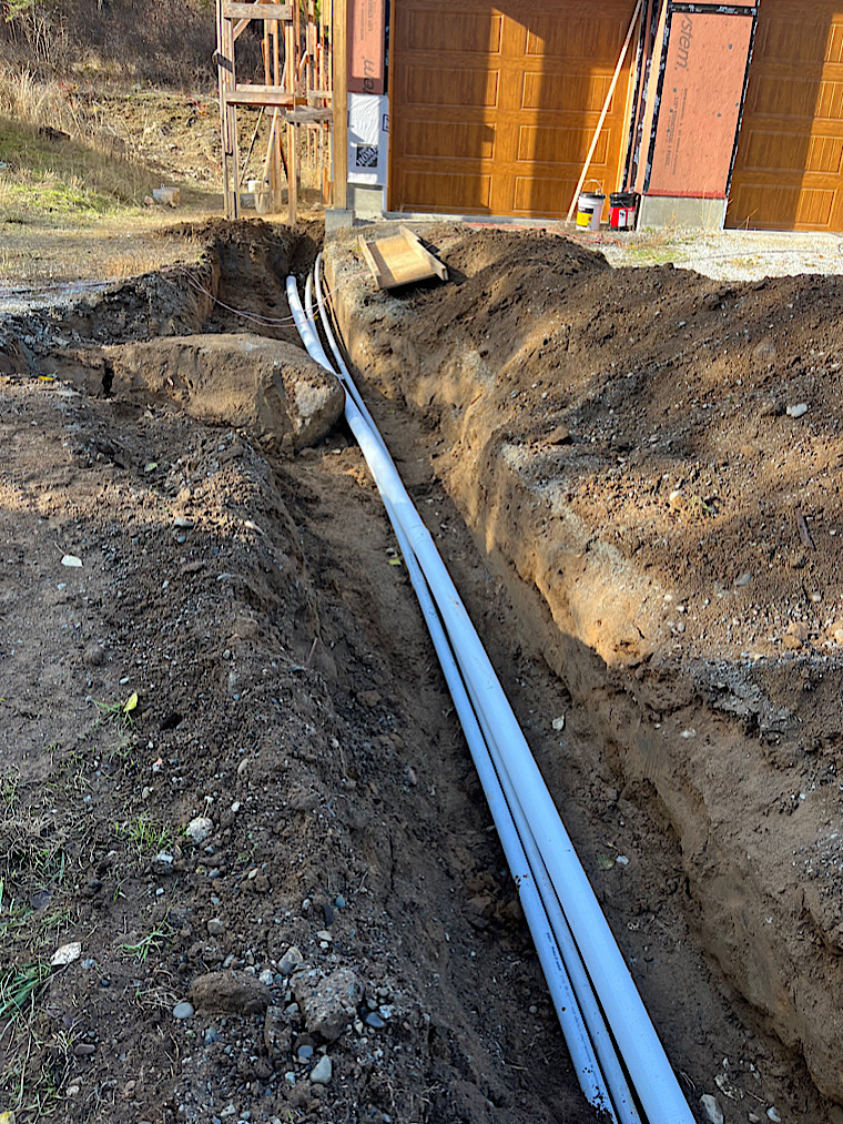

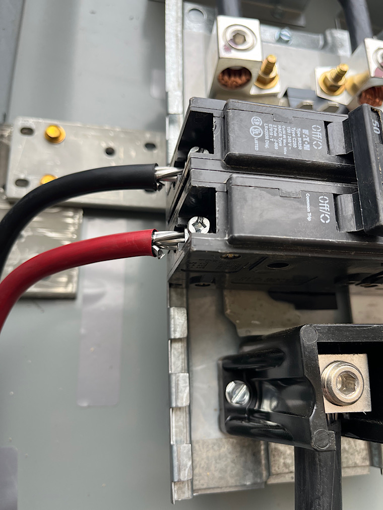

Staying with the theme of trenches and rocks, electrical went in around late November 2025.
Again, another long story of dealing with incompetent bureaucrats, the utility, and incompetent “licensed” electricians. Had to do a 400amp service upgrade in order to keep 200a to the house and add 200a to the garage. Luckily I avoided buying a new transformer.
Despite paying $4k to the utility for an “engineering study” the utility crew still showed up without enough wire to make it from the pole to the service panel. (IMG:style_emoticons/default/av-943.gif)
Why is there always a damn rock right where the trench needs to be. This one is much larger than it appears. They are often like icebergs and the tip you see is only just the beginning. The mini excavator couldn’t even budge this guy. Luckily I was able to sneak around it.
Word of advice. Licensing means nothing when it comes to electricians. The bureaucratic state electrical inspectors are equally or even more useless.
The lectrician’ decided that since he didn’t bring the right size wire to fit the breaker he’d just clip a few strands. Totally in violation of code. (IMG:style_emoticons/default/chair.gif)
Now you might think the state inspector would catch it. Nope. Instead he fails the inspection because I didn’t have a light fixture outside the entry door. (IMG:style_emoticons/default/headbang.gif)
Just so many useless bureaucrats and bad contractors in this world.

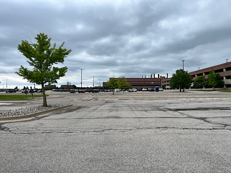

During the trip back to Michigan for my father in laws funeral I decided to swing by the Chrysler headquarters to see what sort of chaos was going on there with the decline of the auto industry.
I was not disappointed.
The parking across acres of parking lots that used to be full are now nearly empty. The parking structures were empty - on a Thursday at 2pm in the afternoon. A combination of layoffs, and work from home policies.
The old Chrysler museum was taken over and turned into the Alfa and Maserati offices back in the FCA era.
Of course these have been abandoned and the building is slipping into a state of disrepair.
If anyone wants a pretty decent version of what went on after Mercedes bought Chrysler and what was the beginning of the end, Taken for a Ride is a good read.
Here’s the backside of one of my old business cards from my time at Viper sitting on top of the book cover. Those were the coolest business cards I ever had. Does anyone still use business cards? Attached Image
