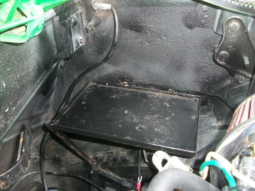

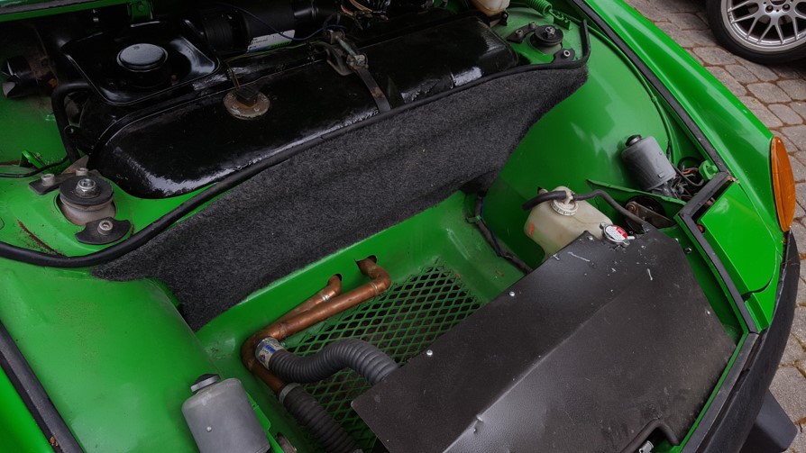

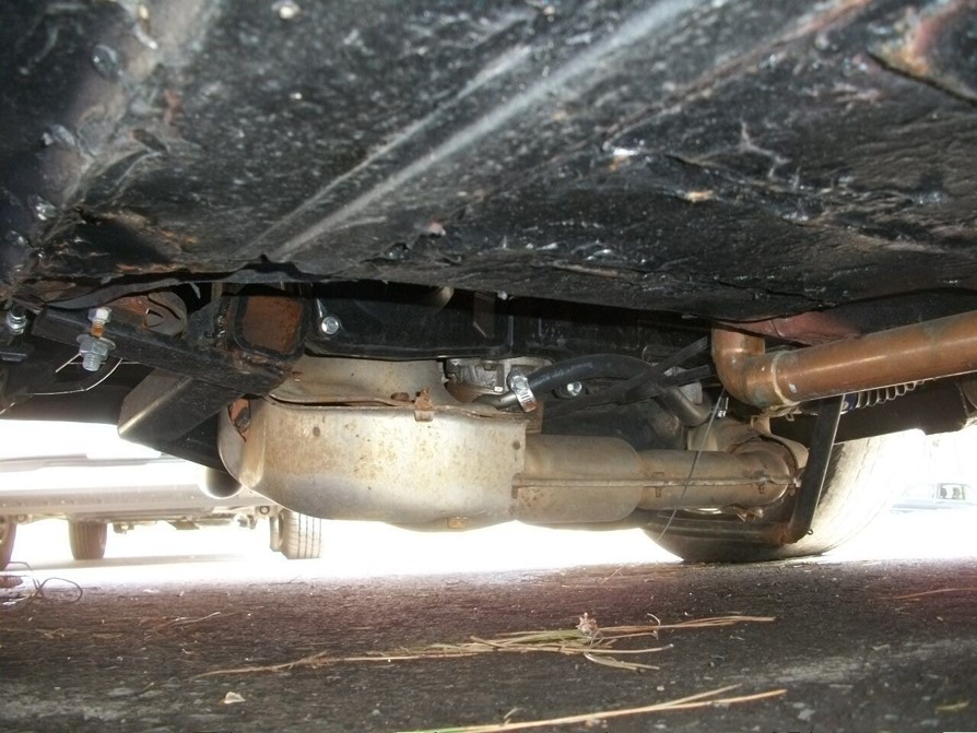

I am considering purchasing this project 914. I am concerned that rust may have been covered up by a rhino lining or similar spray application at the hell hole. Does anyone have any knowledge of the car or any advice as to what exactly what I should be looking for when I go inspect the car in person?

dlee6204   I can tell from the pictures that there was a very...   Jan 12 2019, 07:40 AM
Jon199   That’s what I was afraid of.   Jan 12 2019, 07:58 AM
Superhawk996   :chair: The carnage occurring to 914's is atr...   Jan 12 2019, 08:14 AM
Superhawk996   Oh, the two best things to bring with you on a pot...   Jan 12 2019, 08:21 AM
Jon199   Superhawk, Thank you for the advice and the educat...   Jan 12 2019, 08:58 AM
Superhawk996   Superhawk, Thank you for the advice and the educa...   Jan 12 2019, 09:29 AM
Tdskip   Welcome Jon! As you have seen already it is a...   Jan 12 2019, 09:08 AM
Tbrown4x4   Those pictures show so many substandard repairs...   Jan 12 2019, 09:55 AM
jmitro   I disagree with some of the assessments above. tho...   Jan 12 2019, 10:01 AM
SirAndy   I disagree with some of the assessments above. tho...   Jan 13 2019, 12:19 AM
rhodyguy   Why does everything on the bottom or the car seem ...   Jan 12 2019, 10:02 AM
Jonathan Livesay   Why does everything on the bottom or the car seem...   Jan 12 2019, 11:29 AM
IronHillRestorations   This car looks like someone else's problems to...   Jan 12 2019, 10:16 AM
bbrock   :agree: with everything said above. I don't t...   Jan 12 2019, 10:20 AM
TravisNeff   That exhaust is very low, careful on speed bumps...   Jan 12 2019, 10:39 AM
76-914   Run Forest, run. I have two H20 conversions and on...   Jan 12 2019, 11:19 AM
