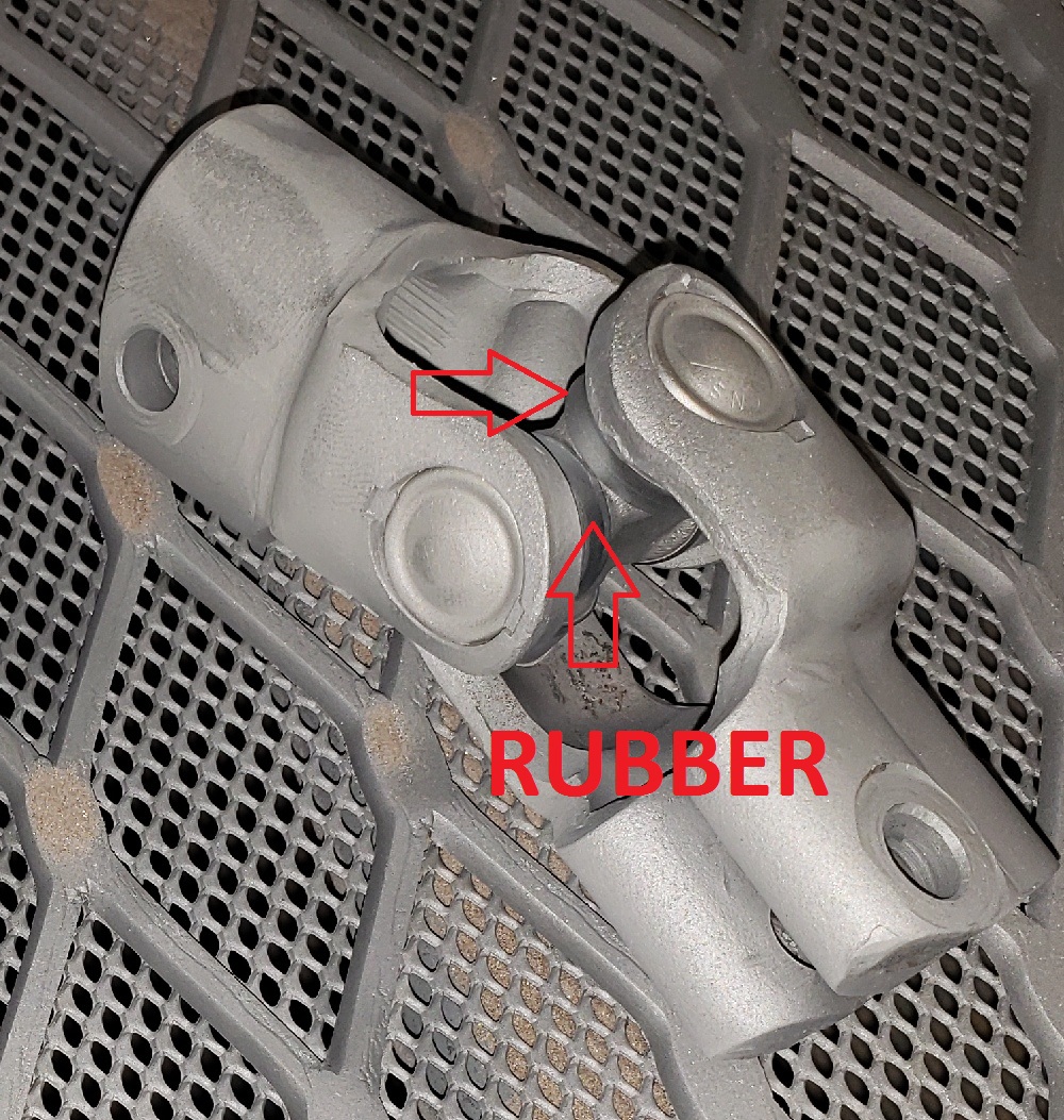

started on the u-joints for the steering column,will powder coat tomorrow.

I've never had one of those apart, what kind of bearings/bushings are in those?

QUOTE(IronHillRestorations @ Jul 11 2019, 06:34 AM) *
They have rubber bushings, tested at 400 degrees

Haven't disassembled that particular joint either, but might the rubber parts on the "cross journal" be seals? http://repairguide.autozone.com/znetrgs/re...15280052d19.gif

QUOTE(UROpartsman @ Jul 11 2019, 10:57 AM) *
Good point probably roller bearings inside
I will have to cut one open

QUOTE(UROpartsman @ Jul 11 2019, 09:57 AM) *
Yep. They are basic U-joints with needle bearing inside. Everything you wanted to know in this vid. You should check out the other stuff this guy is doing. It's wild and much is applicable to our cars.

The 911 bearing caps in the video have retainer clips, but the 914 caps appear to be staked in place with a punch. Surprising that the needle bearing grease didn't melt out during baking for the powdercoat.
This is interesting. I just looked up the P/N for the 914 joints: 930 347 025 00 for all years. Isn't that a 930 part number? How could there be a 930 part on a 1970 MY car?

Could be design supersessions over the years, or minor differences between OE, OEM, and aftermarket joints. Will check into it and report back.

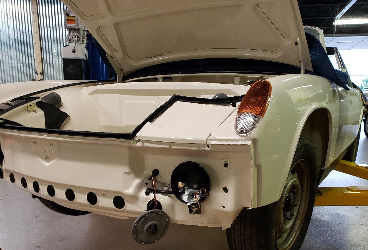

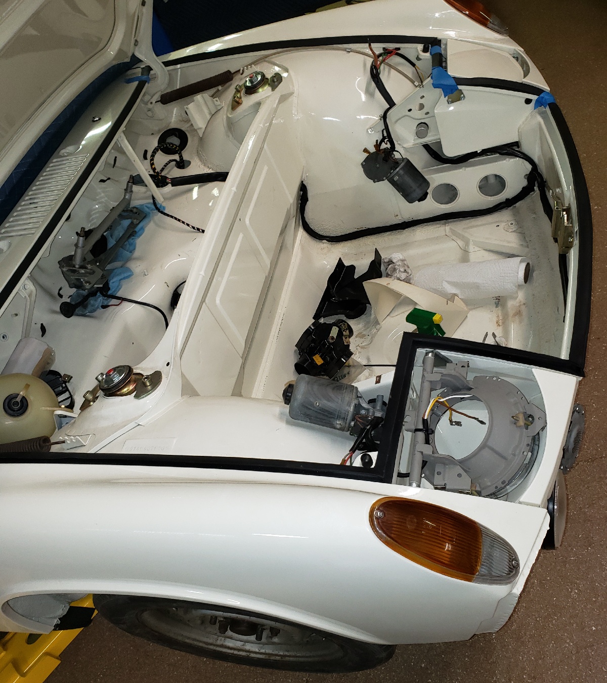

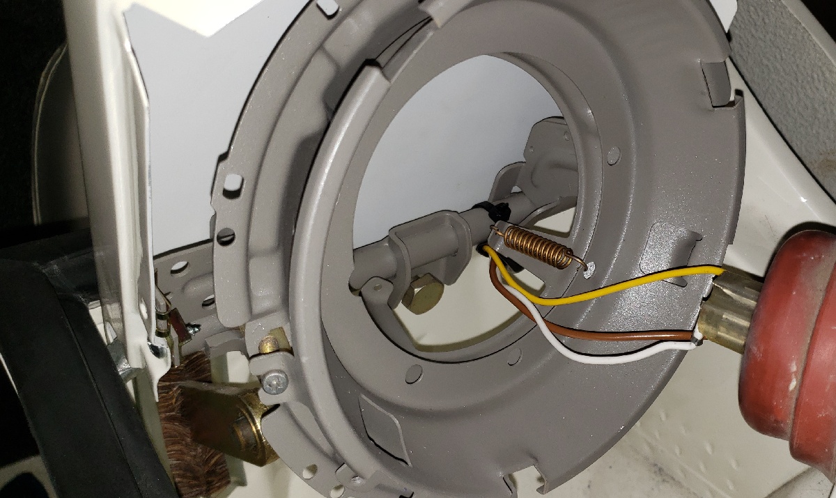

It has been a while since I updated this thread. I will start with the completion of the wiring in the front of the car.

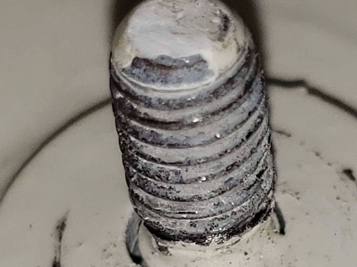

Always remember to run a die over the grounding studs on the car.
This will avoid intermittent and difficult to track wiring issues.
this was what the stud by the headlight motors looked like

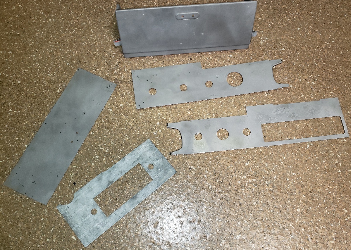

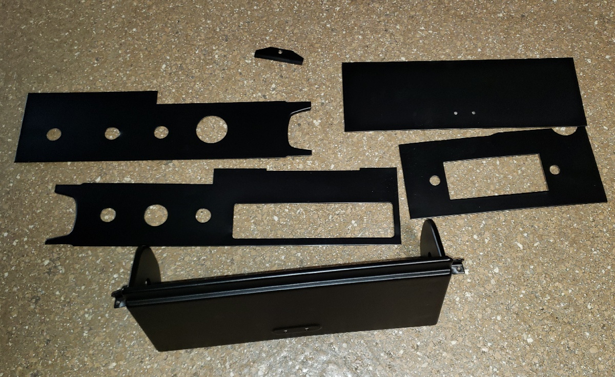

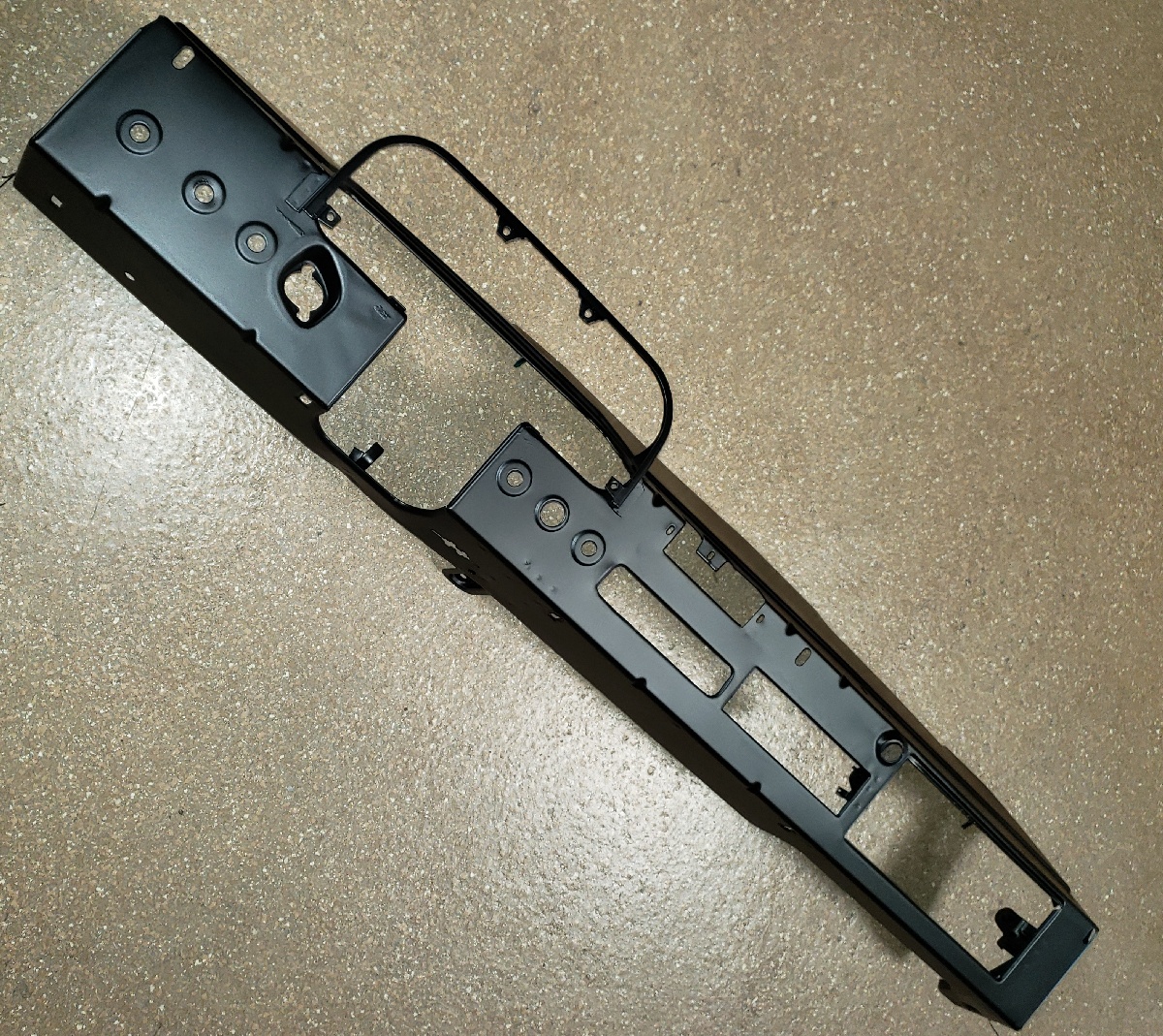

I did some more powder coating after I sand blasted the dash panels
