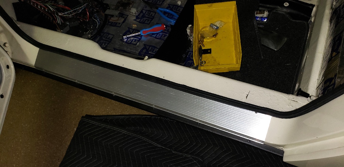

put last couple rivets in threshold and installed seal
did some paint touch-up on the holes I had to enlarge for the badge

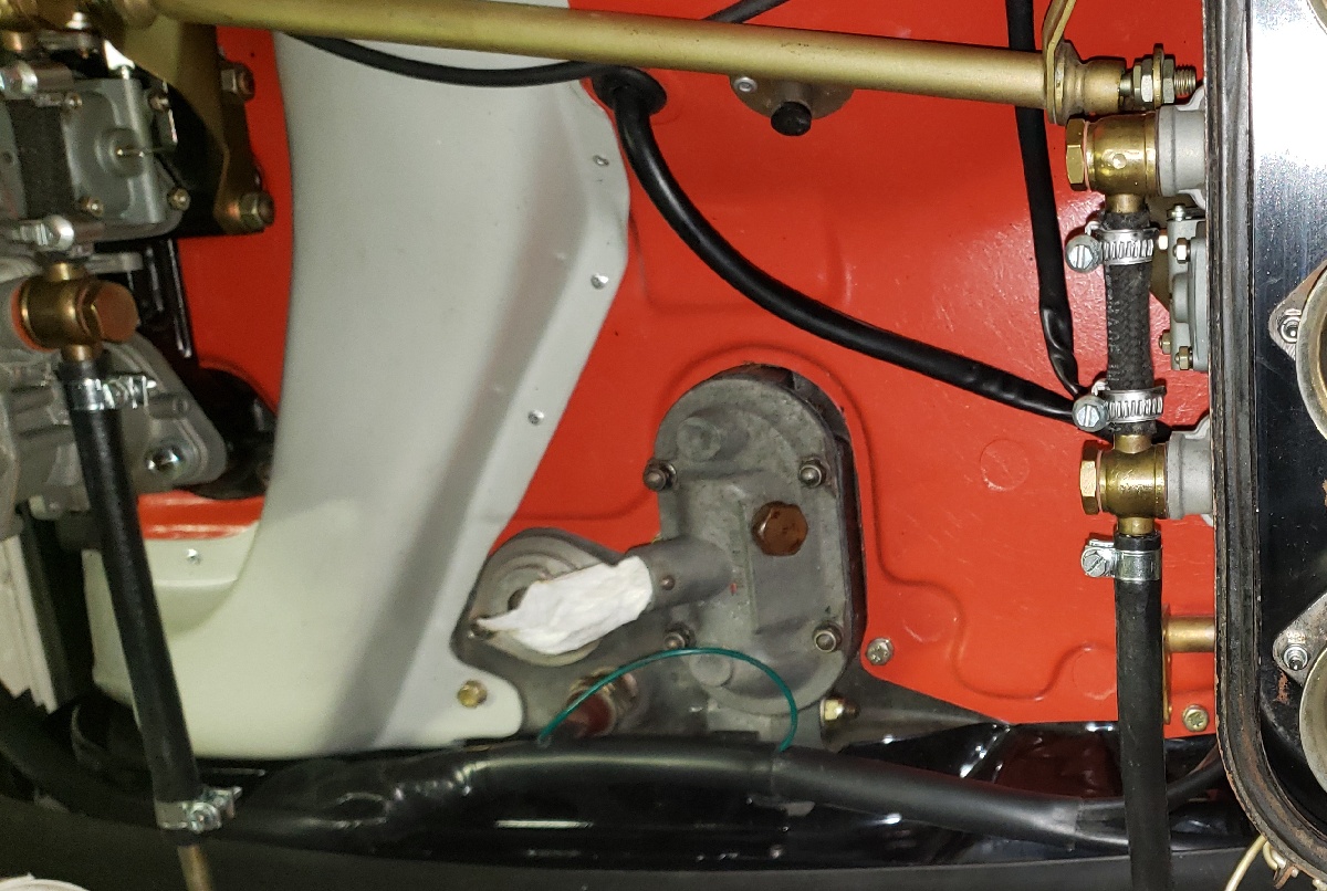

finished up some fuel lines to the carbs

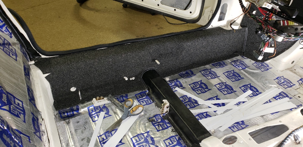

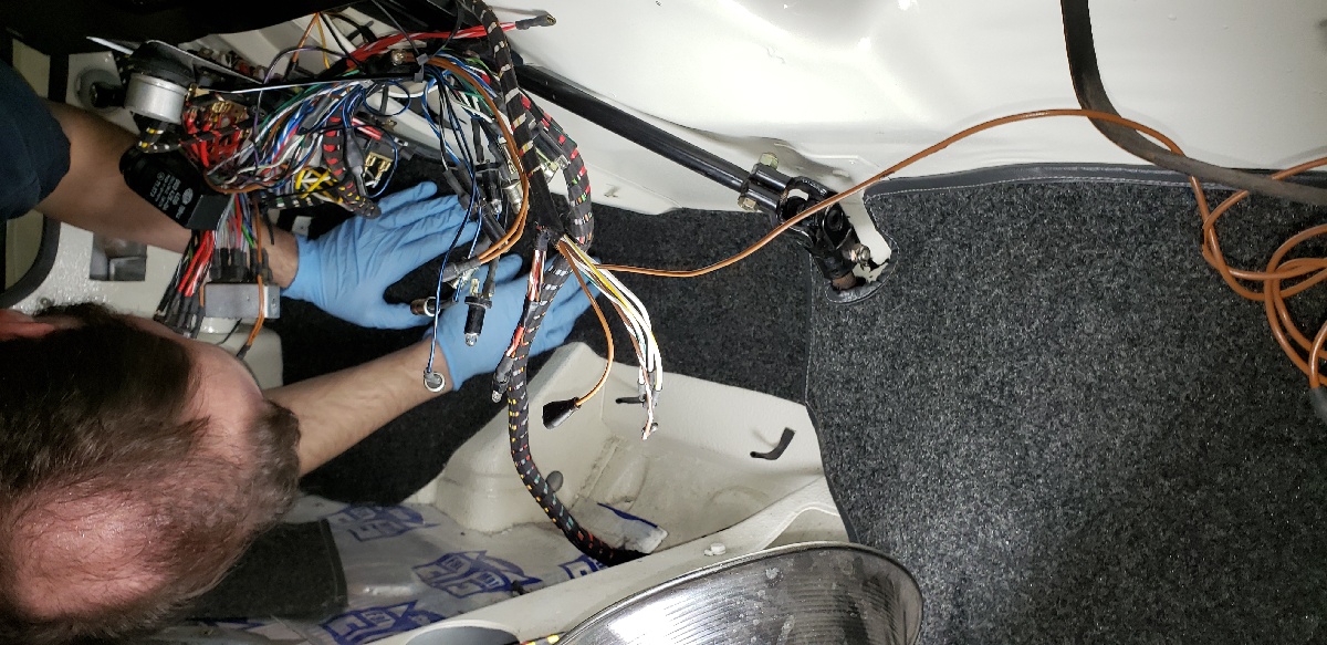

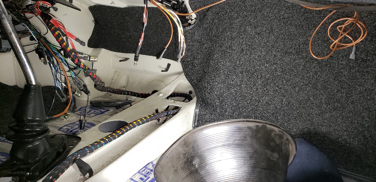

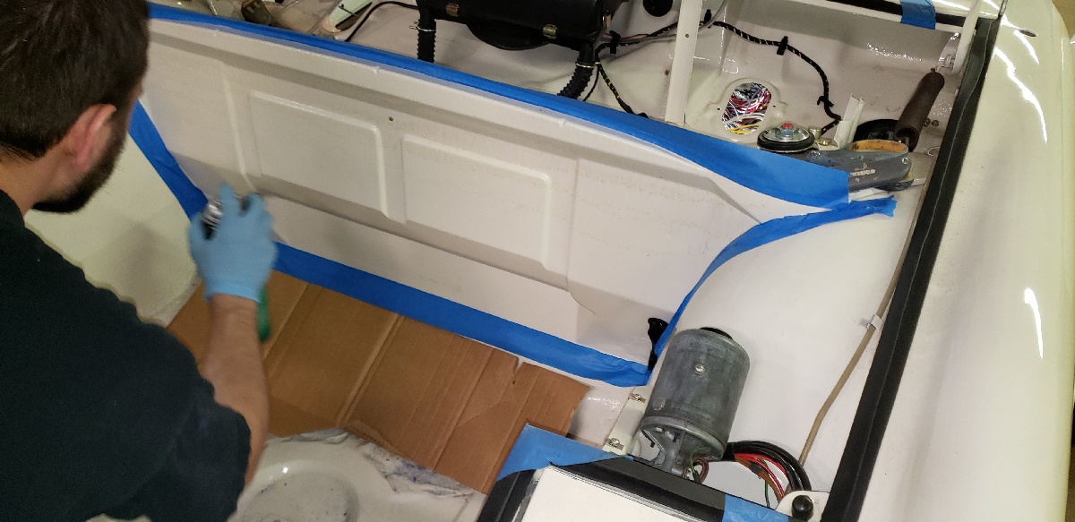

tonight I was able to get the carpet finished with the help of my friend Matt.
I should say that I assisted Matt, he is very talented at this type of work.
starting with the firewall
gms
post Mar 19 2020, 09:15 PM
Post #228
Posts: 2,755
Joined: 12-March 04
From: Chicagoland
Member No.: 1,785

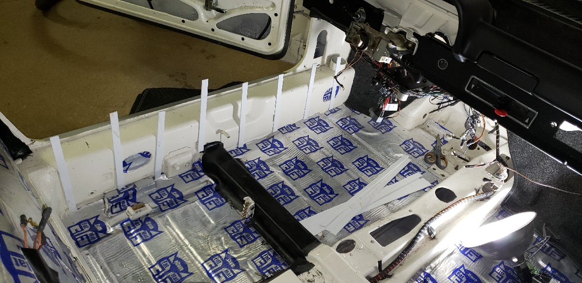

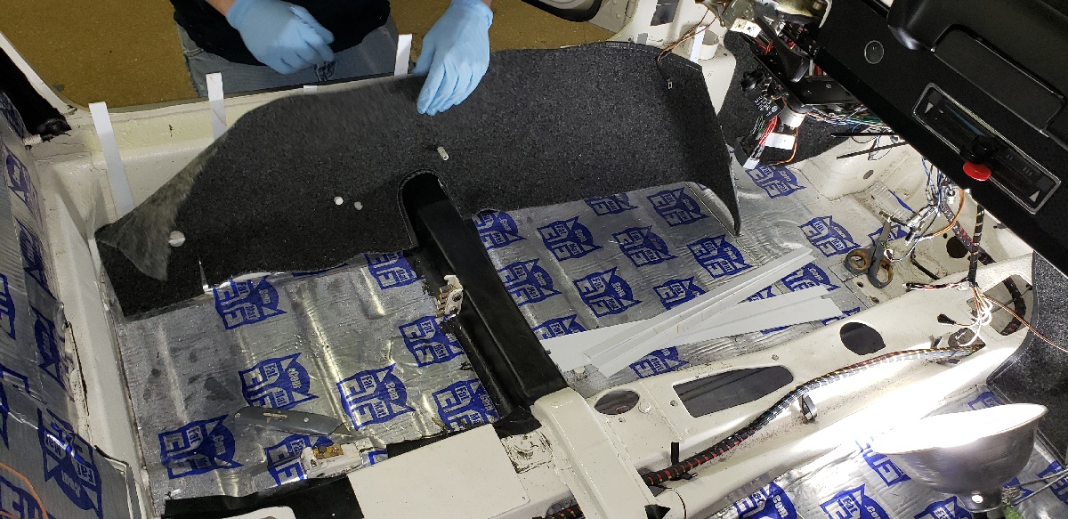

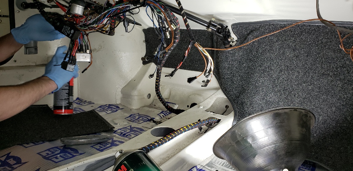

Then we moved on to the longitudinal. Lots of obstacles on this side of the car
spray on the 3M 90
Matt used these sticks to keeps the carpet from sticking where it was not massaged into place. This was a learning experience for me
gms
post Mar 19 2020, 09:18 PM
Post #229
Posts: 2,755
Joined: 12-March 04
From: Chicagoland
Member No.: 1,785

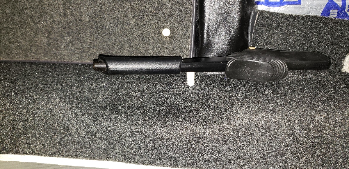

Finally after some cutting, pulling and messaging it was formed perfectly

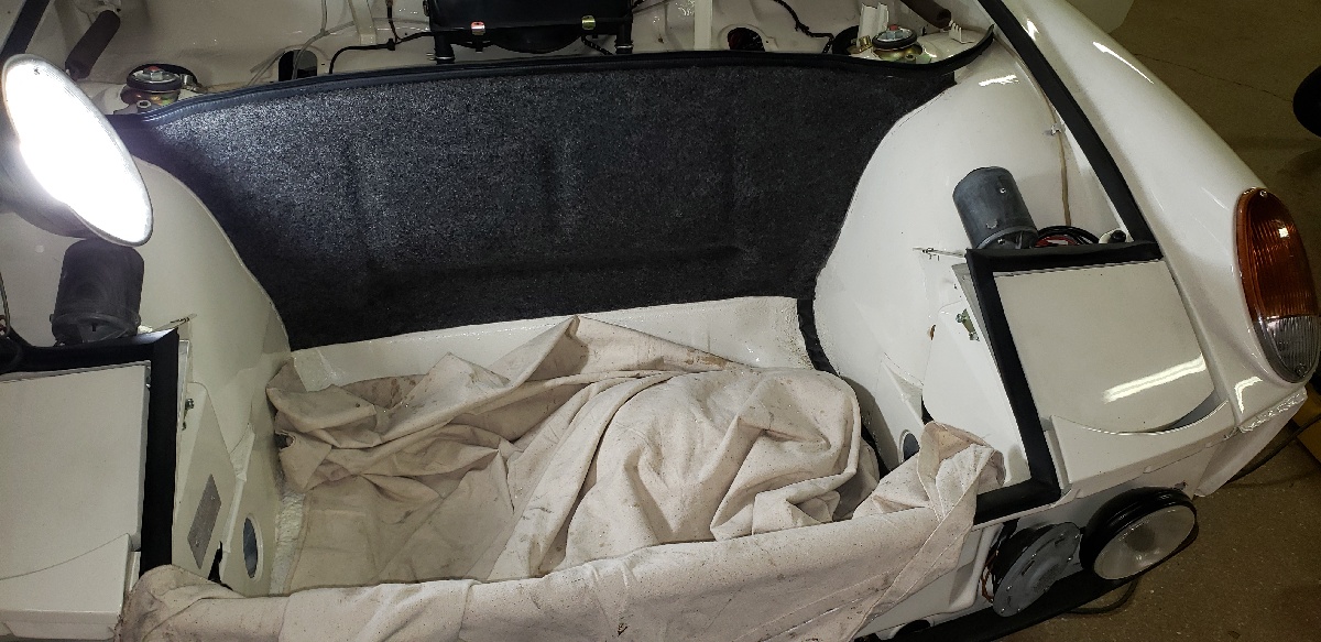

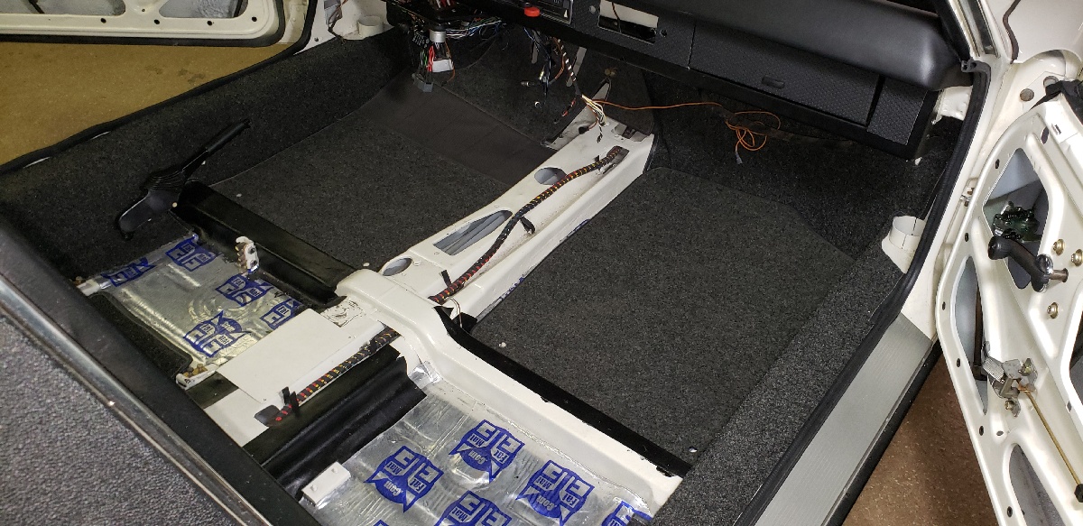

Then into the front trunk, this carpet required steam to fit
gms
post Mar 19 2020, 09:28 PM
Post #231
Posts: 2,755
Joined: 12-March 04
From: Chicagoland
Member No.: 1,785
The carpet looks good with the NOS driver and passenger mats

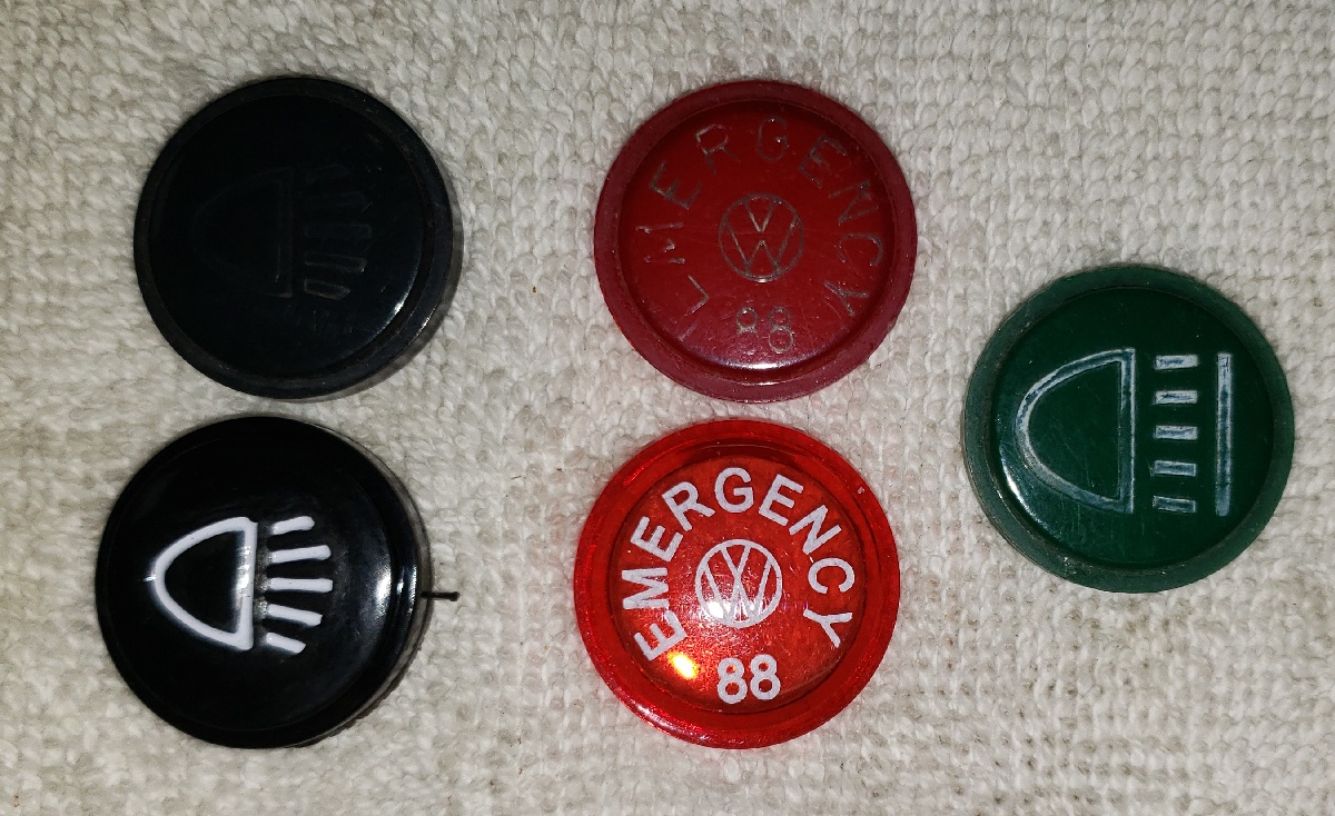

The correct Headlight and Emergency Flasher bezels arrived today!
