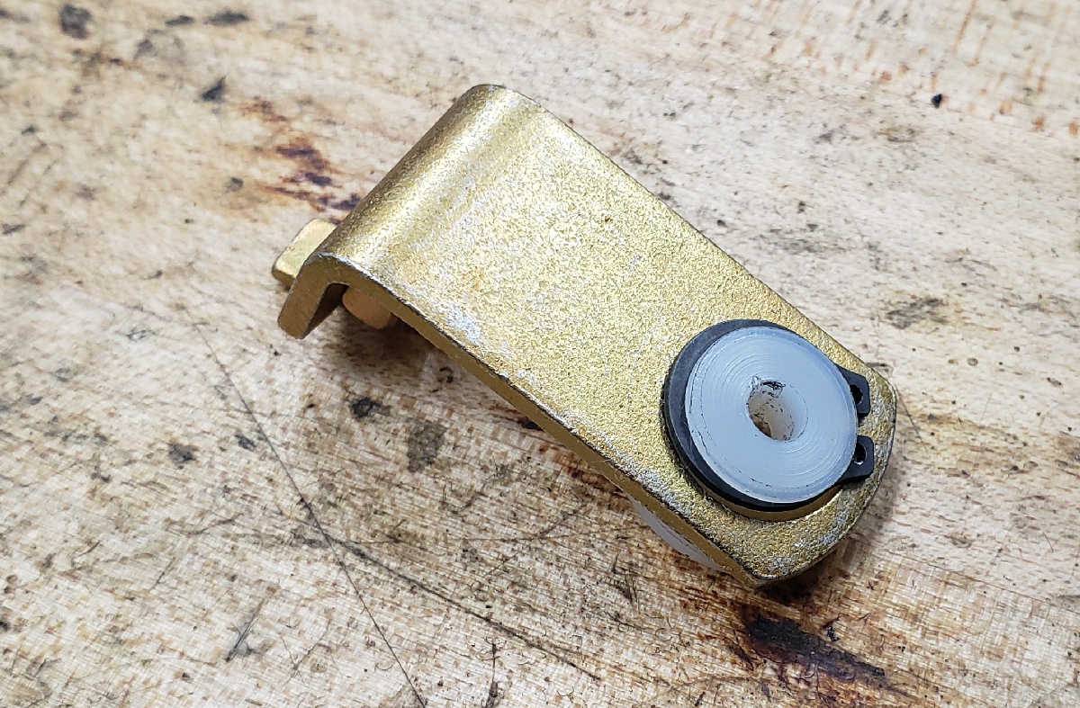

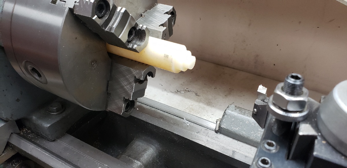

@Bartlett 914 custom made a bushing for the hand throttle control.
Thanks Mark!

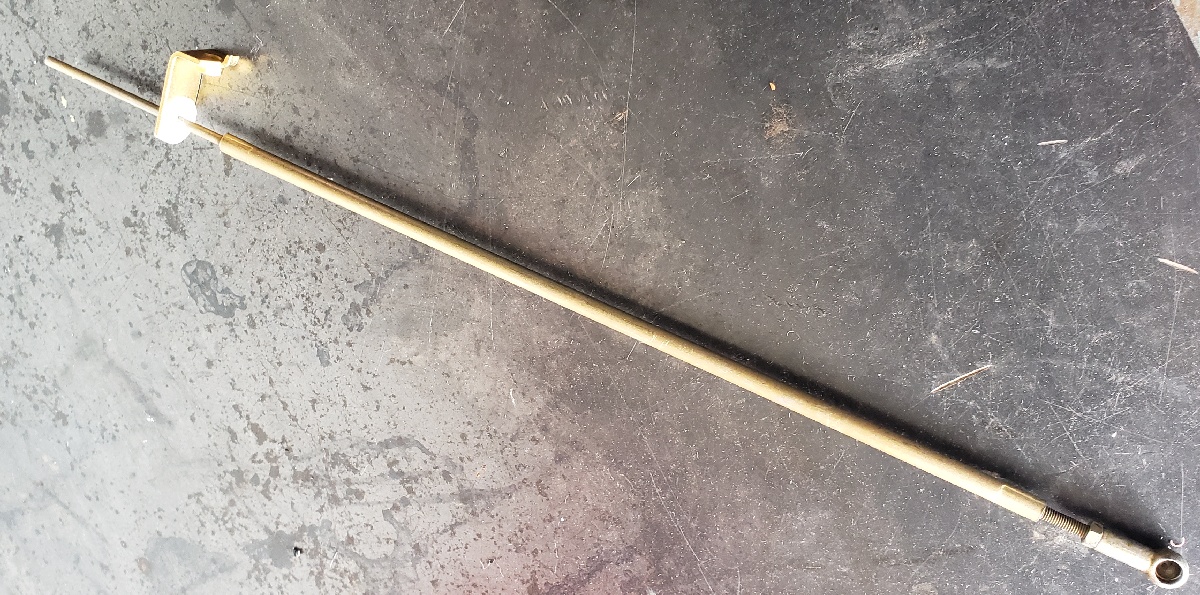

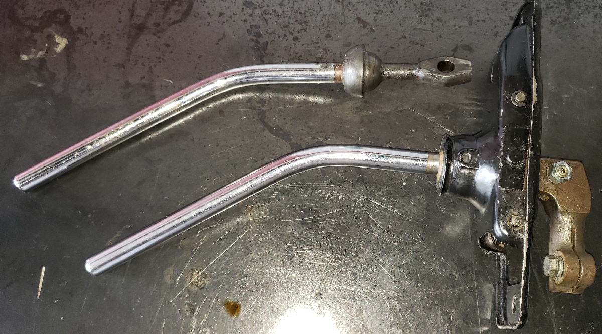

The shift lever was too rusty to put in this car so I switch it out.
gms

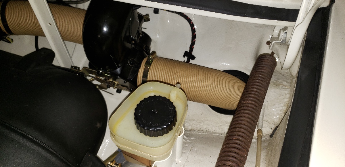

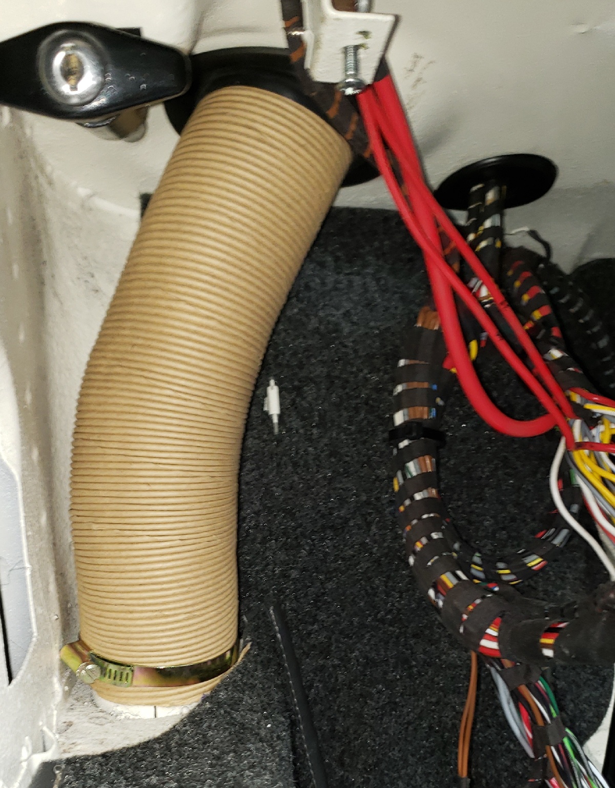

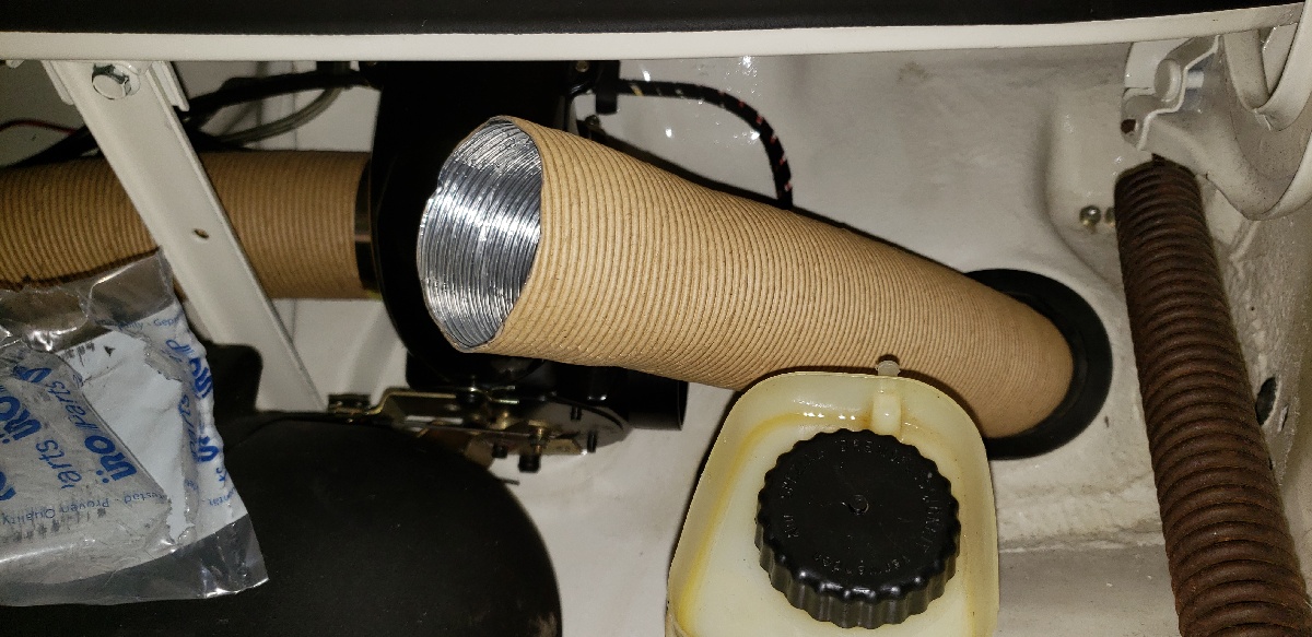

finished installing the last air hose under the dash

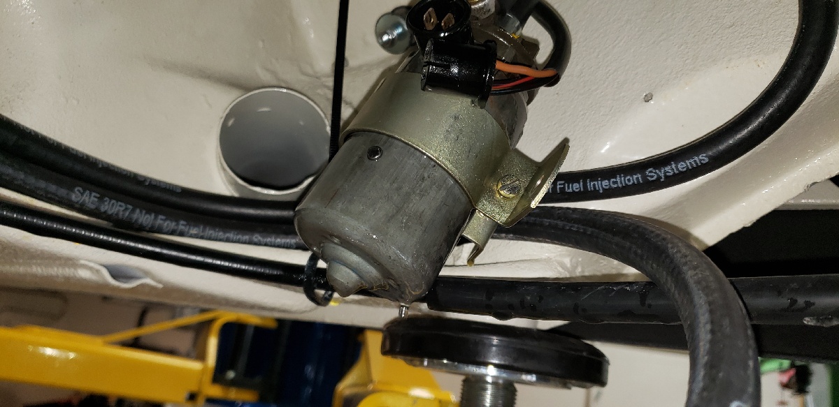

I was all ready for start-up and then I found a seal on the fuel pump went bad, fuel poured out on the floor.

QUOTE(gms @ May 26 2020, 02:23 PM) *
NOS pump?
gms
post May 26 2020, 06:28 PM
Post #348
Posts: 2,755
Joined: 12-March 04
From: Chicagoland
Member No.: 1,785
QUOTE(RoadGlue @ May 26 2020, 05:24 PM) *
NOS pump?
No it was used, probably dried out over time

QUOTE(gms @ May 24 2020, 08:17 AM) *
Thanks Mark!
Are these available? If so, I'd take 2. Glad to pay for custom work.
Greg

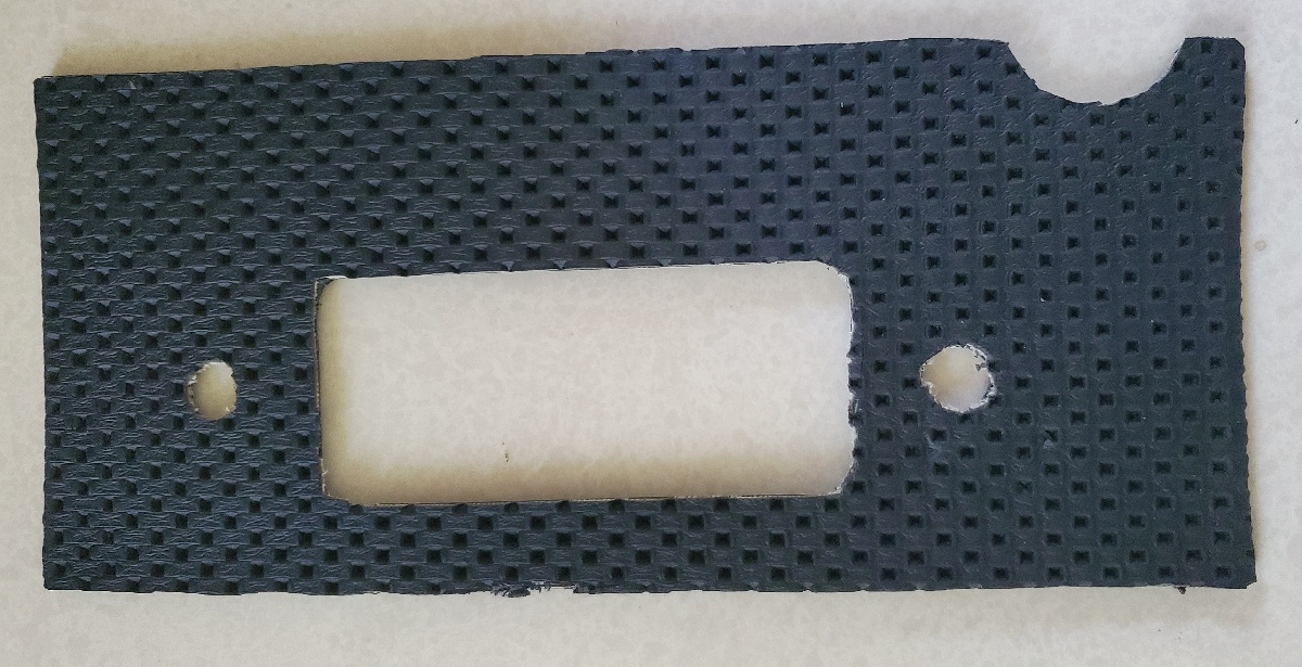

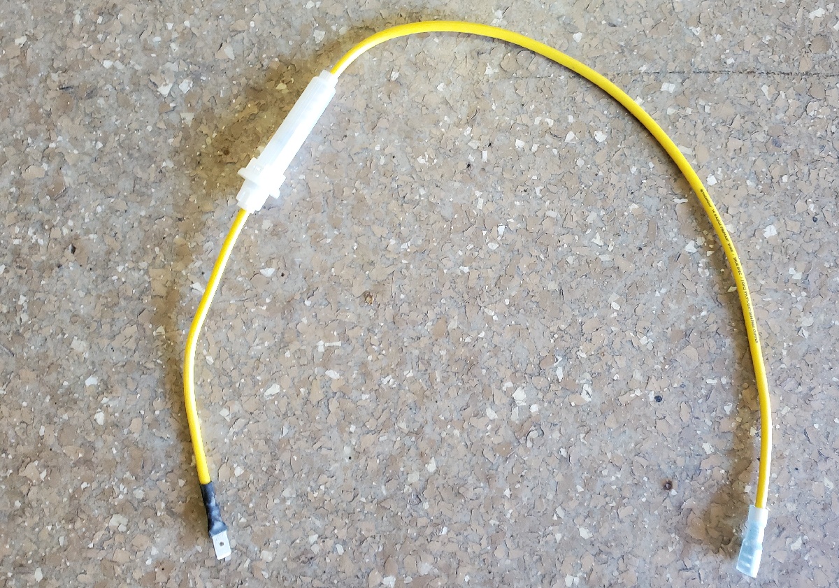

way behind on posting pictures

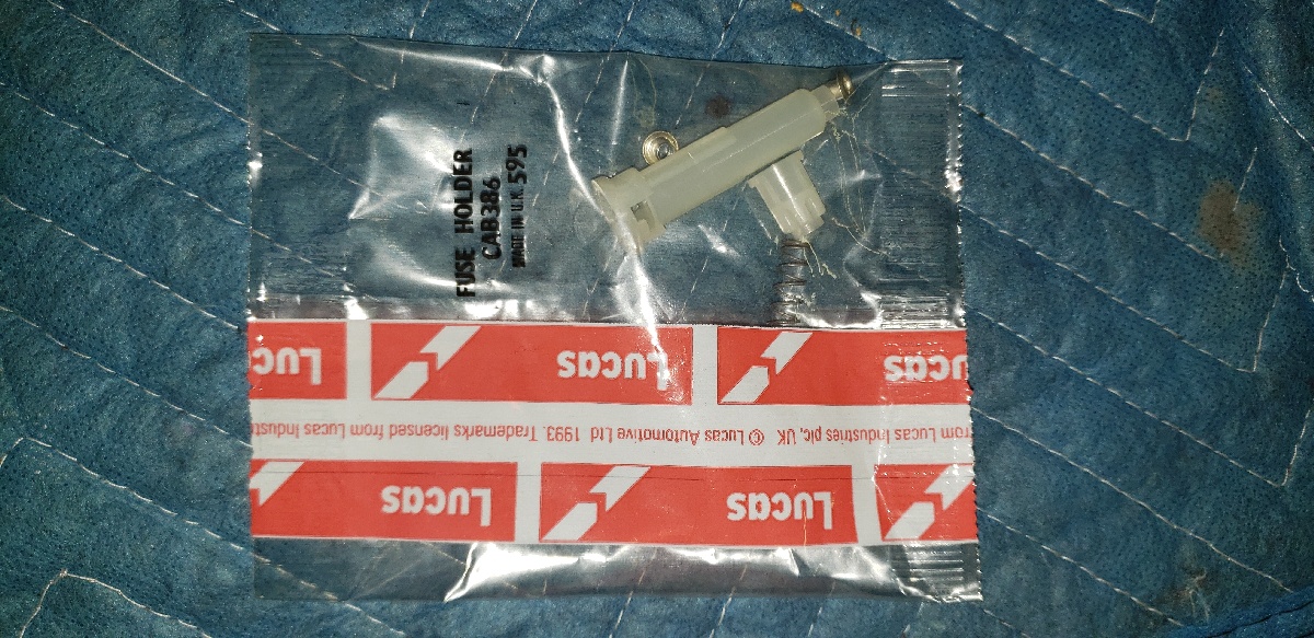

Finished radio plate basketweave
Made the radio power cord with fuse using an old Lucus kit.

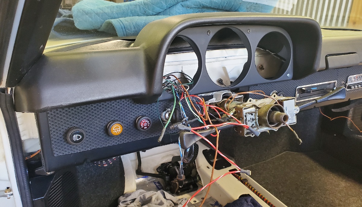

switches in dash

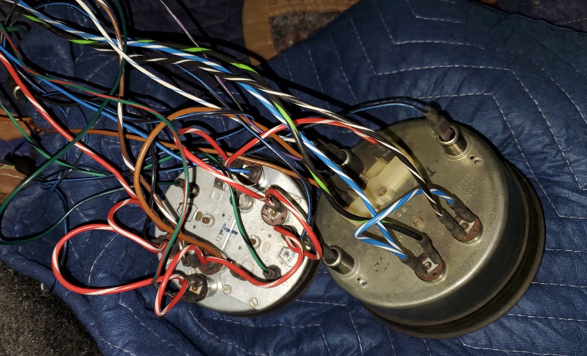

gauge wiring

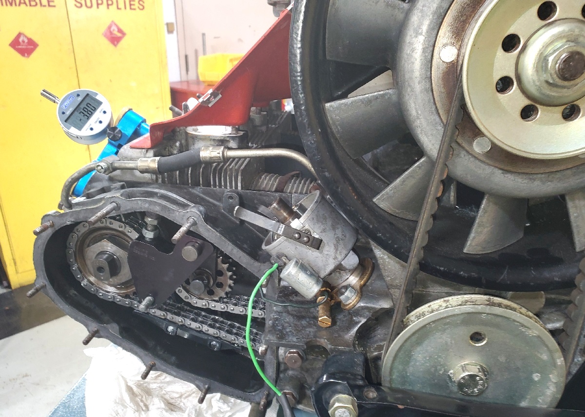

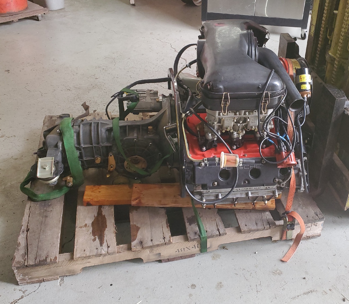

The build has taken a detour! After many attempts to start the car it is just not possible to get the timing correct. It did seem like the cam timing was off so I gave @sixnotfour a call, went thru other possibilities and as it turns out the engine builder did set the cams incorrectly! (IMG:style_emoticons/default/hissyfit.gif)
I pulled the motor and brought it to Kinnaman’s ( @Bartlett 914 ) shop which is nice and clean to not only set the cam timing but also add rocker arm seals.
RoadGlue
post Jun 25 2020, 10:47 AM
Post #355
Sonoma County Gear Head
Posts: 2,034
Joined: 8-January 03
From: Santa Rosa, CA
Member No.: 108
Known builder, or someone's friend of a friend?
gms
post Jun 25 2020, 11:39 AM
Post #356
Posts: 2,755
Joined: 12-March 04
From: Chicagoland
Member No.: 1,785
QUOTE(RoadGlue @ Jun 25 2020, 11:47 AM) *
Someone local to Bill
sixnotfour
post Jun 25 2020, 11:42 AM
Post #357
Posts: 11,357
Joined: 12-September 04
Member No.: 2,744
Another incident today with a Turbo...many shop hrs...Ya your right cam 180 out. (IMG:style_emoticons/default/dry.gif)

Member No.: 1,785
The rocker arm shafts moved after only trying to start the car
sixnotfour
post Jun 25 2020, 12:51 PM
Post #359
Posts: 11,357
Member No.: 2,744
QUOTE(gms @ Jun 25 2020, 11:59 AM) *
When you pull the covers you will see there is narrow web and a thick web..So it will appear as your pic. on the thick web side

Cams set, just need to go thru the rest of the rocker shafts now
