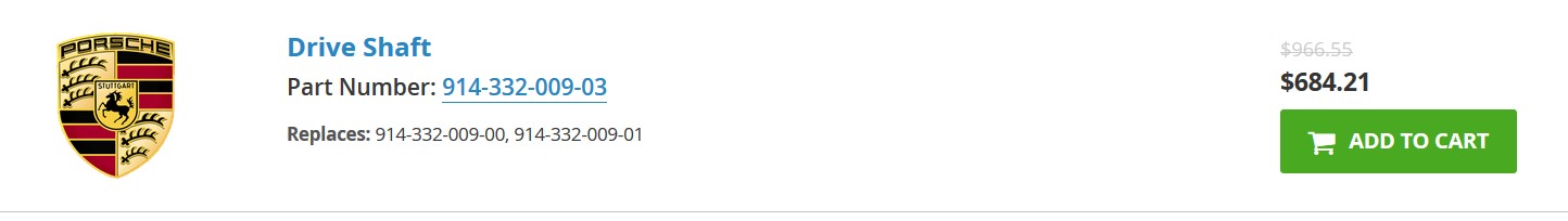

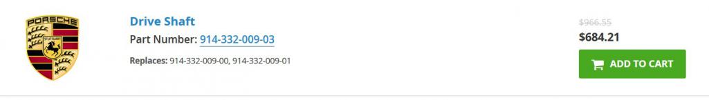

74 parts cat.
This confirms they've gotten their parts numbers mixed up. If you plug the -6 axle number into the Porsche parts lookup, you get this:
But it appears what you get is the old 914 332 009 01 part so the replacement note is backwards. Not a big deal when buying a complete axle assembly, but a big problem when just replacing joints.
