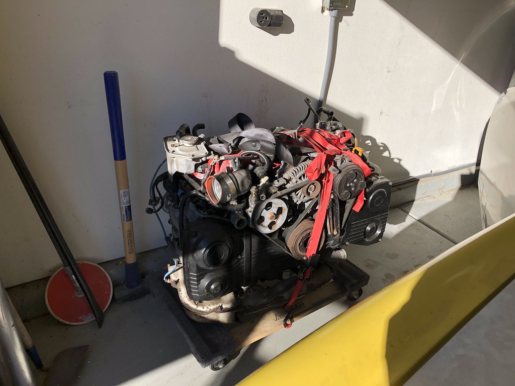

I picked up a 2004 STI motor from an auction for 1200 bucks plus shipping. The description said it was part of a theft recovery and was missing the turbo. There wasn't a lot of detail, other than 104K miles on the clock and a receipt in the glove box that the timing belt had been changed at 90K miles. I knew it might end up being a box of rocks, but I figured that all the peripherals - manifolds, brackets, oil pan, etc would be worth what I paid. I decided to roll the dice and hope that the heads and internals weren't junk.
I used Uship to find a cheap carrier, and for 300 bucks UPS delivered the motor to my driveway. Pretty good deal if you ask me.
(IMG:http://www.914world.com/bbs2/uploads_offsite/live.staticflickr.com-22225-1554908516.1.jpg)
The motor didn't look too bad, but it smelled terrible. I can't really describe the stank, but it was bad. It smelled like water had mixed with oil and festered for several months. Damn! probably a blown head gasket. Oh well, I thought, I would at least use it for some mock up.

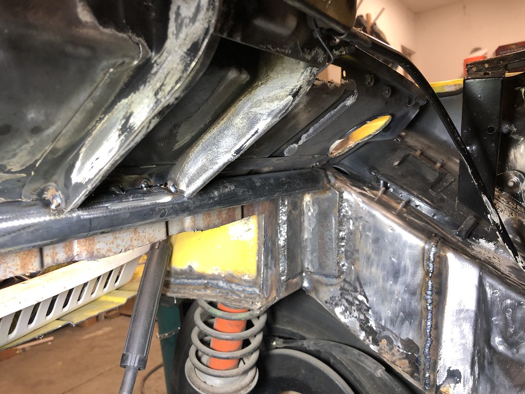

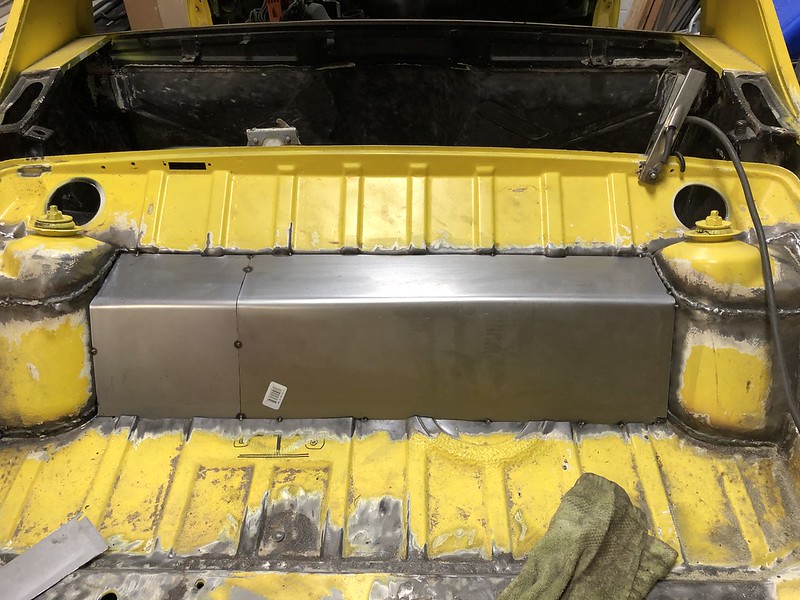

Mocking the motor up, I verified that I would need to cut some of the trunk to fit the 20G turbo, the clutch slave, and starter.
I wanted to brace the two rear towers, strengthen the corner that connects to the long, and have something to fasten the trans pitch stop to. I plan to go water/air IC and route the charge pipe similar to DBCooper's setup, over to the driver's side.
(IMG:http://www.914world.com/bbs2/uploads_offsite/live.staticflickr.com-22225-1554908653.3.jpg)
(IMG:http://www.914world.com/bbs2/uploads_offsite/live.staticflickr.com-22225-1554843164.7.jpg)
I think this turned out pretty good - even though I used a ghetto homemade metal brake. Basically pipe wrenches, a vice, a 2x4, and a piece of angle iron.

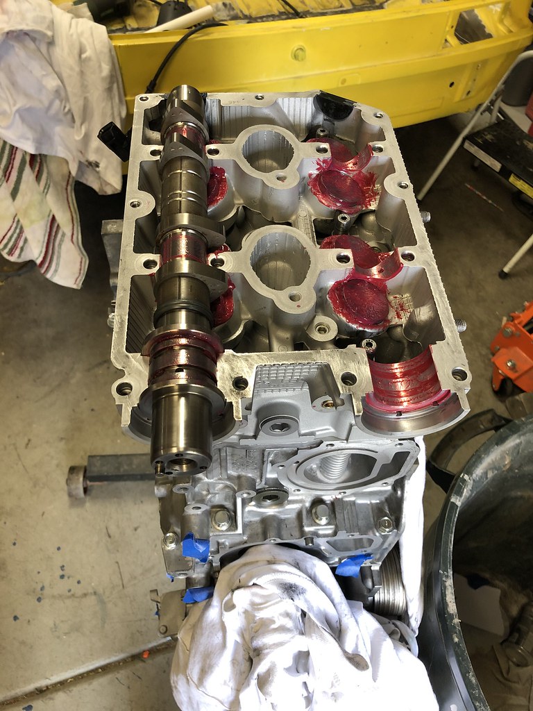

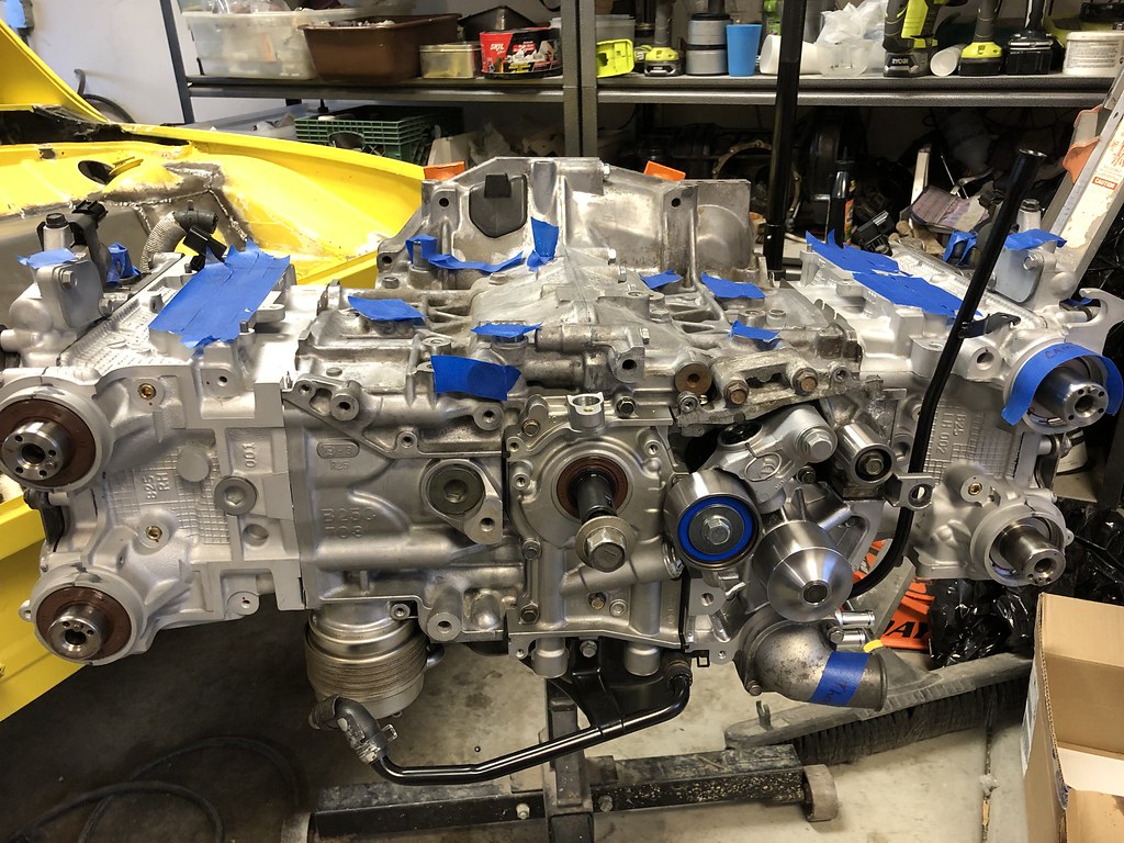

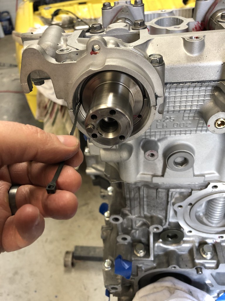

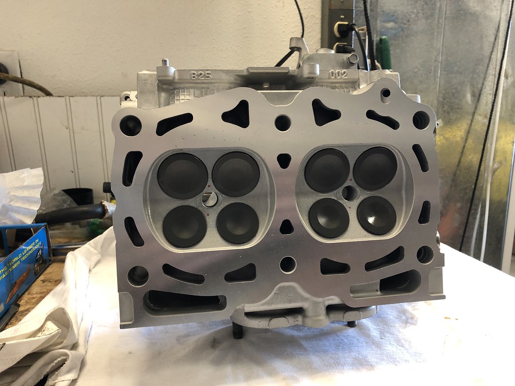

I built the shortblock a couple of weeks back. I was in a bit of a hurry and got the heads torqued, cams installed, AVCS installed, and the valve covers on. As I was cleaning up my bench, I noticed a ARP washer sitting under a rag... (IMG:style_emoticons/default/headbang.gif)
I panicked a little, threw a wrench, and practiced a few farm words. While building the block, I'd had a little scare when I was torquing one of the head studs when the timesert shifted a little and made a popping sound. I was sure I had just stripped my newly built block, so I pulled the head back off and checked everything. Once I realized what had happened and that it was a false alarm, I put everything back together using one of two spare headgaskets I had - but in my fit, I forgot to put one of the washers on. (IMG:style_emoticons/default/headbang.gif) (IMG:style_emoticons/default/headbang.gif)
So I spent some time taking the head back off, burning another head gasket, and installing the washer I forgot. While the head was back off, I took a picture for your viewing pleasure.
(IMG:http://www.914world.com/bbs2/uploads_offsite/live.staticflickr.com-22225-1555360241.1.jpg)
These heads were rebuilt by a local shop with new valves, guides and springs. I wish I had a before picture, because these things were a mess.
Got the head torqued down AGAIN, with the washer installed, and started installing the cams.
(IMG:http://www.914world.com/bbs2/uploads_offsite/live.staticflickr.com-22225-1555360242.2.jpg)
I hate doing things over because of my own stupidity.

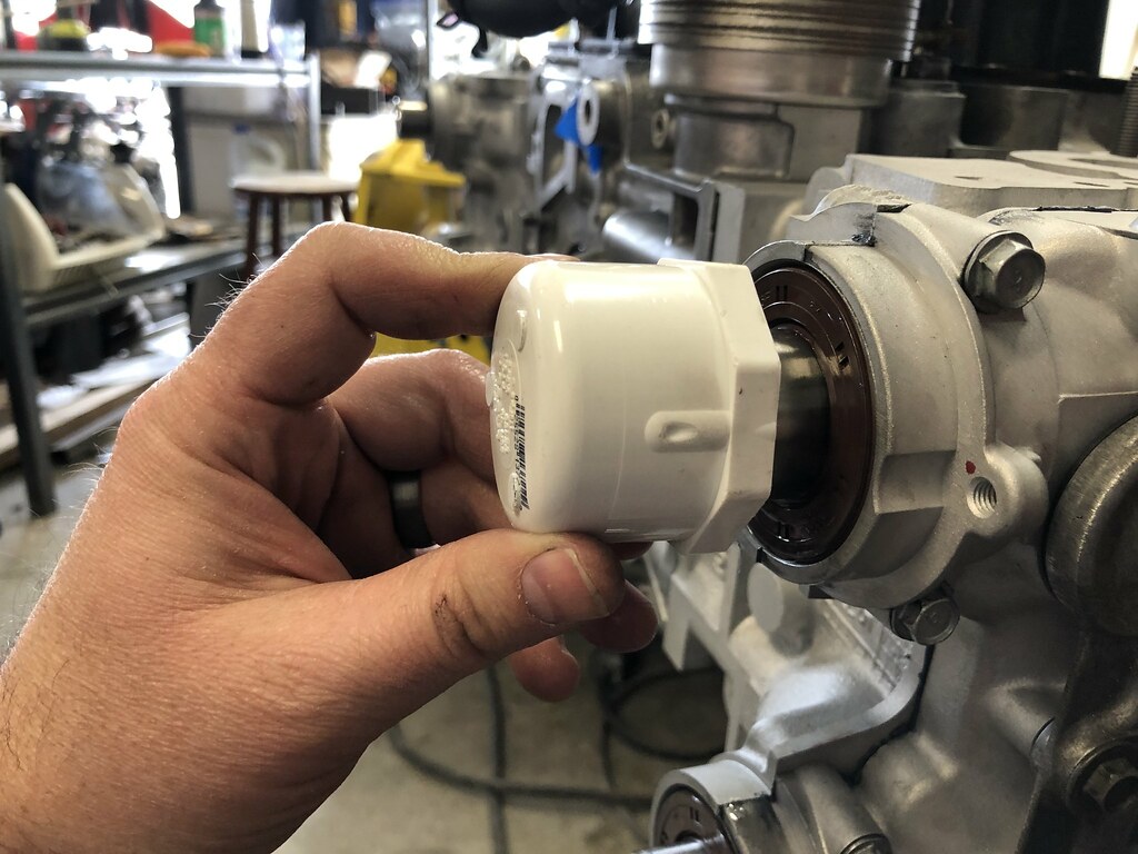

Also a few Subaru motor building tips:
First - when installing cam seals, this is the best/cheapest tool out there. The proper Subaru tool is spendy - this baby costs 80 cents and has a perfect collar that prevents the seal from being driven too far.
(IMG:http://www.914world.com/bbs2/uploads_offsite/live.staticflickr.com-22225-1555360247.5.jpg)

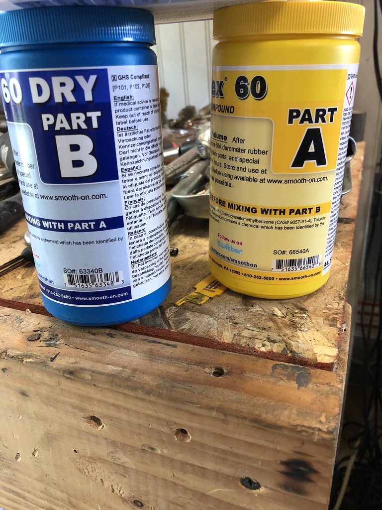

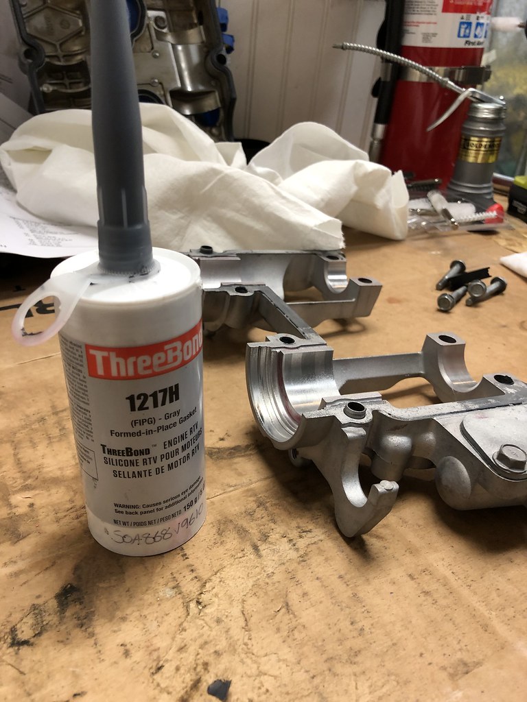

Second - Subaru recommends using a gasket filler when assembling engines. There's a lot of debate here on what to use. Some guys use ultra grey RTV, or Hondabond as an alternative to the Subaru filler. I REALLY like and prefer the Subaru ThreeBond stuff
(IMG:http://www.914world.com/bbs2/uploads_offsite/live.staticflickr.com-22225-1555360247.6.jpg)
Its much easier to work with than the thick Hondabond, and I've yet to have a motor leak with it. It also cleans up easier - you know if you have to pull the head off cuz you forgot a washer. The only challenge with it, is that it can be kinda runny. You don't have to use a lot, but when you're working around the AVCS cap, there are some oil galleys that are right next to where you're supposed to seal. I use a small ziptie right after torquing the cap to push through the galley and twist around to clean out the filler. If you shine a flashlight from behind the cap toward the front, you can see if there is anything blocking the galley.
(IMG:http://www.914world.com/bbs2/uploads_offsite/live.staticflickr.com-22225-1555360248.7.jpg)
Lets just say I learned this trick at the school of hard knocks - a seized cam is no fun.

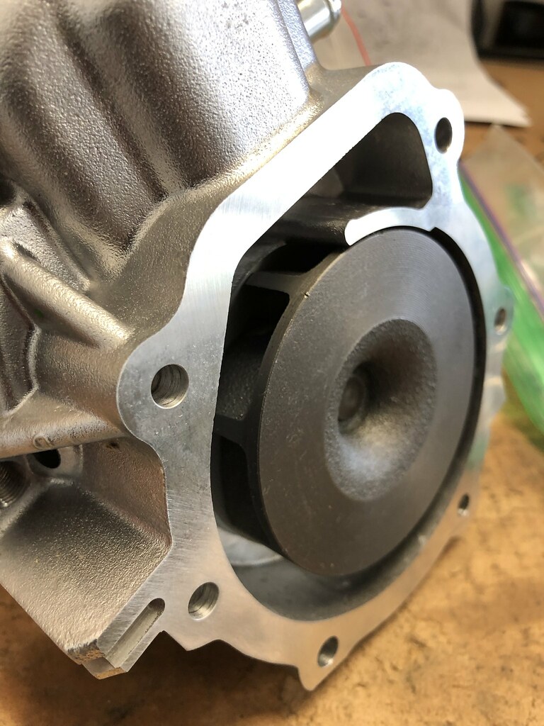

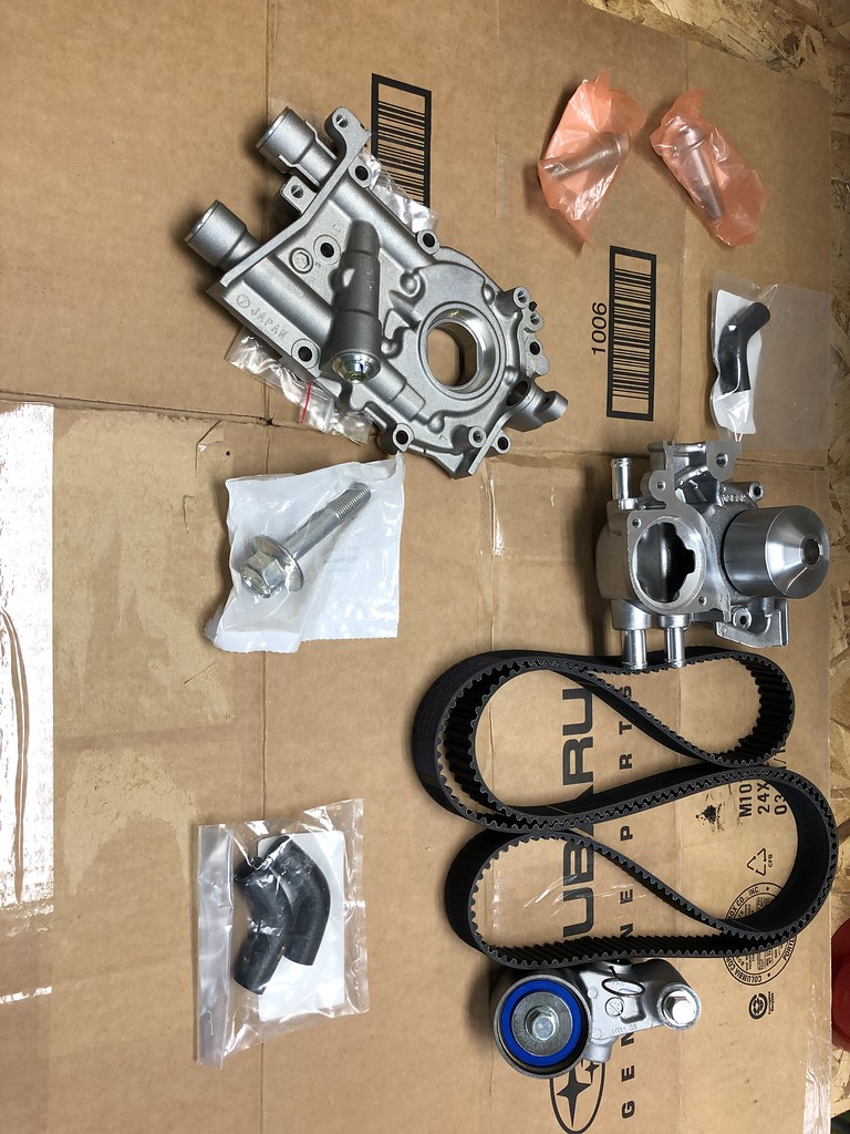

Third - There are two OEM water pumps for the Subaru WRX/STI turbos. At some point Subaru started manufacturing a cheaper water pump with a stamped impeller. Crawford has a few tech docs that show the differences in flow between the two pumps. Hands down, the cast impeller outperforms the stamped one. You can still buy OEM cast impeller pumps for about the same price as a stamped one. With the additional volume and coolant line lengths in these conversions, it makes sense to me to go for the cast version.
(IMG:http://www.914world.com/bbs2/uploads_offsite/live.staticflickr.com-22225-1555360252.8.jpg)
So, I got 2 cam seals, oil pan, oil cooler, tensioner, water pump, and one of the idlers installed. For some reason my gasket kit only had 2 cam seals, so I have to wait a few days for the others to show up.
(IMG:http://www.914world.com/bbs2/uploads_offsite/live.staticflickr.com-22225-1555360252.9.jpg)

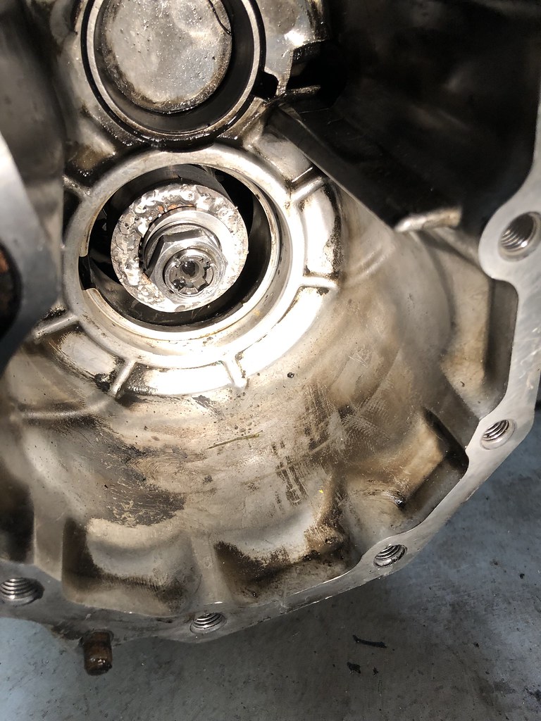

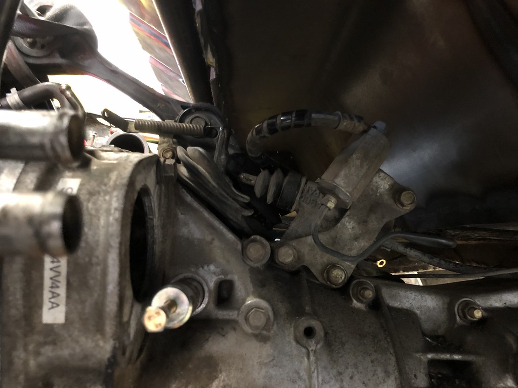

Sorry, not many updates, I've been in India for a few weeks with work. I got home on Saturday and was in a half asleep coma for a couple of days with the jet lag. Travel to Asia can really suck but it pays for these types of projects. (IMG:style_emoticons/default/smile.gif)
I did manage to get the timing belt, and the timing cover installed (twice) on my motor. In my jet lagged stupor, I got the timing covers on without putting the cam avcs caps on. So I had to pull it all back off and put the caps back on. Not a huge deal, but I'm glad I caught it.
I also pulled all the fuel lines, evap, and harness from the intake. I plan to strip the flaking paint off and repaint it.

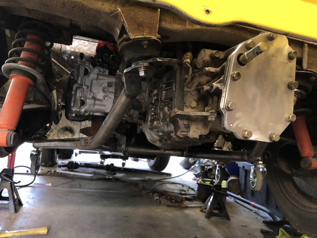

I read through another thread and found that my coldwater cradle might put my suby trans a couple of inches too far forward. This creates too aggressive an angle for the CVs. Can anyone confirm this is accurate?

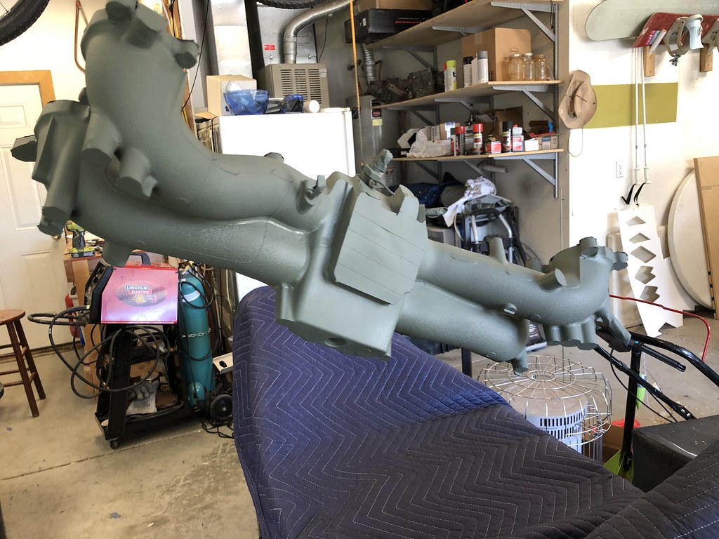

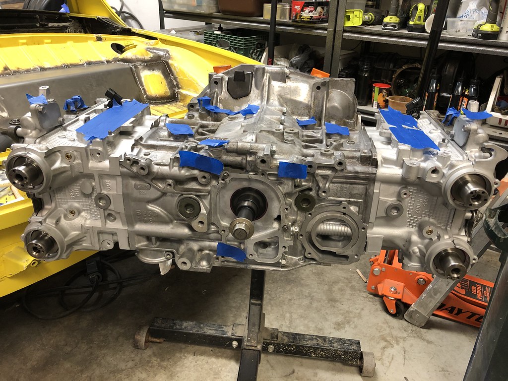

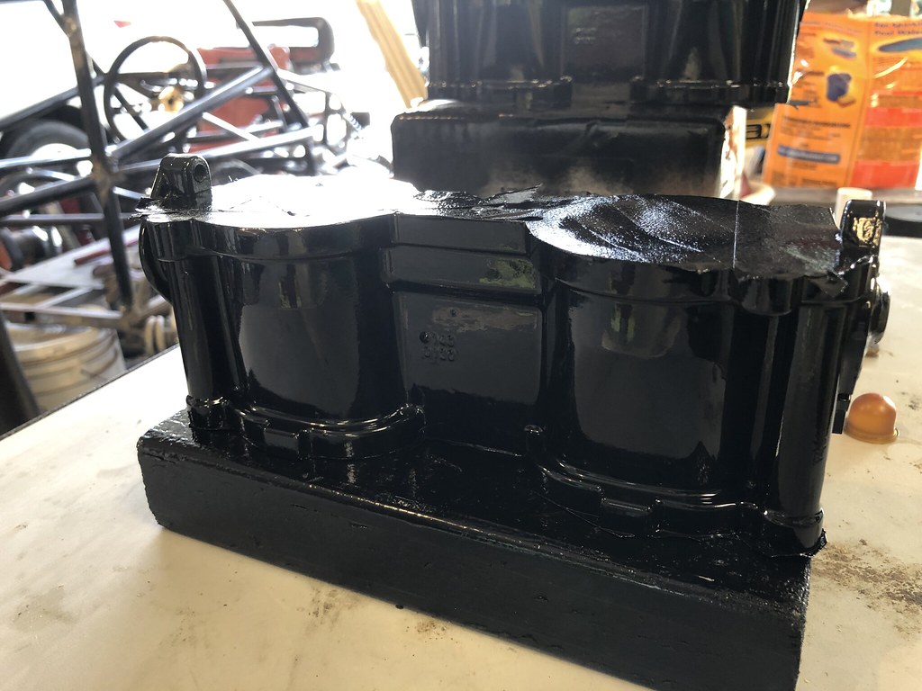

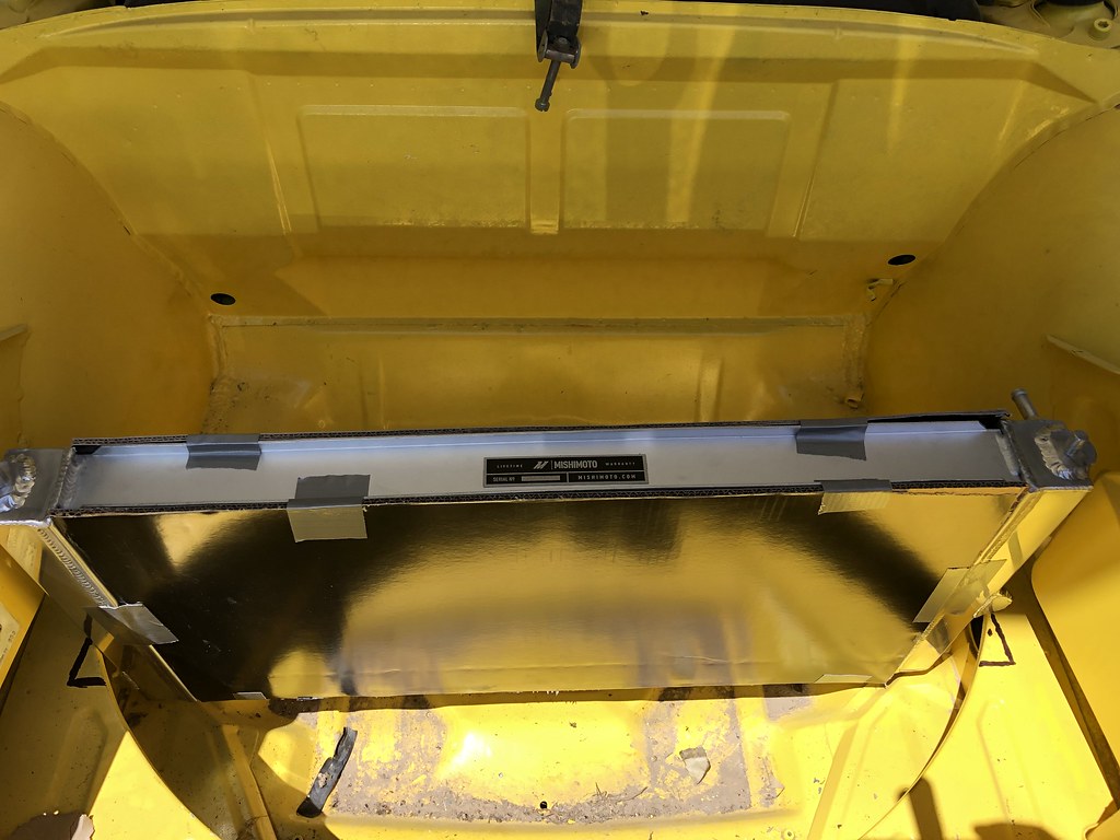

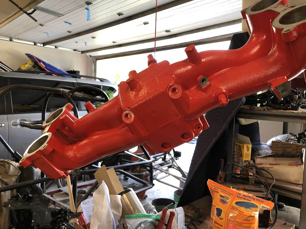

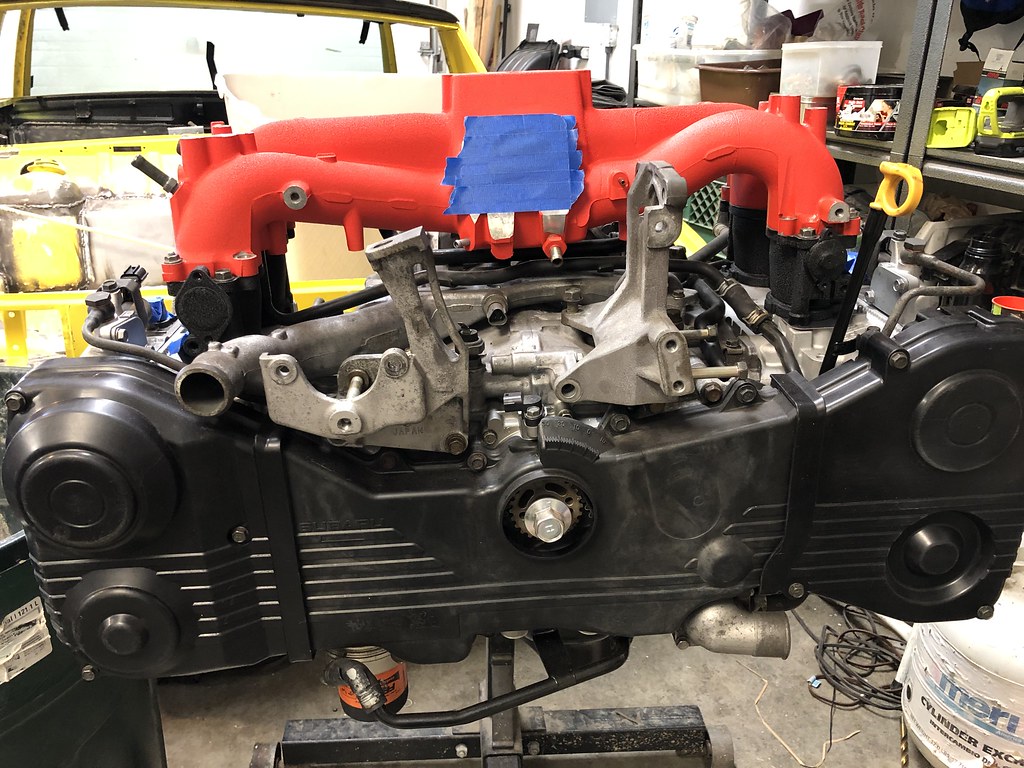

I got quite a bit done on the car last week. I decided to paint the chipped intake and try to get it back to the original red. NHT makes a wrinkle paint that is supposed to be tough as nails. So I put some chemical strip on the intake and brushed off the old paint. I hit it with some self etch primer and 3 or 4 thick coats of this stuff. I also did the TGV butterfly valve delete mod and painted the TGVs in black wrinkle.
(IMG:http://www.914world.com/bbs2/uploads_offsite/live.staticflickr.com-22225-1559055252.1.jpg)
(IMG:http://www.914world.com/bbs2/uploads_offsite/live.staticflickr.com-22225-1559055255.2.jpg)
(IMG:http://www.914world.com/bbs2/uploads_offsite/live.staticflickr.com-22225-1559055256.3.jpg)
(IMG:http://www.914world.com/bbs2/uploads_offsite/live.staticflickr.com-22225-1559055256.4.jpg)
It turned out pretty good, but I couldn't live with the nasty A/C and pwr steering bracket. so I painted those two and the DBW throttle body. Then I put the crusty exhaust, alternator, A/C compressor, and crank pulley back on for mock up. I'm definitely going to replace the exhaust manifold and crank pulley.
(IMG:http://www.914world.com/bbs2/uploads_offsite/live.staticflickr.com-22225-1559055257.5.jpg)

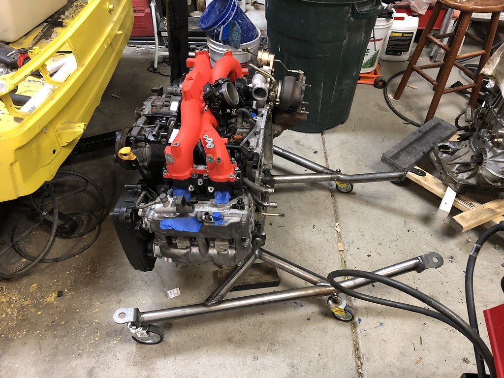

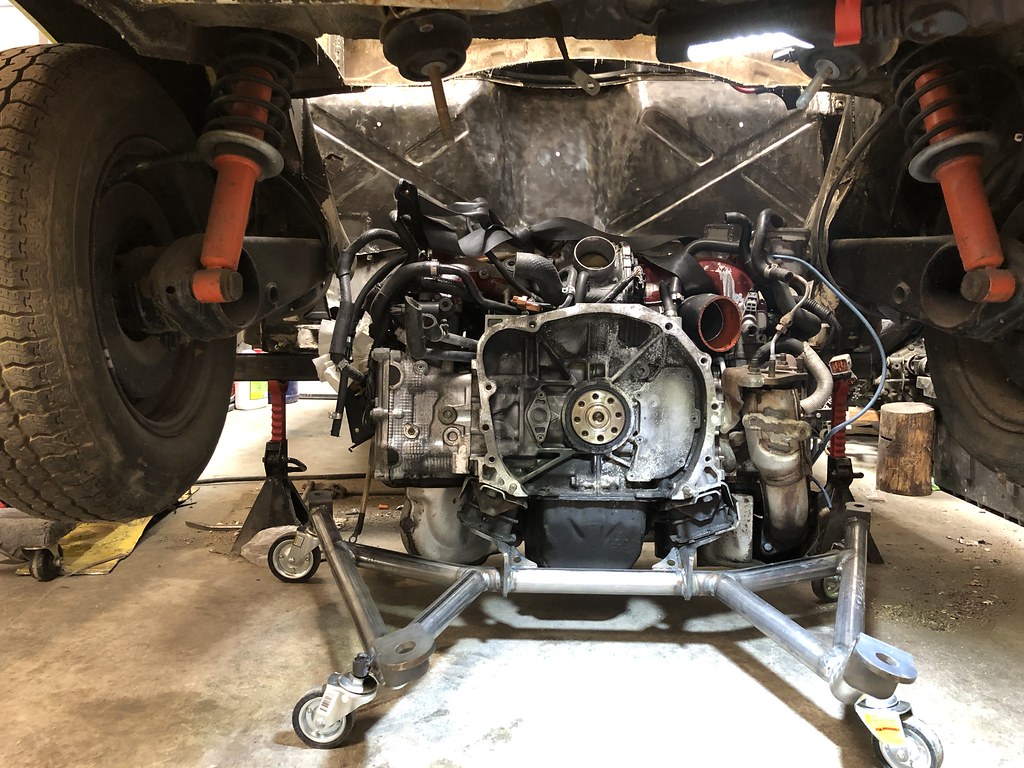

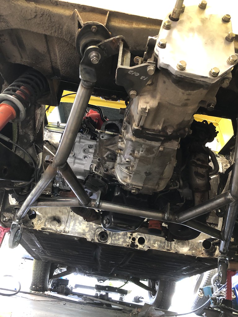

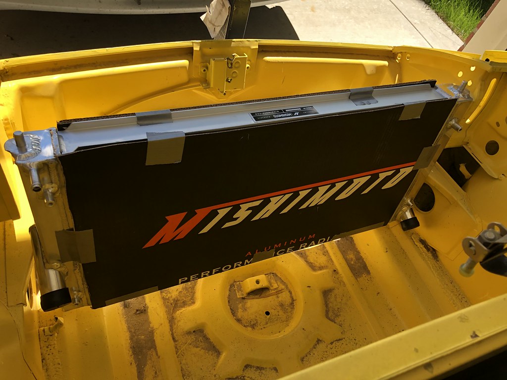

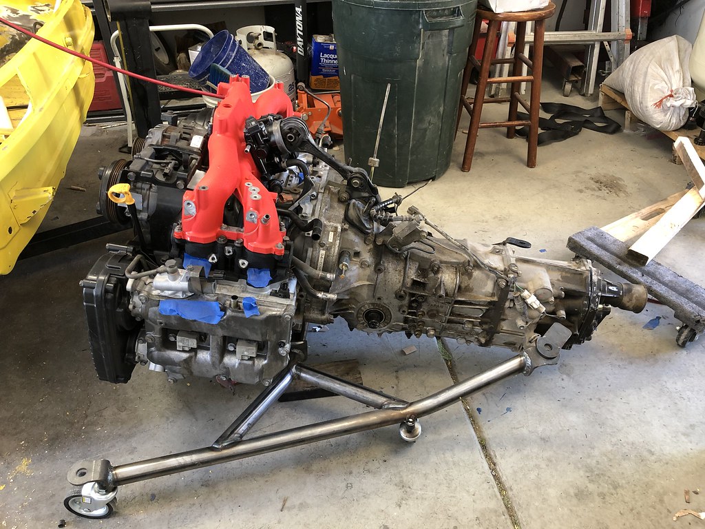

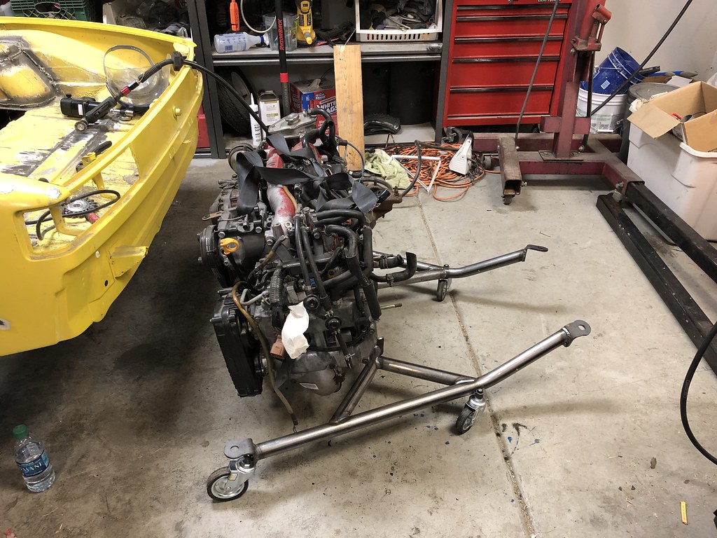

I also got the turbo set temporarily, the motor is off the stand and sitting on the cradle for some mock up. Now its time to work the transmission over.

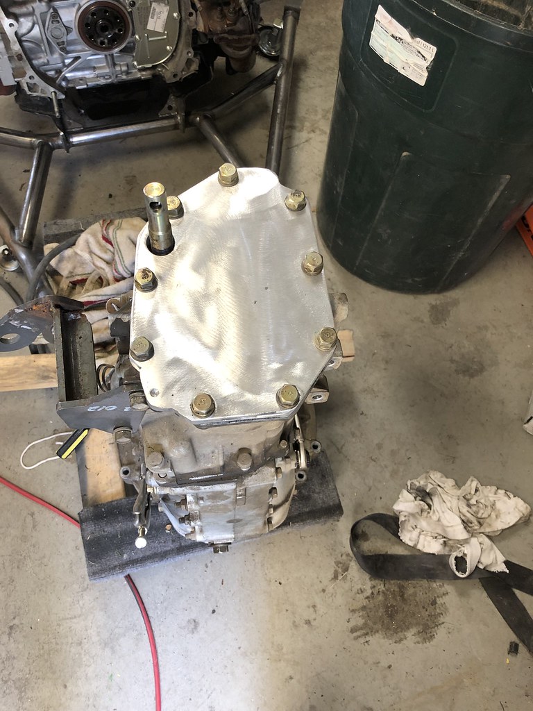

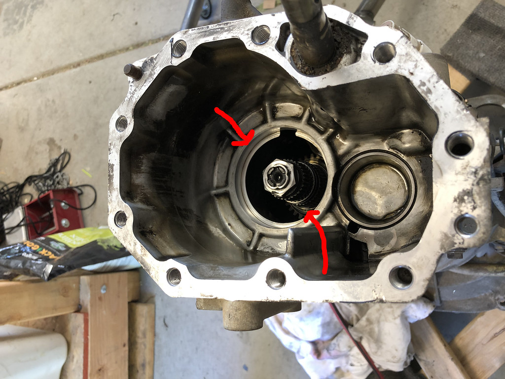

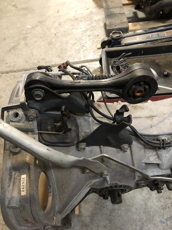

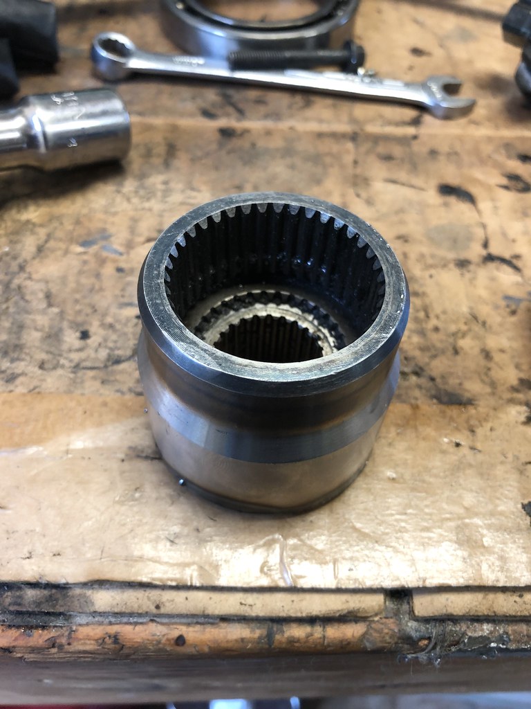

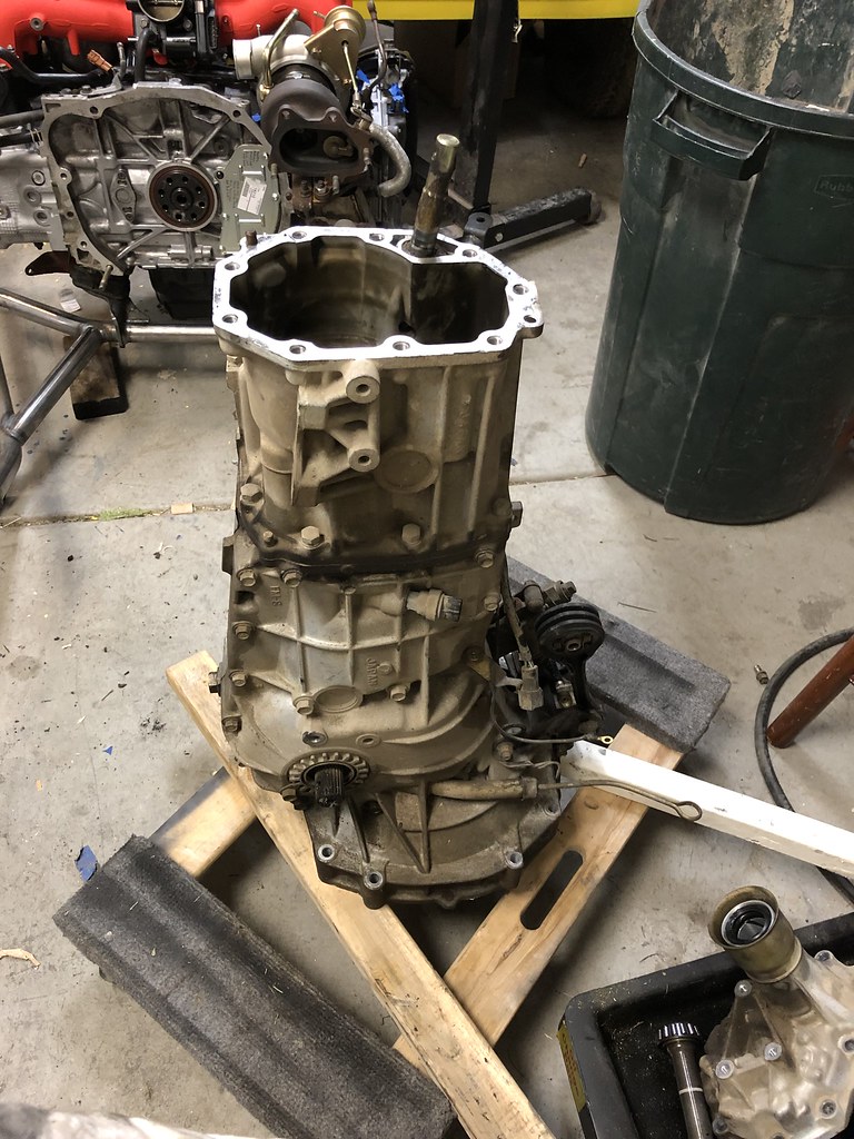

I found another transmission that I couldn't pass up on. I had originally found a '99 impreza RS transmission to use, but after a bit of research realized that the push-type clutch, and the hydraulic conversion were a bit of a pain to get to work with the STI motor. So I picked up an '04 WRX tranmission with a broken center diff for cheap.
(IMG:http://www.914world.com/bbs2/uploads_offsite/live.staticflickr.com-22225-1559060463.1.jpg)

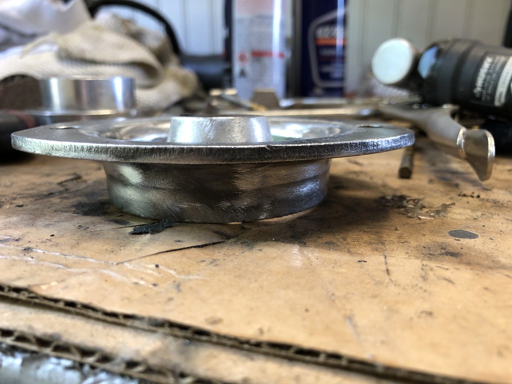

I pulled the nose cone off and disassembled the center diff. I expected to see it in bad shape, but it wasn't too bad. The little spacer on the spider gear had broken, but it hadn't done any major damage aside from locking the rear in. I guess I didn't realize that the WRX had a clutch pack in the center diff - it had definitely seen better days and went right in the trash.
(IMG:http://www.914world.com/bbs2/uploads_offsite/live.staticflickr.com-22225-1559060465.2.jpg)

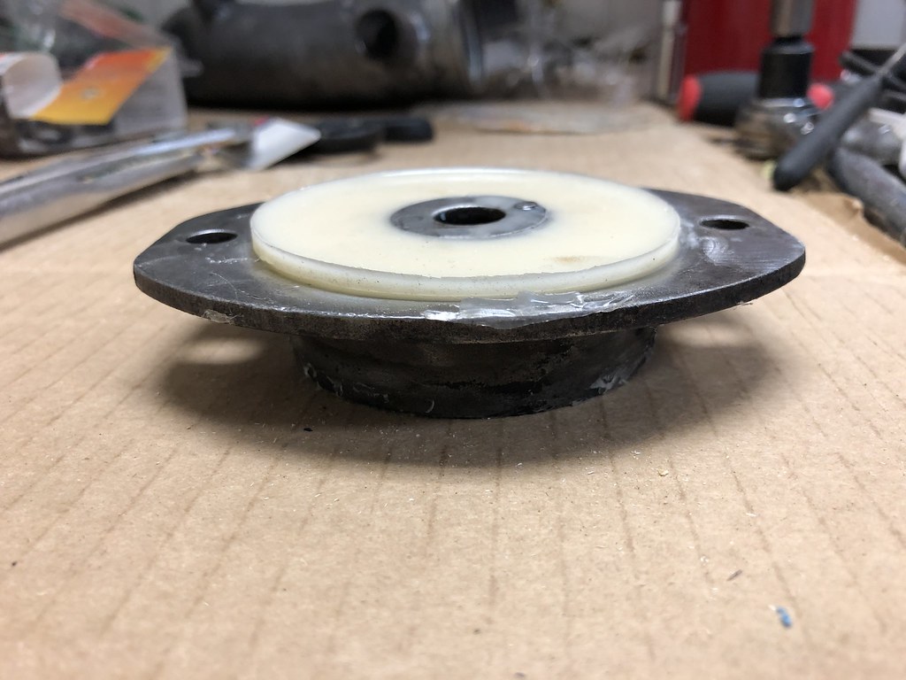

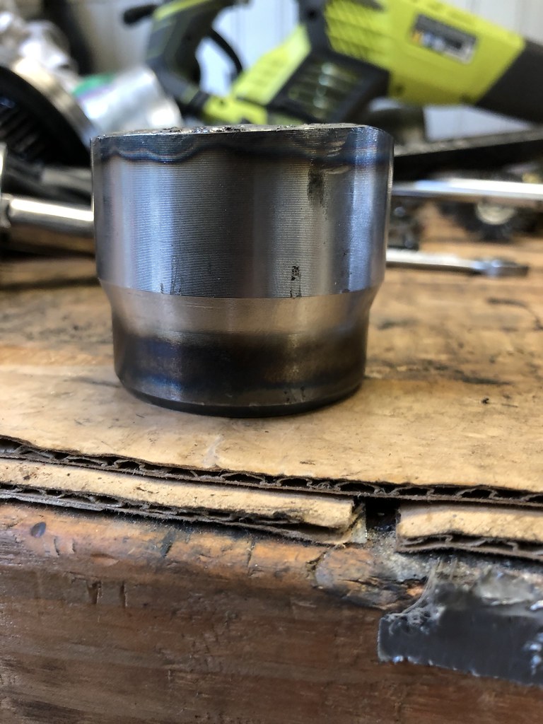

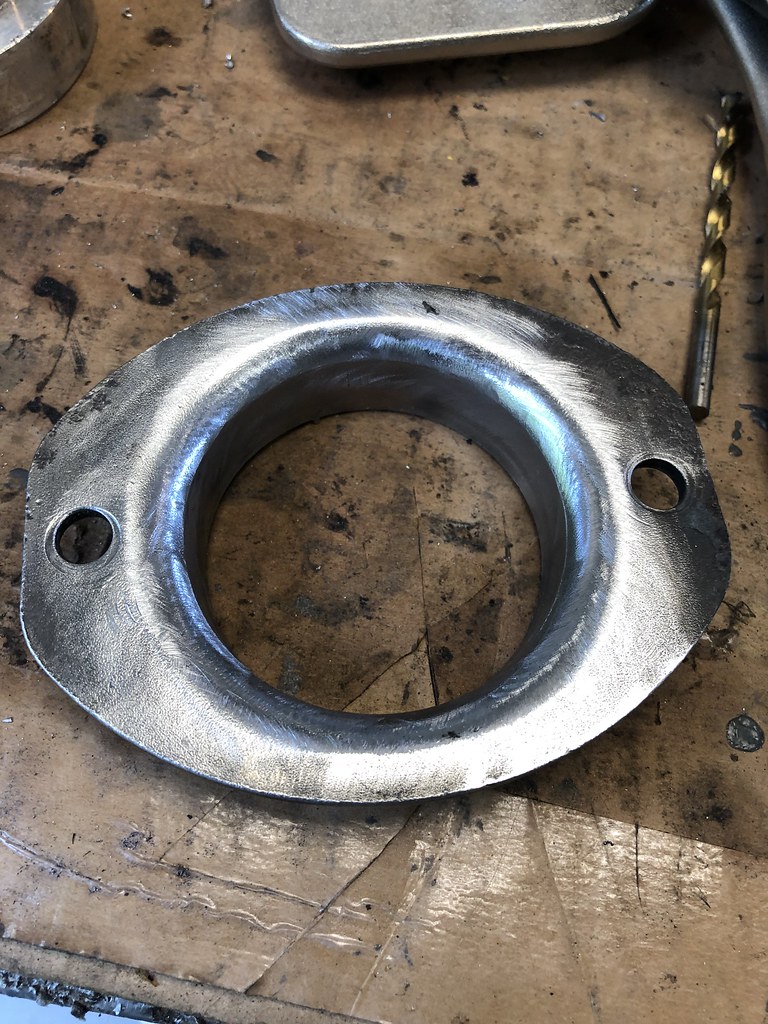

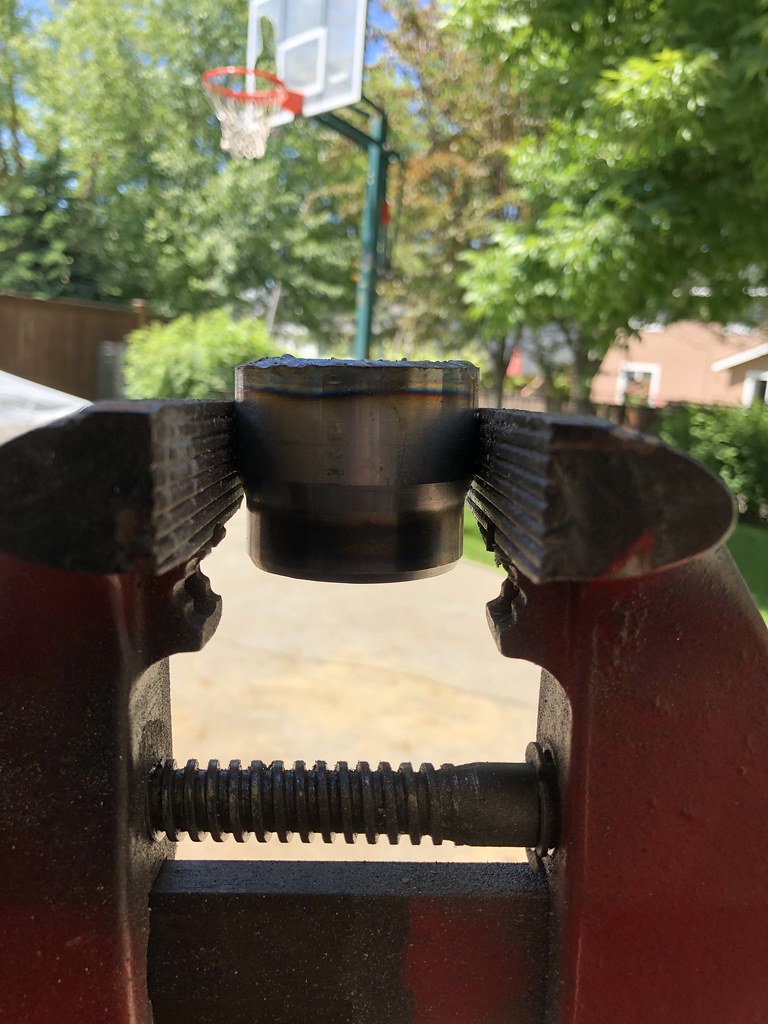

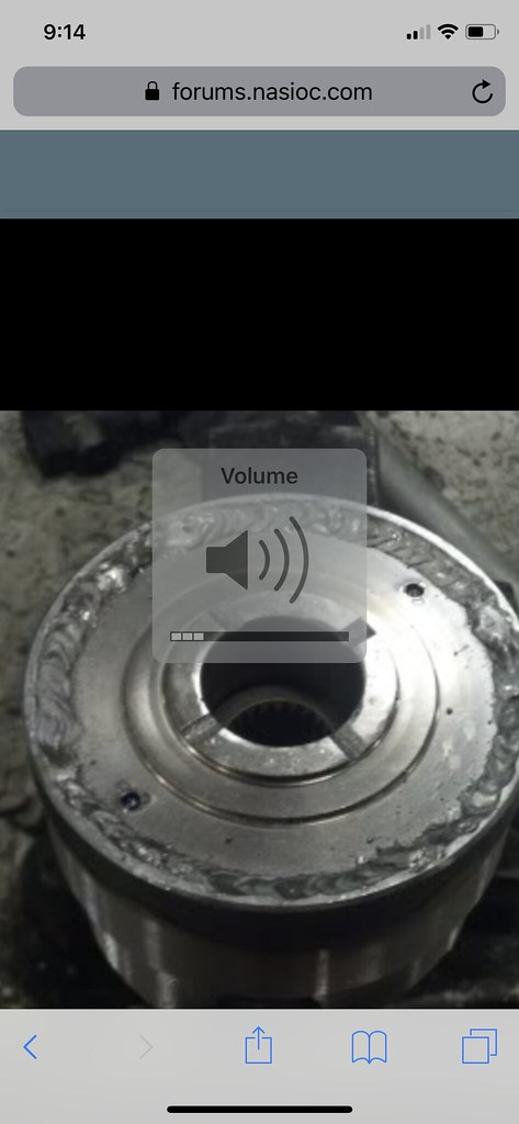

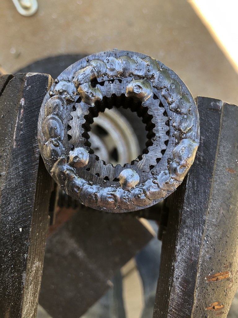

So I thought I'd take a crack at making a center lock. I started following this write up, but realized that there are some differences in this transmission so it threw me off a bit.
The write up says to slice this:
(IMG:http://www.914world.com/bbs2/uploads_offsite/forums.pelicanparts.com-10736-1268020285.3.jpg)
then weld the inside sleeve to the outside sleeve, and cut the flange off -
(IMG:http://www.914world.com/bbs2/uploads_offsite/forums.pelicanparts.com-10736-1268020290.8.jpg)
(IMG:http://www.914world.com/bbs2/uploads_offsite/forums.pelicanparts.com-10736-1268020290.9.jpg)
You end up with this:
(IMG:http://www.914world.com/bbs2/uploads_offsite/forums.pelicanparts.com-10736-1268020292.11.jpg)
Here's my question. Why would you cut the flange off as it rides on the bearing that goes here?:
(IMG:http://www.914world.com/bbs2/uploads_offsite/live.staticflickr.com-22225-1559060466.3.jpg)
It seems like you would want to keep the sleeve on so it continues to sit on the bearing. The other question I have is if you use a cut sleeve (or use the Bremar spline locking spool) how do you prevent it moving backwards off the shafts?
Wouldn't it be better for me to do something like this?
(IMG:http://www.914world.com/bbs2/uploads_offsite/live.staticflickr.com-22225-1559060466.4.jpg)
Or just pull the spider gears and clutch pack out and weld here:
(IMG:http://www.914world.com/bbs2/uploads_offsite/live.staticflickr.com-22225-1559060467.5.jpg)
It would prevent the locked spool from moving laterally or horizontally and working its way off the splines??

I went back through each step and realized that you use the nut to keep it from backing out. I still think it needs to rest on the bearing to keep the shaft from moving up and down. Maybe I’m overthinking.

I had a couple of free hours last night, so I decided to take a crack at making a FWD locking spool out of a fooked WRX center diff. It was pretty straightforward and I was able to pull the little coupler off the shaft to tack in place. The welds penetrated pretty deep, so it should stay together (I hope it does). I put it back on with a lock washer and bent the little nut keepers back once I tightened it down. Here's to hoping it will withstand 300+ HP.
(IMG:http://www.914world.com/bbs2/uploads_offsite/live.staticflickr.com-22225-1559229186.1.jpg)
(IMG:http://www.914world.com/bbs2/uploads_offsite/live.staticflickr.com-22225-1559229187.2.jpg)
(IMG:http://www.914world.com/bbs2/uploads_offsite/live.staticflickr.com-22225-1559229188.3.jpg)
I thought I'd put the trans on the cradle and temporarily bolt it to the motor while I find some aluminum to make a back plate. I still need a clutch, but I can start mocking things in now.
(IMG:http://www.914world.com/bbs2/uploads_offsite/live.staticflickr.com-22225-1559229188.4.jpg)
Oh the bad things I'm going to do to this drive train....

I spent a few days in the garage this weekend on the conversion. At Chi-town's suggestion, I pulled the coupler back out and squared it off and rewelded; then put it back in with some locktite.
(IMG:http://www.914world.com/bbs2/uploads_offsite/live.staticflickr.com-22225-1559589080.1.jpg)
(IMG:http://www.914world.com/bbs2/uploads_offsite/live.staticflickr.com-22225-1559575286.1.jpg)
My son called me a chicken for not attempting a back plate. So I went salvaging and found a 12"X12"X1/2" plate for 20 bucks. After two sawzall blades, three cutoff wheels, and a skinned knuckle, I managed to get one that looked half decent. My son says its the perfect spot for a mighty mouse sticker - we'll see about that....
(IMG:http://www.914world.com/bbs2/uploads_offsite/live.staticflickr.com-22225-1559575286.2.jpg)
I got the transmission mounted, and bolted everything to the car. Then I laid on the garage floor for about an hour afterwards. Whew, that was a wrestling match.
(IMG:http://www.914world.com/bbs2/uploads_offsite/live.staticflickr.com-22225-1559575287.3.jpg)
(IMG:http://www.914world.com/bbs2/uploads_offsite/live.staticflickr.com-22225-1559575287.4.jpg)
And there's room to spare
(IMG:http://www.914world.com/bbs2/uploads_offsite/live.staticflickr.com-22225-1559575288.5.jpg)
I've still got to figure out some better motor mounts. The stock mounts let the cradle hang too far down. And with the stock STI mounts, I'm not going to really need the rubber Porsche mounts. My plan is to have something fabbed up with urethane - dunno, I'll cross that bridge later. For now, the motor and trans are set so I can start mocking up coolant and clutch lines, intercooler, and axles. This felt like a big milestone. (IMG:style_emoticons/default/aktion035.gif)

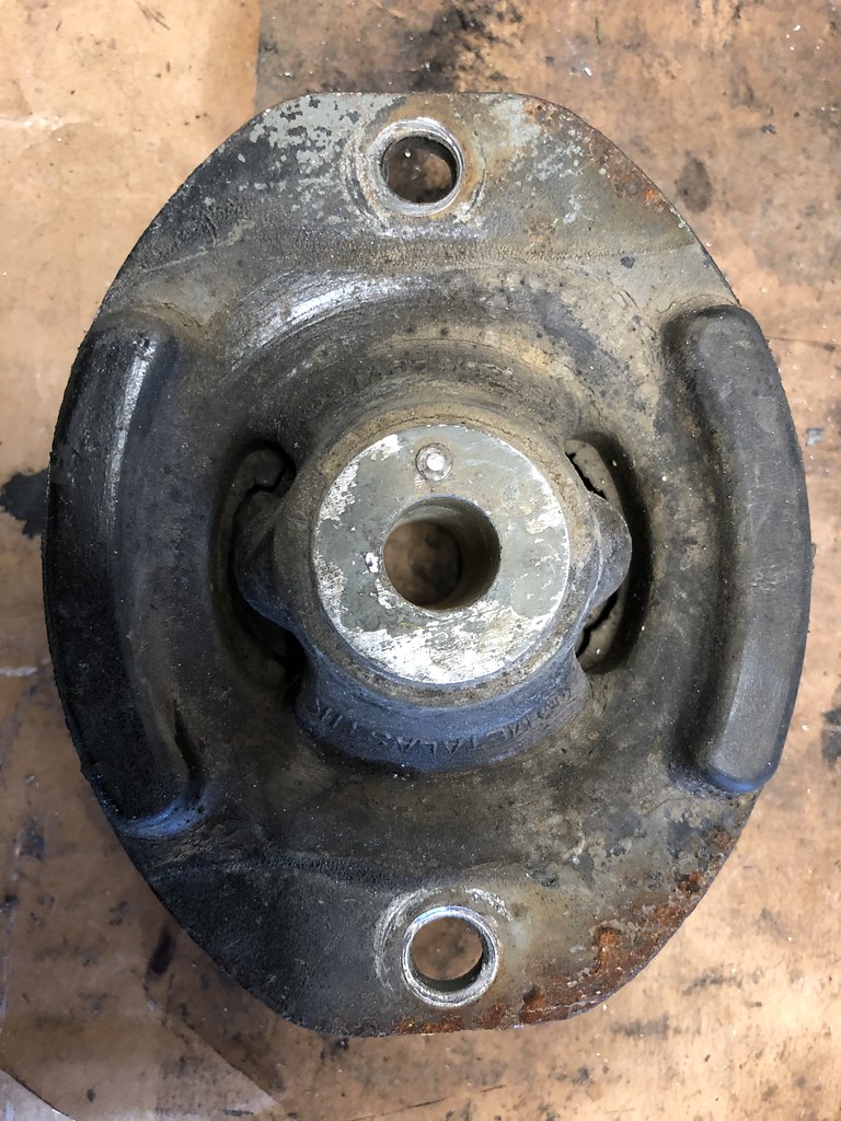

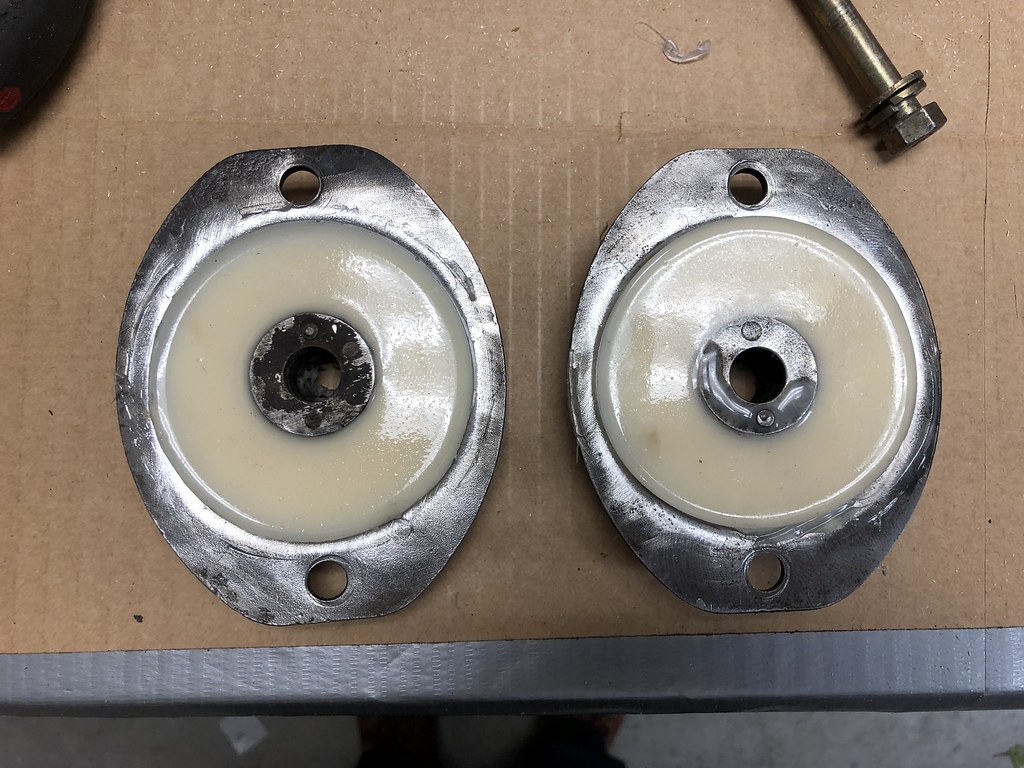

I decided to take a shot at some DIY urethane motor mounts. The stock STI mounts keep the engine a few inches higher on the cradle so the oil pan doesn't hang down too low. I have plenty of clearance on the top of the motor.
I started by taking the cracked and brittle Porsche motor mounts and hit them with the torch to get the center bushing out. After a bit of cleanup and trimming:
(IMG:http://www.914world.com/bbs2/uploads_offsite/live.staticflickr.com-22225-1560178824.1.jpg)
Here's what I'm left with:
(IMG:http://www.914world.com/bbs2/uploads_offsite/live.staticflickr.com-22225-1560178826.2.jpg)
(IMG:http://www.914world.com/bbs2/uploads_offsite/live.staticflickr.com-22225-1560178826.3.jpg)
(IMG:http://www.914world.com/bbs2/uploads_offsite/live.staticflickr.com-22225-1560178826.4.jpg)
(IMG:http://www.914world.com/bbs2/uploads_offsite/live.staticflickr.com-22225-1560178827.5.jpg)
They sell a coloring agent to make these more purdee, but I didn't want to pay the extra 20 bucks. I created a mold with some cardboard and aluminum tubing. The trick was getting a non binding agent like WD40 or candle wax (which is what I used) on the surfaces I didn't want this rubber to stick to. Hot glue was used to seal everything, and I poured the compound into the mold. 18 hours later, I'm left with this:
(IMG:http://www.914world.com/bbs2/uploads_offsite/live.staticflickr.com-22225-1560178827.6.jpg)
This stuff is solid - it feels almost like a skateboard wheel.
(IMG:http://www.914world.com/bbs2/uploads_offsite/live.staticflickr.com-22225-1560178827.7.jpg)
These are the perfect height now - kinda cool.

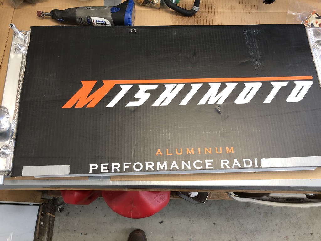

I also spent some time getting the radiator mocked in. I've got to do a bit of trimming to get the radiator inlet to clear some of the metal in the frunk - not a big deal. I picked up some rubber grommets on Amazon. My plan is to build some cribbing that holds the radiator with these upper and lower grommets, then I'll have something to rivet some aluminum sheeting to for ducting. I want to keep the radiator as far forward as possible, while allowing enough space for an A/C condenser and intercooler heat exchanger - and having enough space on the top so the hood can close.
(IMG:http://www.914world.com/bbs2/uploads_offsite/live.staticflickr.com-22225-1560178828.8.jpg)
(IMG:http://www.914world.com/bbs2/uploads_offsite/live.staticflickr.com-22225-1560178828.9.jpg)
(IMG:http://www.914world.com/bbs2/uploads_offsite/live.staticflickr.com-22225-1560178828.10.jpg)
