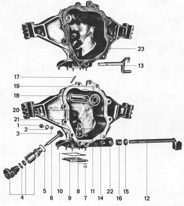

The tail cover is different and you can't use the -6 linkage if you have a -4 because of the engine mount bar.
This pic shows the -6 cover on top and the -4 cover on the bottom.
As mentioned above you can swap the covers.
