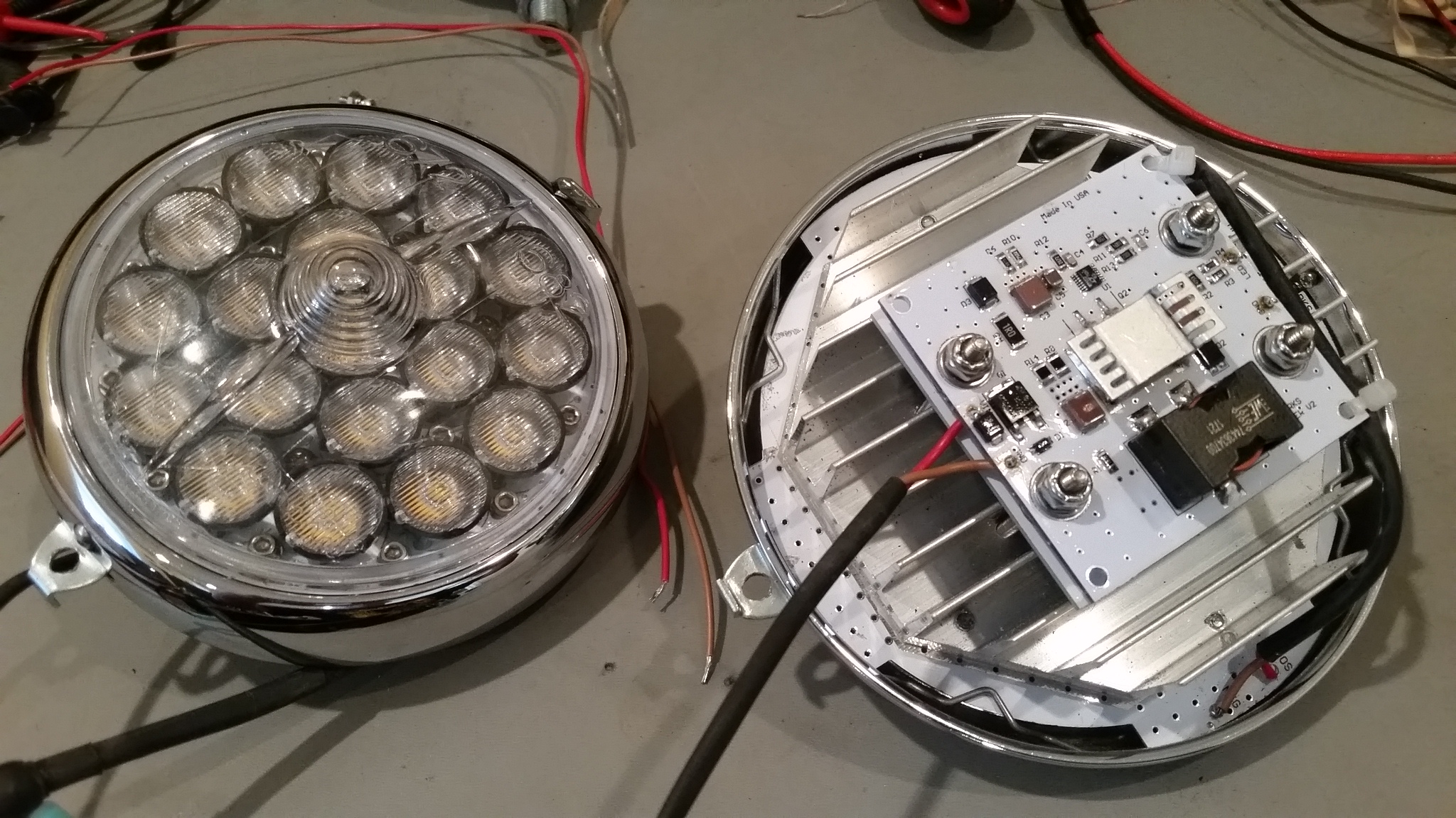

The LEDs will be connected in series and driven by a Linear Technologies LT3755 switching converter. It will be the same circuit as applied to the Porsche 356 running lights previously designed.
That running light had 19 LEDs running 275ma each. This one burned about 16W total. The switching converter was placed on a separate PCB as a large heatsink was mounted behind the LEDs.
The 914 foglight fixture is much smaller so only 8 LEDs will be mounted with the switching converter mounted on the backside of a single PCB.

This is what I did for the 356 running lights although the boost converter PCB was mounted inside the housing. I proposed a separate box to put the converter in but the owner didn't want an external box so I mounted on the back of the heatsink.
I'd like to keep it to one PCB for simplicity although a separate module may be needed depending on temperature rise.
