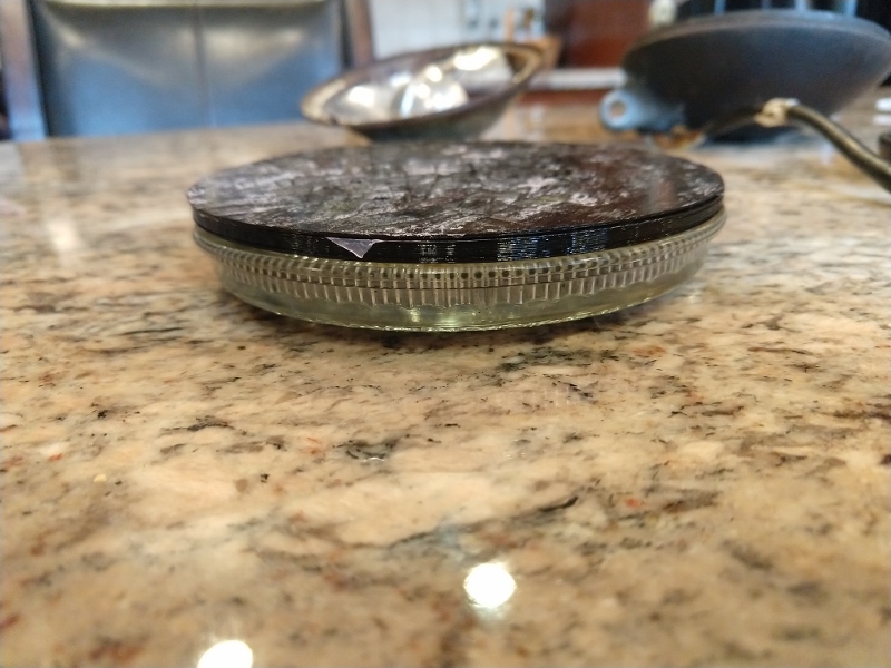

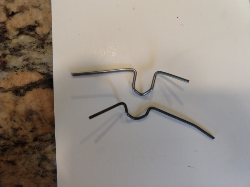

With the spacer attached, now the PCB can sit squarely on the glass.
Because the spacer and PCB thickness, the original clips which hold the original reflector are too short to hold the PCB in place. The top clip is a new one made from spring wire. It will be able to hold the spacer and PCB in place. This will put the PCB on the trim ring and will make it easy to install the entire assembly.
