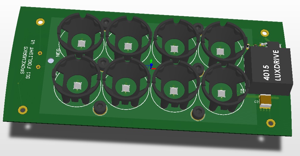

The design of an early foglight LED board has begun. mepstein sent me a couple of foglight fixtures to use to design the board. 2 main issues are fitment and heat dissipation. If things work out ok the design should be able to be re-laid out for the later square foglight.
The board will have 8 Cree XP-G3 high power surface mount LEDs with 350ma current each. These will burn about 1W of power with a total power dissipation expected to be less than 10W. Hopefully these will be almost as bright as a headlight.
Each LED will have its own focusing lens. The lenses are Carclo 10192 elliptical 20mm lenses. The light pattern for the 10192 lens is shown below.

I'm working on a 911 variant of the foglight like the 914 that I'm doing now. The 911 will use an LEDdynamics 4015 constant-current 350ma module. For the 911, I can't put any circuitry behind the PCB like the early 914 foglights.

Spoke   I'm working on a 911 variant of the foglight l...   May 9 2019, 07:12 PM
