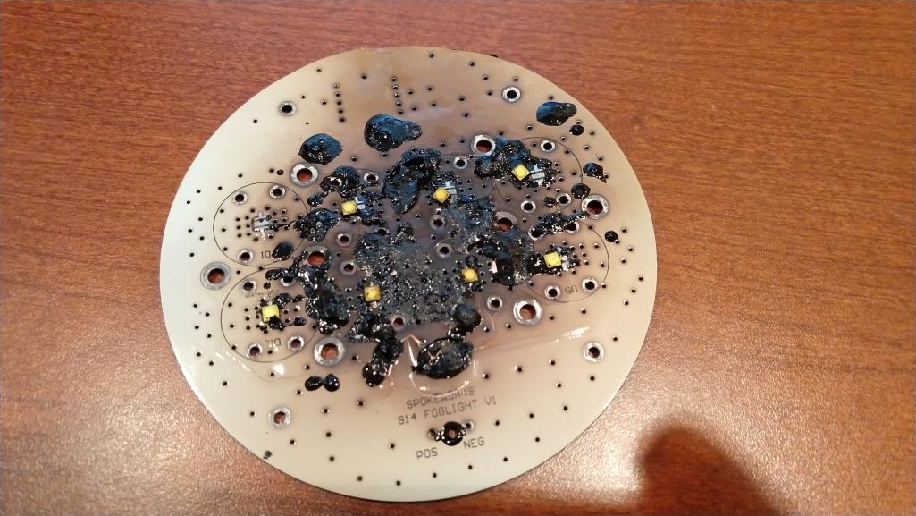

Things like this happen when you set the temperature profile wrong on the infrared oven.
@mepstein I have your foglight board. Not sure why it doesn't light up but I'm working on that. (IMG:style_emoticons/default/beerchug.gif)

Spoke   Things like this happen when you set the temperatu...   Apr 29 2019, 01:55 PM
mepstein   Things like this happen when you set the temperat...   Apr 29 2019, 02:14 PM
Spoke   With the correct settings, the oven worked fine. ...   Apr 29 2019, 03:06 PM
