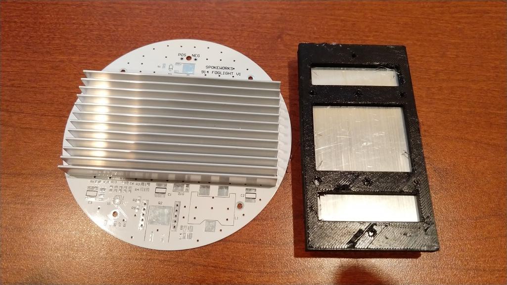

Spoke   This is the fixture I'll use to size the board...   Apr 14 2019, 06:09 AM
Spoke   I printed the PCB front and bottom sides since I c...   Apr 14 2019, 06:15 AM
Spoke   With the spacer attached, now the PCB can sit squa...   Apr 14 2019, 06:21 AM
