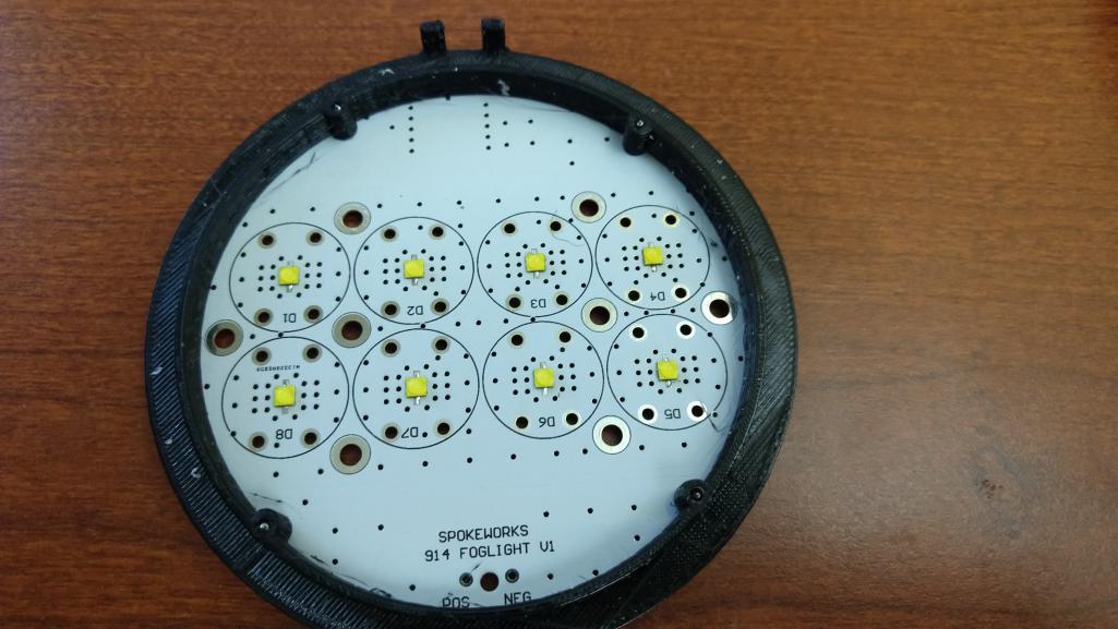

The design of an early foglight LED board has begun. mepstein sent me a couple of foglight fixtures to use to design the board. 2 main issues are fitment and heat dissipation. If things work out ok the design should be able to be re-laid out for the later square foglight.
The board will have 8 Cree XP-G3 high power surface mount LEDs with 350ma current each. These will burn about 1W of power with a total power dissipation expected to be less than 10W. Hopefully these will be almost as bright as a headlight.
Each LED will have its own focusing lens. The lenses are Carclo 10192 elliptical 20mm lenses. The light pattern for the 10192 lens is shown below.

Redesigned the spacer rings so the boards can screw into them. This is how they will be assembled.

Spoke   This is what the board looks like right now. It ma...   Apr 13 2019, 08:58 AM

Spoke   This is the fixture I'll use to size the board...   Apr 14 2019, 06:09 AM
Spoke   I printed the PCB front and bottom sides since I c...   Apr 14 2019, 06:15 AM
Spoke   With the spacer attached, now the PCB can sit squa...   Apr 14 2019, 06:21 AM

Spoke   Have the PCBs in hand. Will assemble the first boa...   Apr 26 2019, 08:01 AM
Spoke   Here's the PCB under the glass. It will be int...   Apr 26 2019, 08:03 AM

Spoke   With the correct settings, the oven worked fine. ...   Apr 29 2019, 03:06 PM
Spoke   All lit up with LED lenses. Won't be able to c...   Apr 29 2019, 03:10 PM
Spoke   Printed a jig to drill the heat sink for tapping. ...   Apr 29 2019, 03:13 PM

Spoke   The first fully built up PCB. Somehow I managed to...   Apr 30 2019, 04:10 AM
Spoke   Started doing some burn in on the first unit. Will...   Apr 30 2019, 04:15 AM
