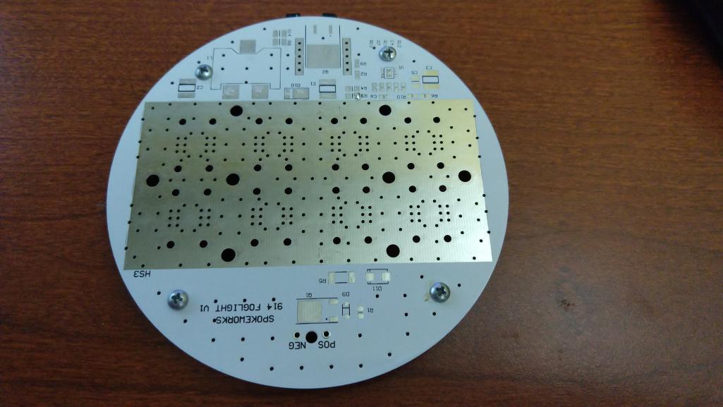

The design of an early foglight LED board has begun. mepstein sent me a couple of foglight fixtures to use to design the board. 2 main issues are fitment and heat dissipation. If things work out ok the design should be able to be re-laid out for the later square foglight.
The board will have 8 Cree XP-G3 high power surface mount LEDs with 350ma current each. These will burn about 1W of power with a total power dissipation expected to be less than 10W. Hopefully these will be almost as bright as a headlight.

Spoke   I printed the PCB front and bottom sides since I c...   Apr 14 2019, 06:15 AM
Spoke   With the spacer attached, now the PCB can sit squa...   Apr 14 2019, 06:21 AM

Spoke   Have the PCBs in hand. Will assemble the first boa...   Apr 26 2019, 08:01 AM
Spoke   Here's the PCB under the glass. It will be int...   Apr 26 2019, 08:03 AM
