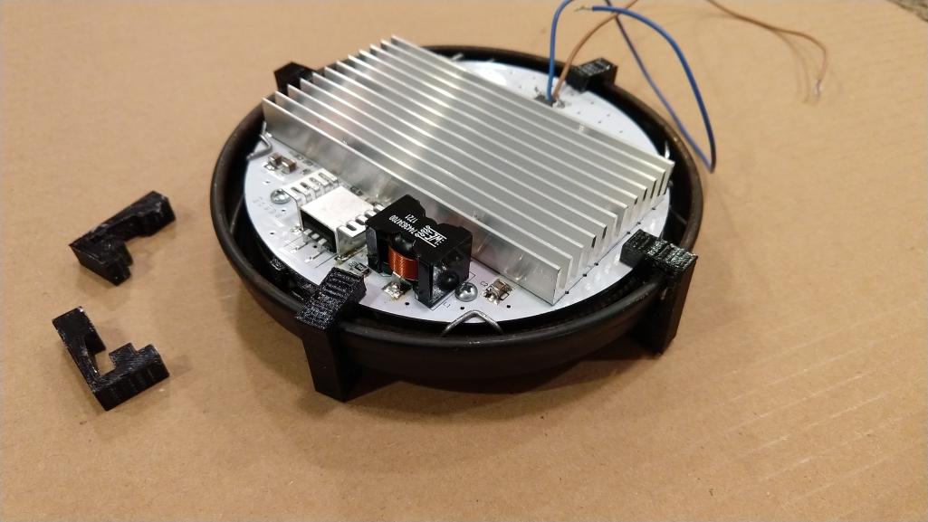

Burned in the prototype for about 20 hours this week. It still works so that's a good start. With little airflow, the PCB temperature was about 50C above ambient. It will be interesting to see what the temperature rise is when operated in the case.
Put the LEDs in the case. To center the glass lens and LED board, some clips were printed to hold the board while the clips are installed.
