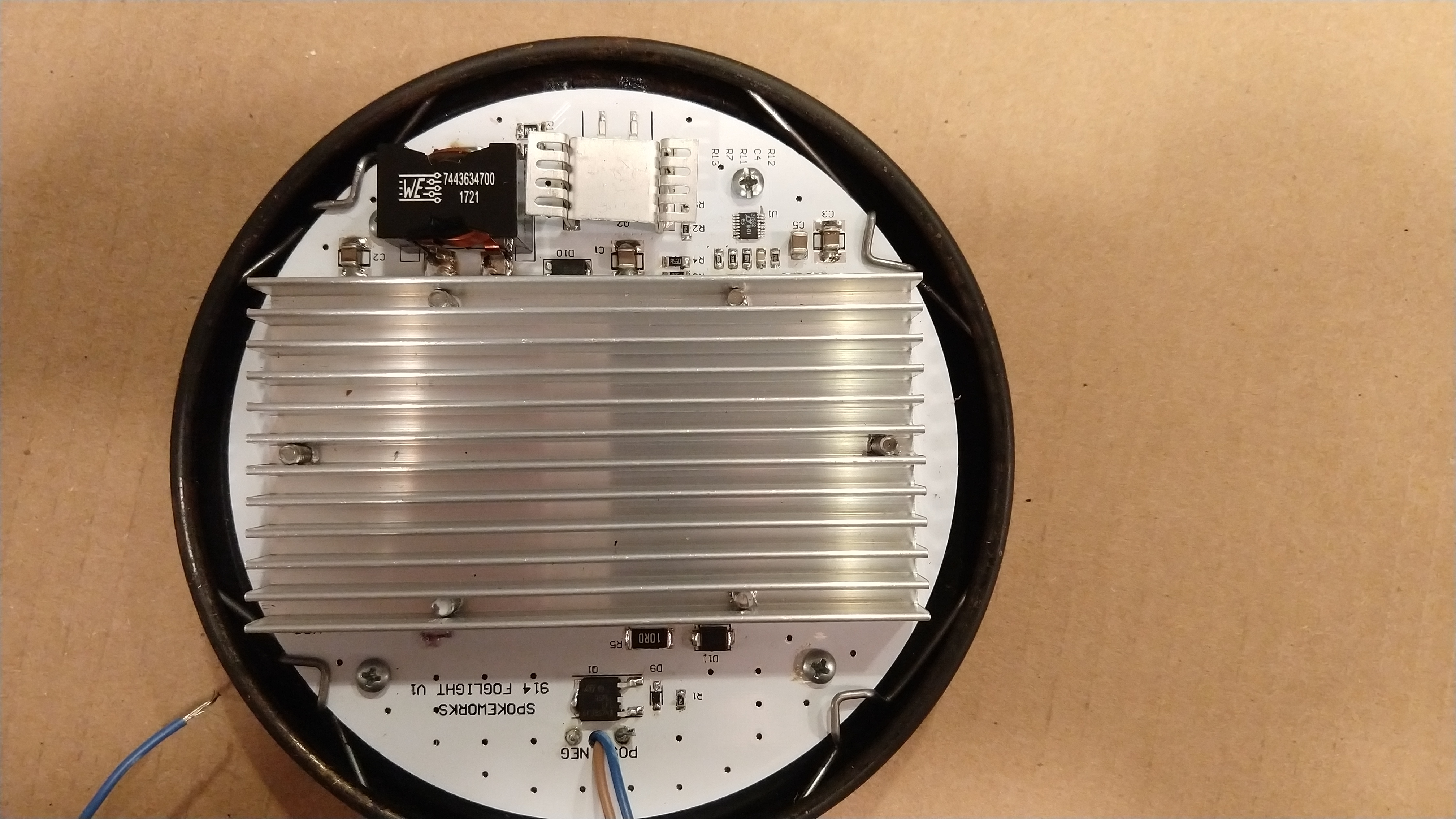

Spoke   The first fully built up PCB. Somehow I managed to...   Apr 30 2019, 04:10 AM
Spoke   Started doing some burn in on the first unit. Will...   Apr 30 2019, 04:15 AM

Spoke   Burned in the prototype for about 20 hours this we...   May 3 2019, 07:59 PM
Spoke   The metal clips will need to be made for each unit...   May 3 2019, 08:01 PM
Spoke   The PCB fits nicely in the case. Will run this for...   May 3 2019, 08:04 PM
Spoke   Not sure how to connect up to the existing wires y...   May 3 2019, 08:07 PM
