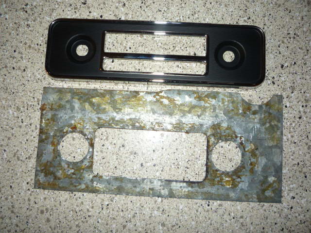

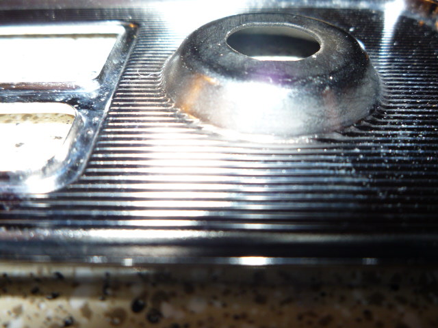

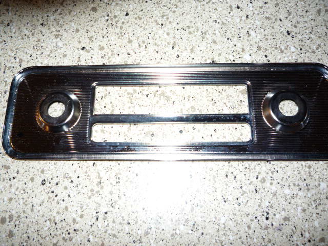

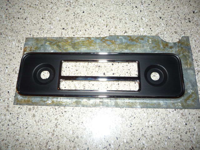

Just thought I would pass this along. Have a some more radio stuff to get rid of. Showing what Blaupunkt plate goes with the correct factory dash plate. This face plate is the only one that fits the large hole dash pate. This plate was used on the 69-73 Frankfurt. So unless you have one of these radios you do not need large hole dash plate. As sidebar note the late VW Emden radios (made by both Blaupunkt and Grundig) will also use large hole dash plate for mounting. Blaupunkt radio face plates have a blue dot in the corner so you know they are original.
